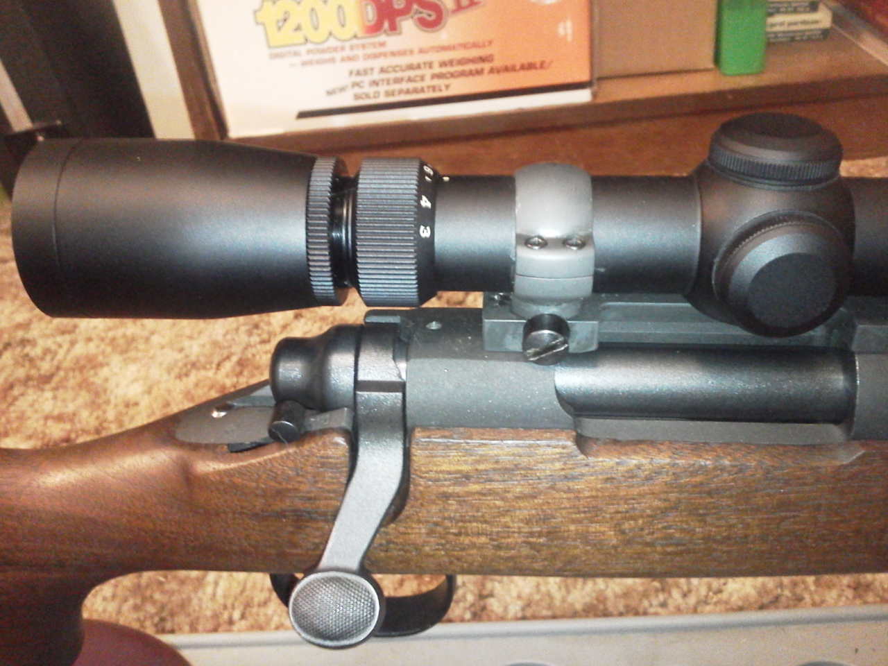

Well, it at least looks like a rifle now. I'm going to start on the BLO tonight and continue the search for a front swivel.

Do you need a threaded front swivel or wood screw? I think I have a spare 513T that I ordered from Numrich. Since I got that genuine M40 stock, I wont need that swivel anymore.
Rifle looks good!
Rifle looks good!
I've got the 513T wood screw. I'm looking for the threaded front screw. I think I've got a source for one but they haven't gotten back to me yet. Plus, there is always the gun shows, maybe I'll get lucky one of these times. Patience certainly pays off!

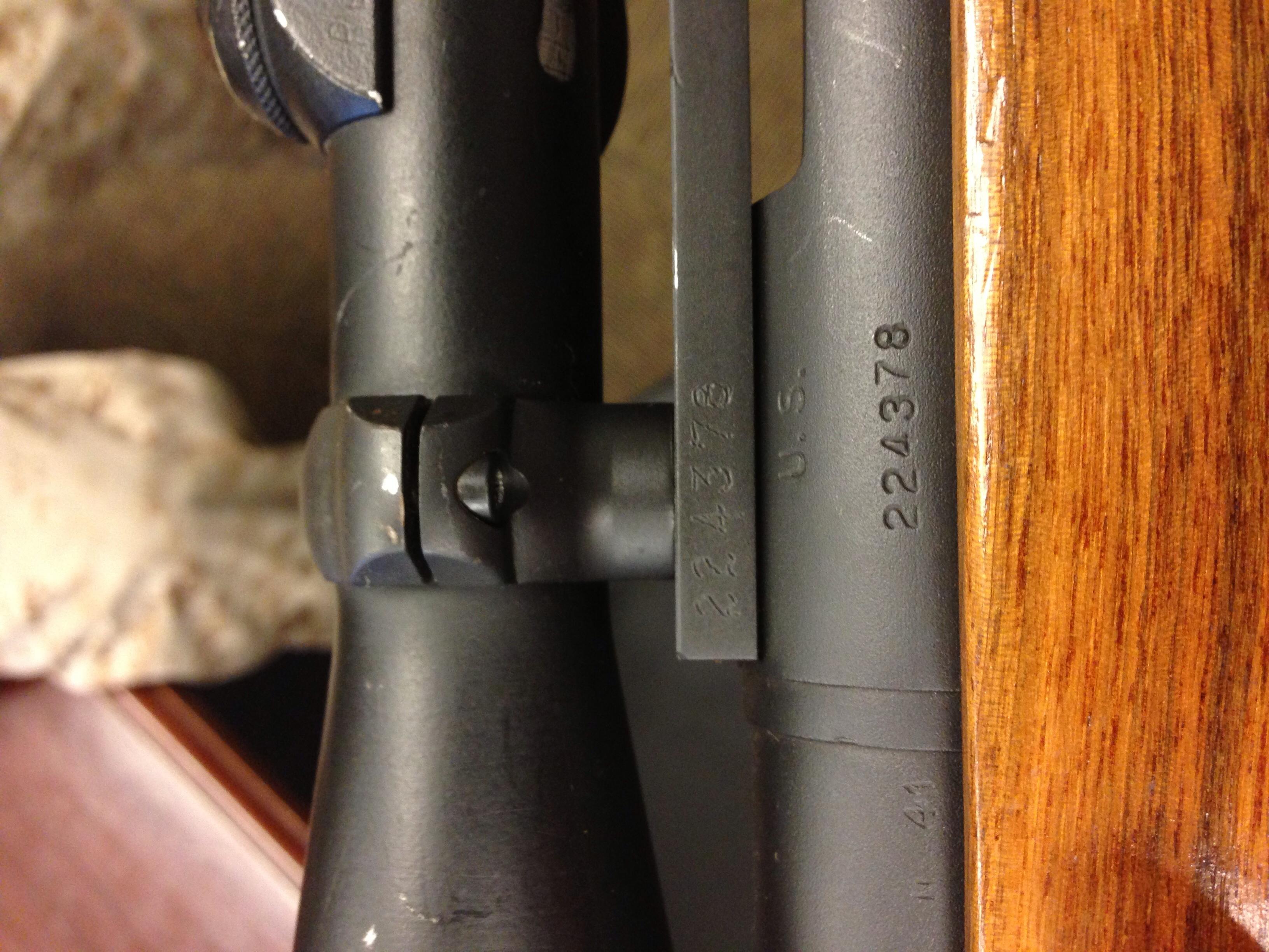

To be be fair, the number 1,000 is most definitely wrong, as the above photo, of SN. SSA1045, clearly demonstrates, BUT it is also THE number used in virtually every general reference and marketing/sales description of the Commemorative.

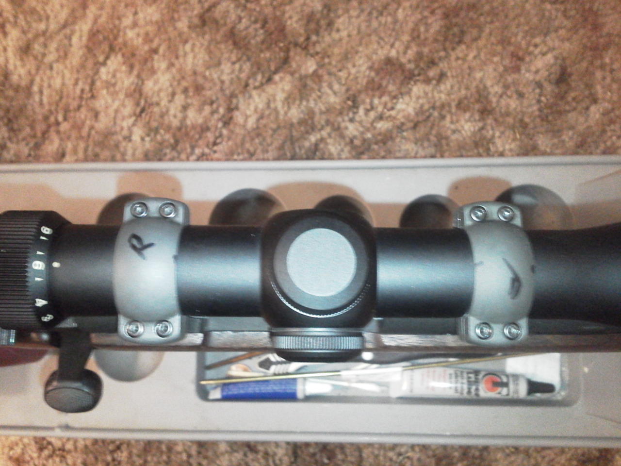

So, a Badger M40 mount box, as identified below, would be suitable for the SSA Commemorative?
How are the "Current Model" boxes identified? Anybody have one of these "Current Model" mounts and/or boxes that we could get a photo of?
Badger made Non Prefix and Prefix spec Mounts. You had to let them know what you wanted to insure you got the correct mount.
The originals were the non prefix six digit sn receivers, so for the spec tribute rifle guys, you needed the non prefix mount. All others the prefix mounts.
Yes, that is what I have mounted on the SSA. What you have pictured there. "Alpha/numeric S/N only" The older Redfield, long and short, bases fit it as well. I have mounted all three at different times. The rear has two holes for the mount. One for short base and one for long base.

For this threads 1000th post I present to you my commemorative M40. With the help of ya'll, this rifle was possible. Thanks a bunch! Can't wait to get it to the range.
