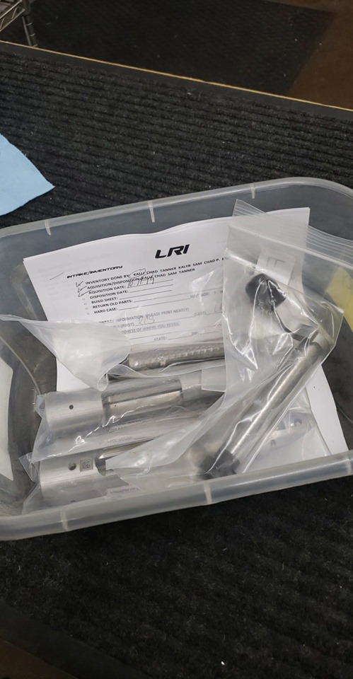

    1. Intake/Log in.

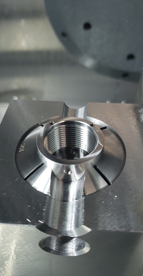

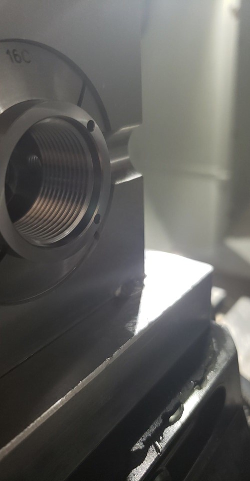

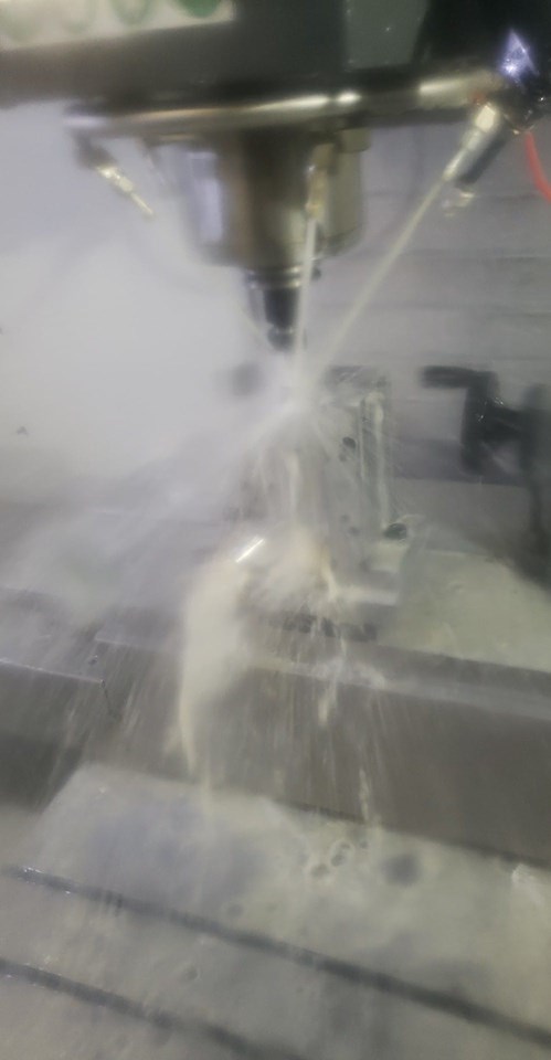

    2. Hone receiver:
    3. Setup and machine in 5 axis.
    3a. Machine ring face
    3b. ID bore
    3c. Thread mill to 1.085-16
    3d. Chamfer ring face
    3e. Higbee cut lead thread
    3f. Drill for pinned recoil lug
    3g. ID bore base holes for 8-40's
    3h. ID thread mill base holes to 8-40

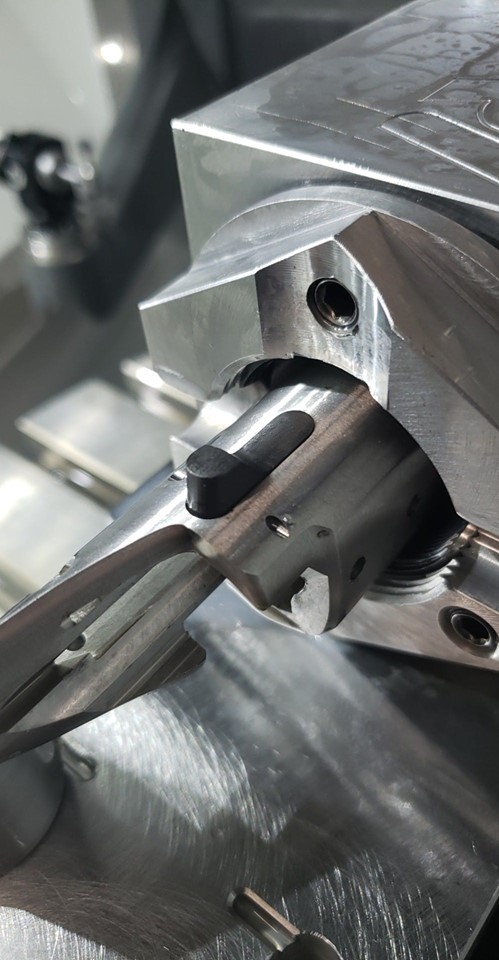

    3i. Machine for Side Bolt Release

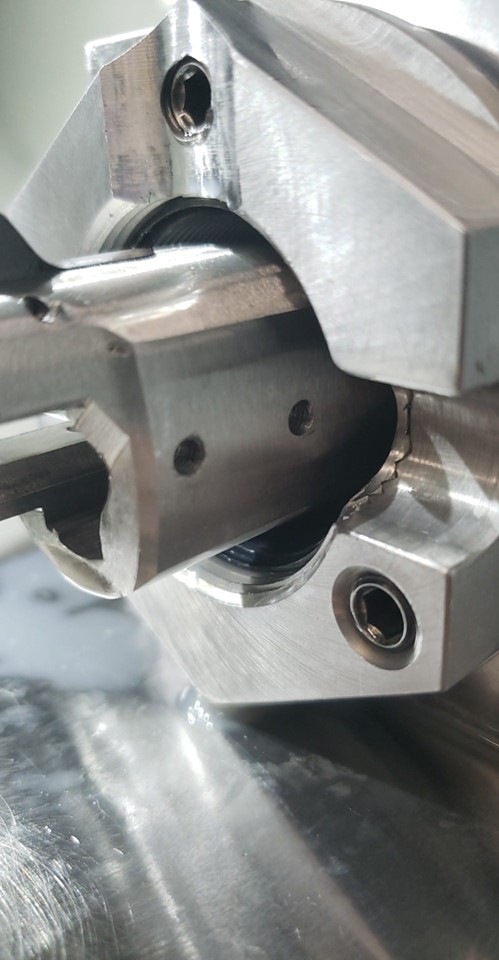

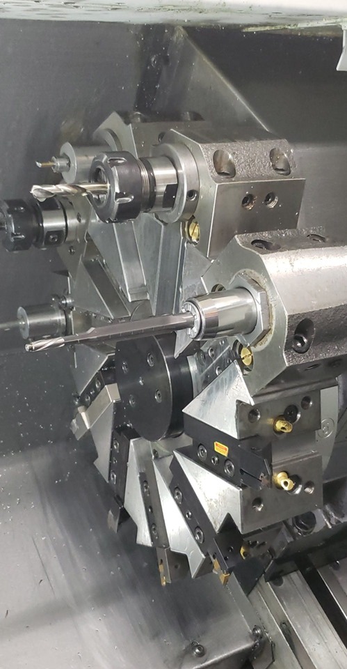

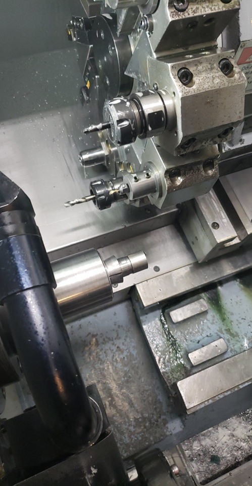

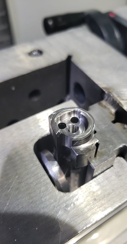

    Simultaneous to this being done:

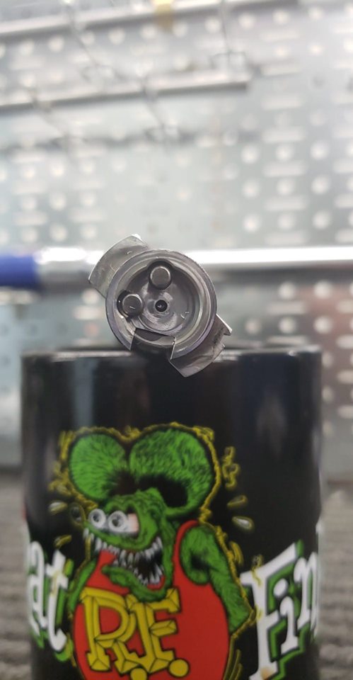

    4. Blueprint bolt head
    4a. Probe and square the face
    4b. Square the lugs
    4c. Square the nose
    4d. ID thread mill bolt nose for M16xtr bushing
    4e. Thread on bushing and solder
    4f. Finish machine bolt nose/bushing
    4g. Drill for 2nd ejector pin
    4h. Machine for M16 Xtr slot
    4i. Machine for striker bushing installation
    4j. Turn striker pin to .0625"

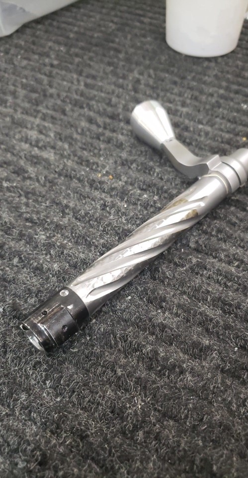

    4k. Flute bolt body
    STRIKER BUSHING INSTALL.jpgM16_2X EJECT COMPLETED.jpgBOLT LUGS COMPLETE.jpgTHREAD MILLED STRIKER PIN HOLE.jpg
    Next page/post (whatever, lol)

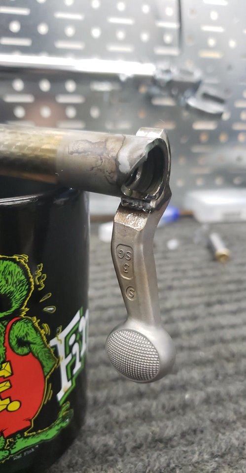

    Bolt fluting and tac knob install.
    Still part of #4.

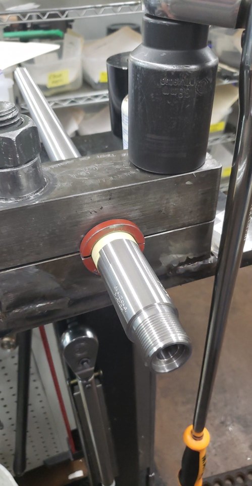

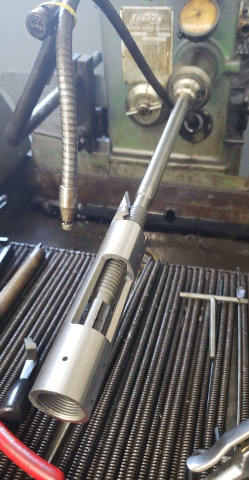

    Now, barrel work. Documentation is key.

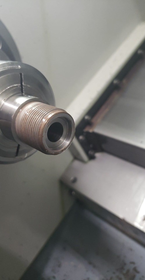

    Setup.
    Time_Tig_solder during lathe setup.
    Thread fit 100%
    Breech and chamber 100%

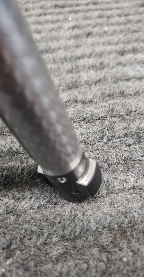

    Front end work, Thread Protector fitup.

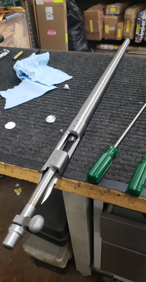

    Assemble to check function and for test fire prior to final finishing.
    Engrave, spin polished, and ready for final assembly:
