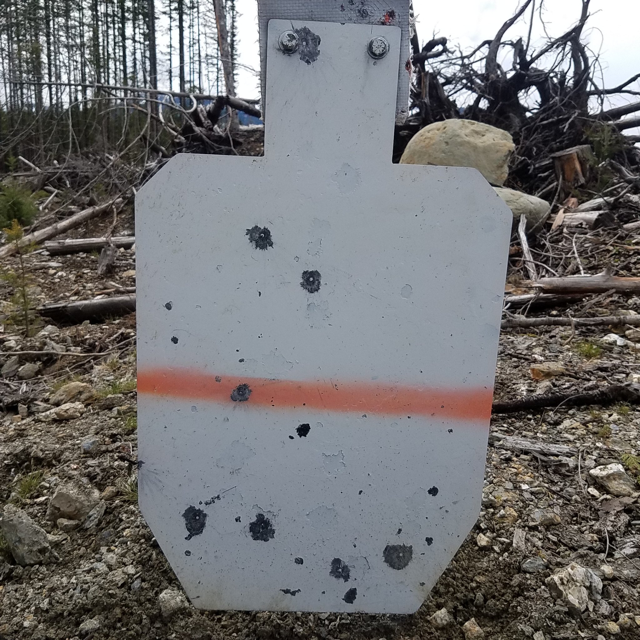

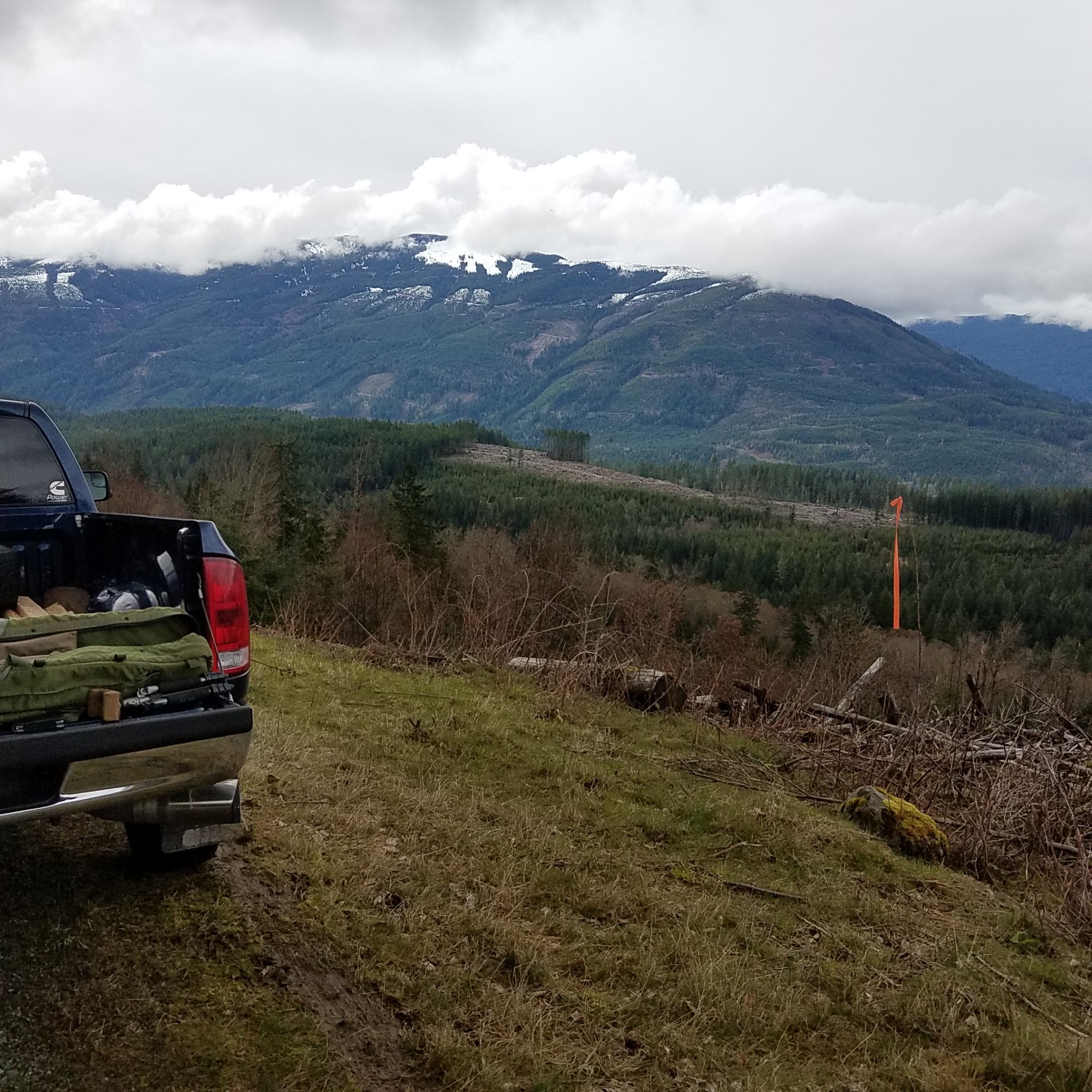

I had another perfect morning to shoot again so I set up at the exact same spot for another go @ 1713yd. I ran my buddies Magnetospeed & at the same time shot across my old Shooting Chrony.
Well with a 0 wind hold I fired 10 rnds which included my CCB shot. Both chronographs showed all following shots to be in the 2830's. However AB was right on after last time truing with 6 consecutive hits on tgt. But it corrected my MV to 2873fps.
Conditions were:
Temp 39*
Press 27.69"
RH 88%
1713yd at -5* declination
Very light winds of 1-2mph from 270*
60.5moa hit about shoulder high from center. 60.25moa hit in a line about belly button high. Not sure why the large change but I've seen it many times before.
