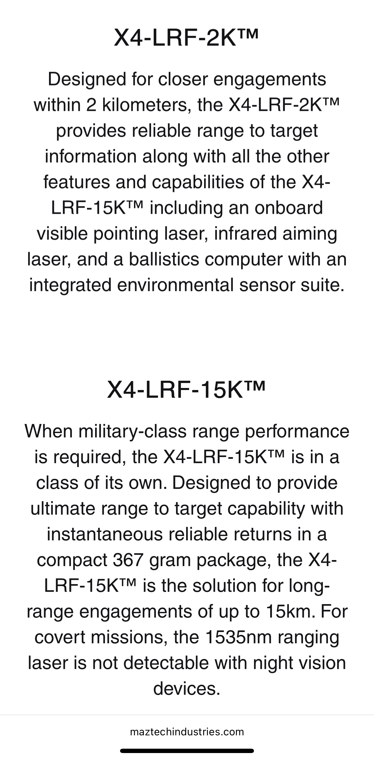

It’s a 905nm like all the other LRFsAnyone know what laser the 2k version has?
The website shows the 15k having a 1535nm. Originally I thought I saw the 15k having a 1550nm like @Teflon16 mentioned above.
The original stated specs were ~1535nm for both 2k and 5k..I just checked the Maz site and they indeed changed a lot in the specs info and the 2k spec is 905nm .. GAYIt’s a 905nm like all the other LRFs
That was likely a typo, I don’t think they make the ~1550nm cheap enough to get it into that 2k price range. Otherwise we’d see them a lot moreThe original stated specs were ~1535nm for both 2k and 5k..I just checked the Maz site and they indeed changed a lot in the specs info and the 2k spec is 905nm .. GAY
