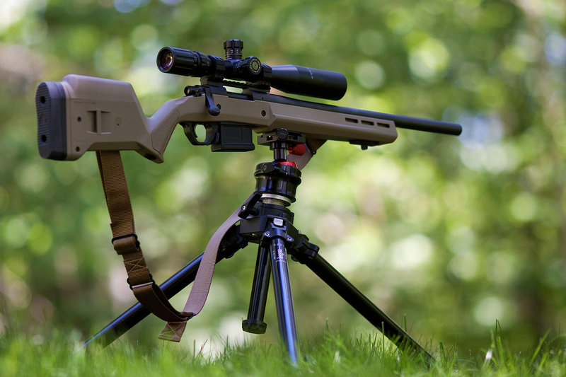

How would you rate the quality of the Magpul Hunter 700 Stock? If put a 700 action with a quality barrel in the Hunter 700 Stock, would you be able to achieve the accuracy compared to if you used a McMillan stock or a chassis?
Quality wise it is awesome over a hogue and I prefer it over the HS precision as well. The standard comb provides me with just the right scope height using a 20moa rail and .93" high rings.
I tested it against my manners with mini chassis and it was just as accurate. My only complaint is the grip is a little thin for my liking.
The magpul stock has a generous barrel channel and my 700 with proof sendero (m24) contour barrel free floats just fine.
I could not see any difference in accuracy when I tried the Magpul hunter 700 instead of the Mcmillan A5 I was running at the time. I do prefer a steeper grip angle and I found a great deal on an McMillan A3-5 so I ended up getting rid of the Magpul after a few months.
I had a really hard time deciding between the Magpul Hunter stock and the Grayboe Renegade. Ultimately the main reason was how short the aluminum block in the Magpul stock is. In hindsight, it would have been a lot cheaper and I'd like have a lighter rifle if I opted for the Magpul. Not to mention, I have yet to hear anything bad about it.
I have the Grayboe Renegade. I am going to need to attach an aftermarket cheek riser for a good cheek weld, which means I will need to drill holes in the stock. I want qd flush cups for sling attachment. I paid extra for bottom metal. The Magpul would have definitely been less expensive and easier. Now that I am here I don't know if I should proceed with the upgrades to the Renegade or get the Magpul and sell the Renegade.
The only complaint I had with the Hunter stock is the .25 cheek riser. It was too high. This weekend I discovered Magpul makes a "No-Rise Cheek Piece" for the Hunter. I ordered it. Will be looking for it next week.
