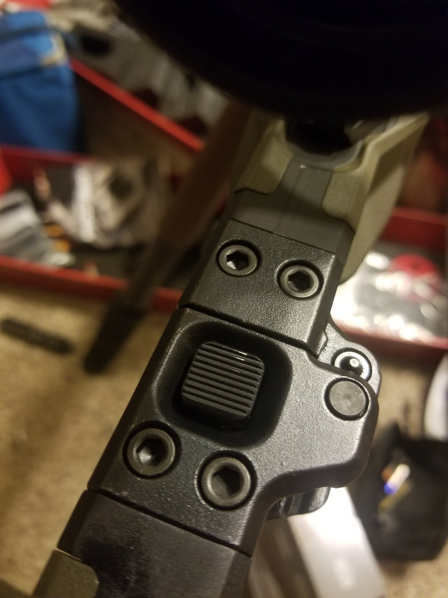

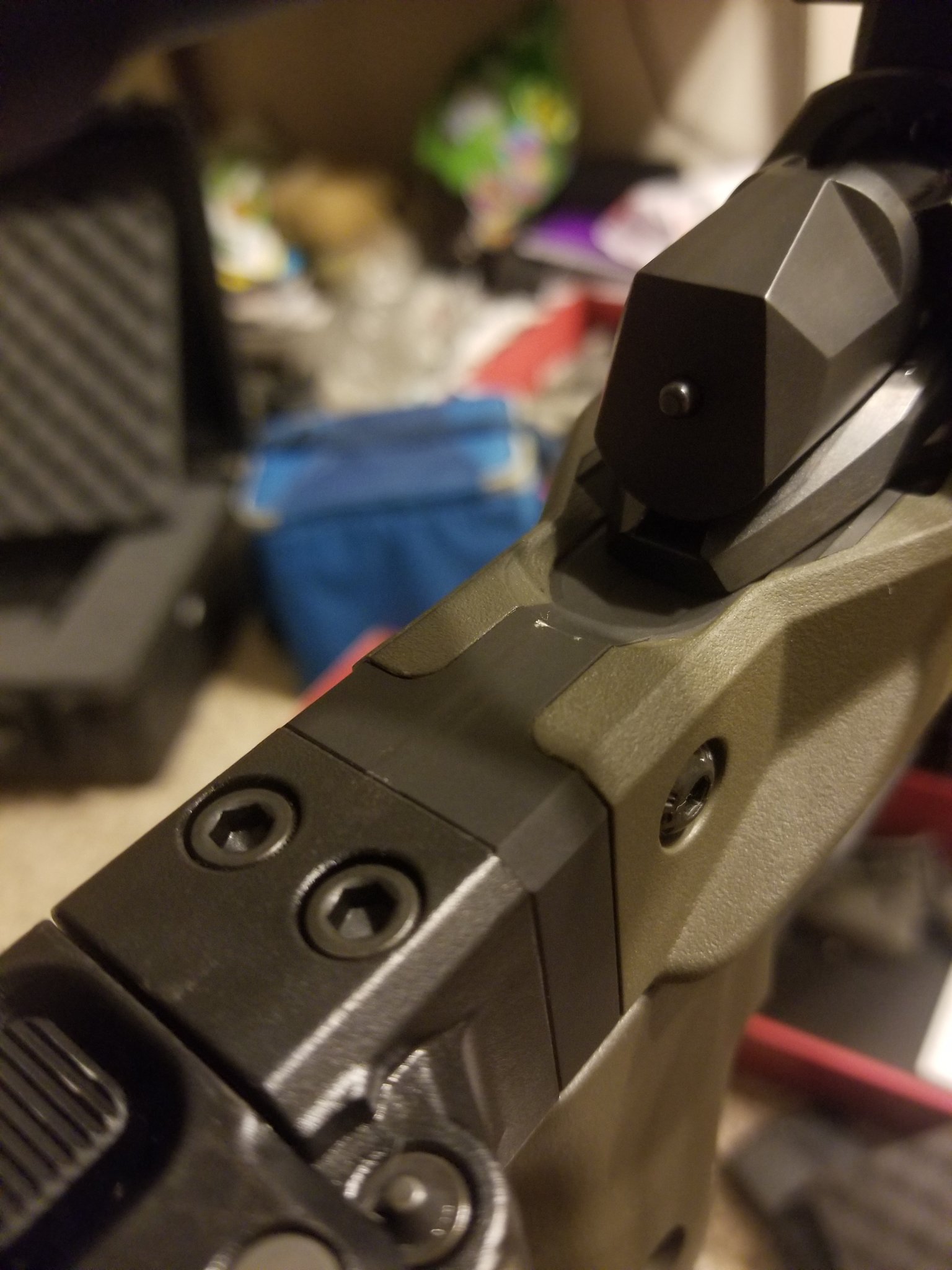

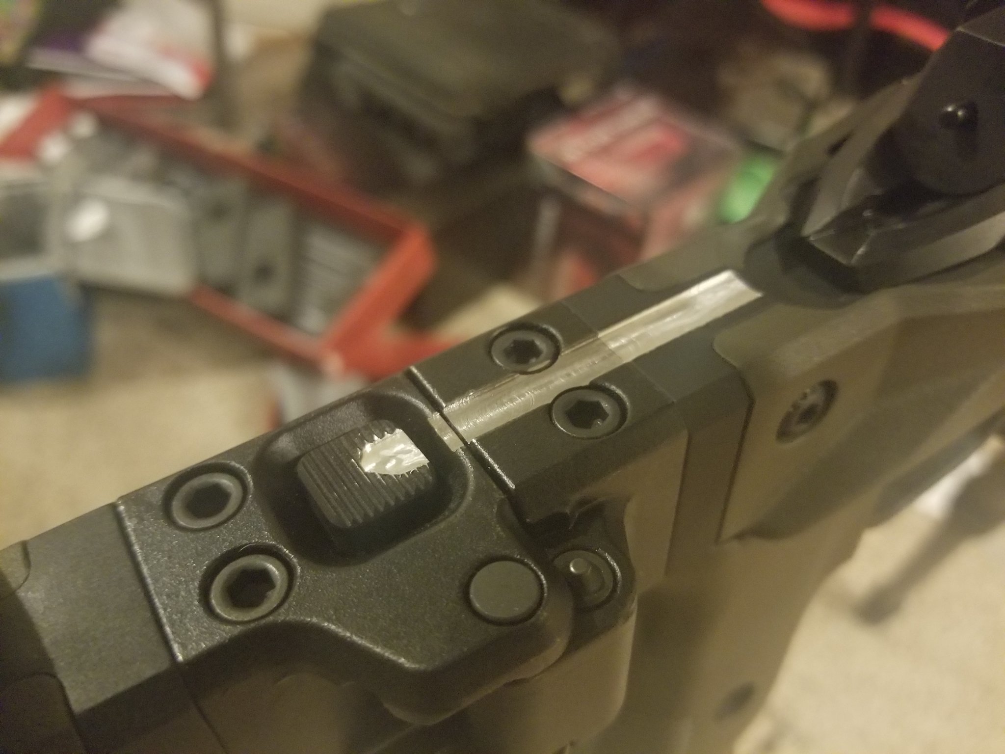

So when I tq the action down it rubs slightly. I'm going to take the chassis to work and mill out a few thousandths and see what we have. I can still run the bolt but its dragging and I'm sure it's not good for the cocking sear. Will update tomorrow. But other than that it looks awesome. Mag latch needs about .01 taken off to seat aw mags. I'll do that at work too
So dealing with the ultimatum. 3/16 bit at about. 02 deep took care of the cocking sear dragging. Next came the mag catch. Absolutely a pain in the ass. I couldn't get the pin in mine to budge so I hit it with a dremel from the top. It worked and my aw mag latches and has wiggle room and drops free. Next a part where they said may be a problem was the trigger hanger itself. Barely made contact and left some rub Mark's so I did some light dremel work and bam. So all in all not bad but requires some work which I was aware of going in.
