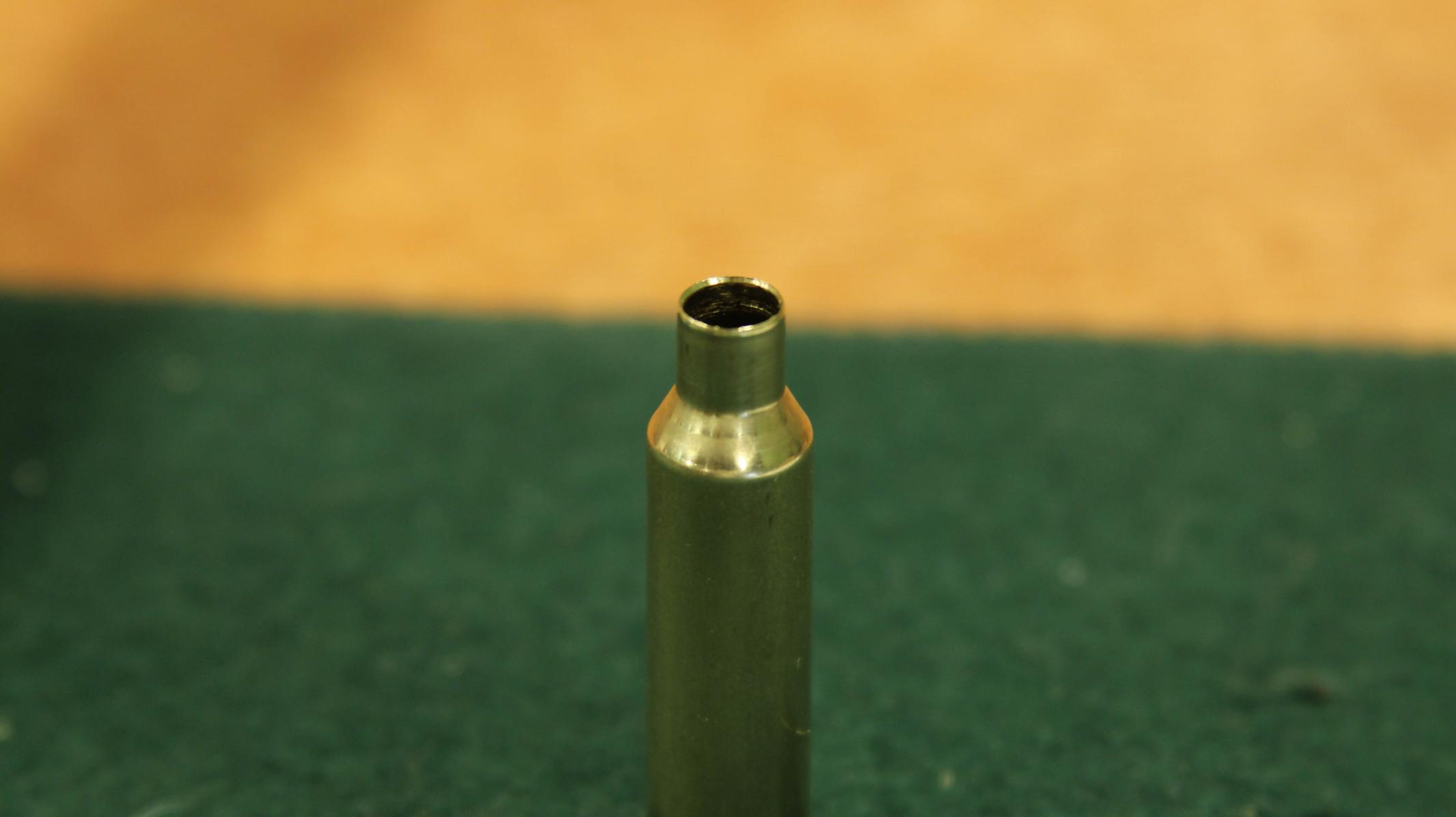

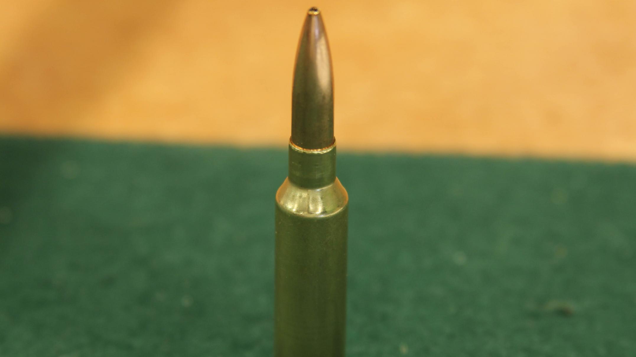

    I was fooling around to day and made a few pieces of 6.5 CM brass from 3.08 1X fired brass. I was wondering if anyone else had done this with any success.
    Thought it was a cool thing to do.
    Any ideas or comments are welcome.
    I did get some very small wrinkles in the shoulder. would this fire form out and be ok?

    I've done it using Fed .308 brass. I had to turn the necks though which makes it more work than it's worth to me. I'll stick with the Hornady Creedmoor brass as it's held up very well for me. I do like the idea of doing your own though as a back up option.
    I make it with Hornady .308 match brass from once fired TAP. I have to neck turn but it is extremely accurate. The wrinkles are from too much lube but they will fireform out fine.
