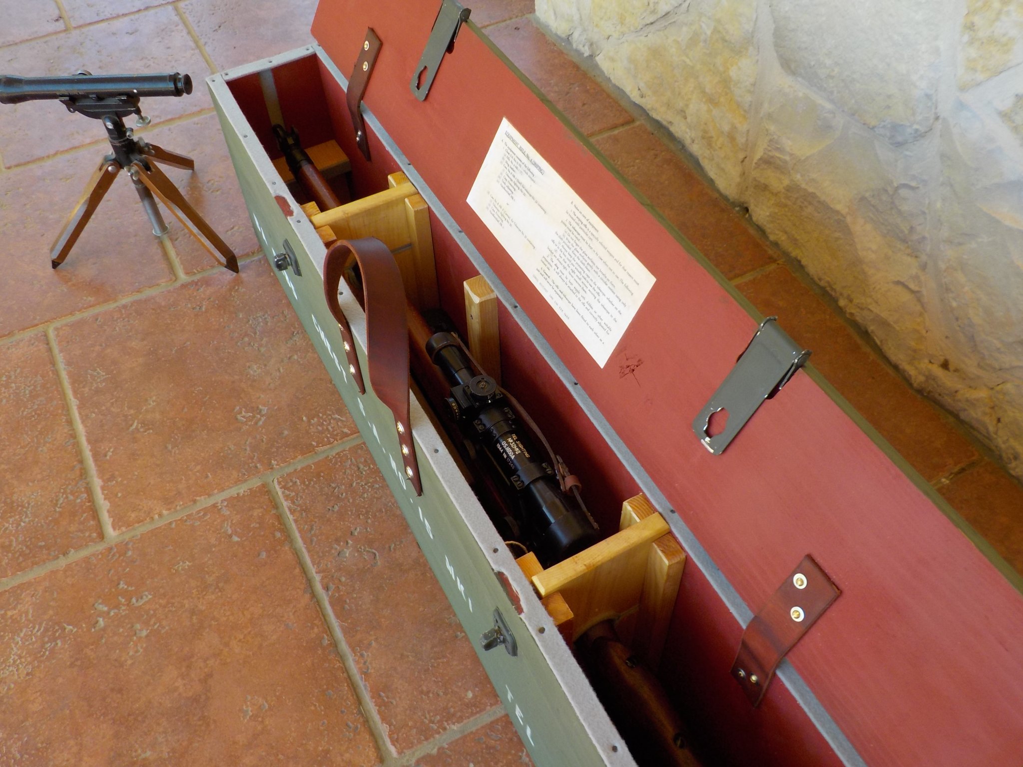

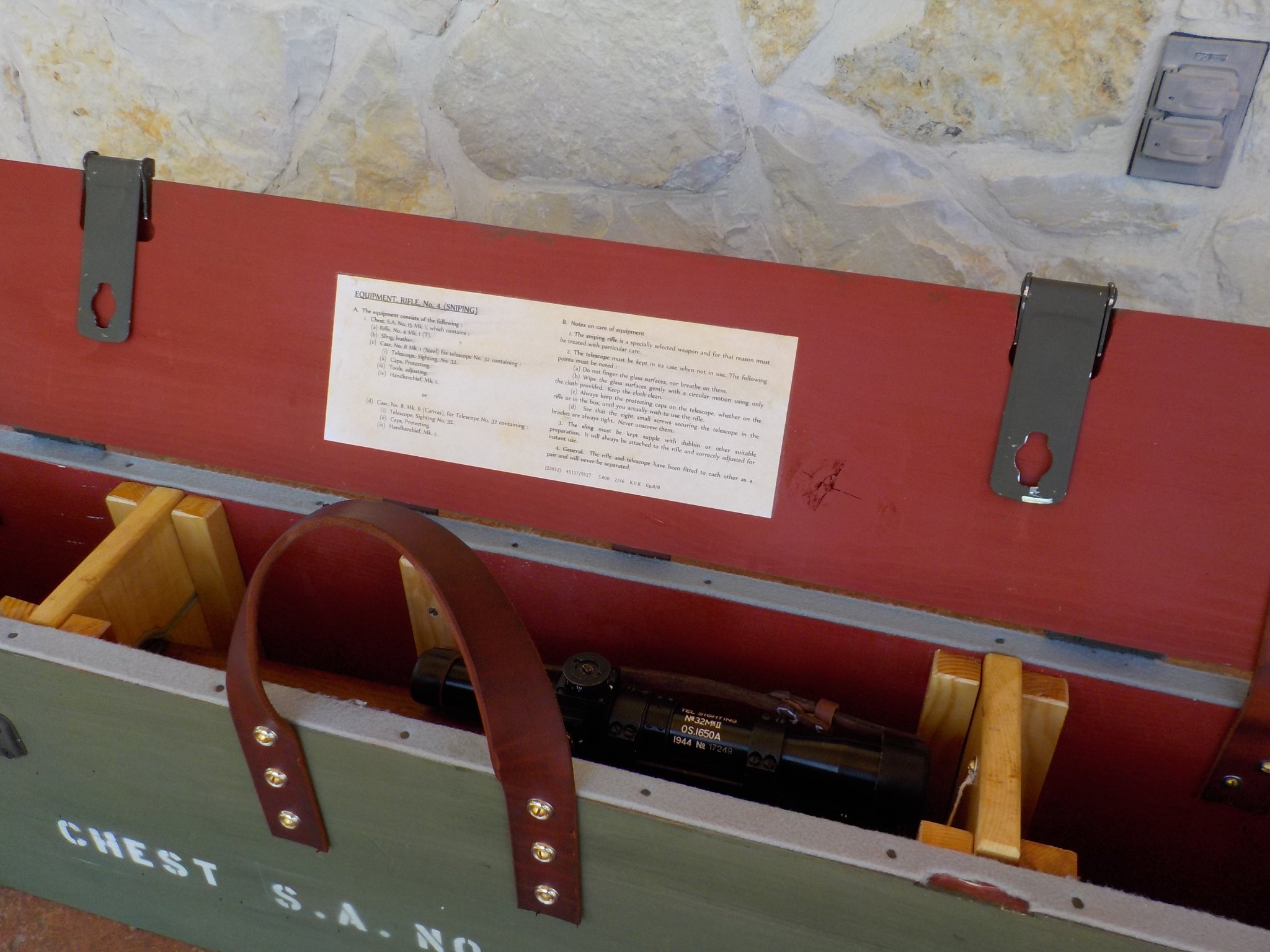

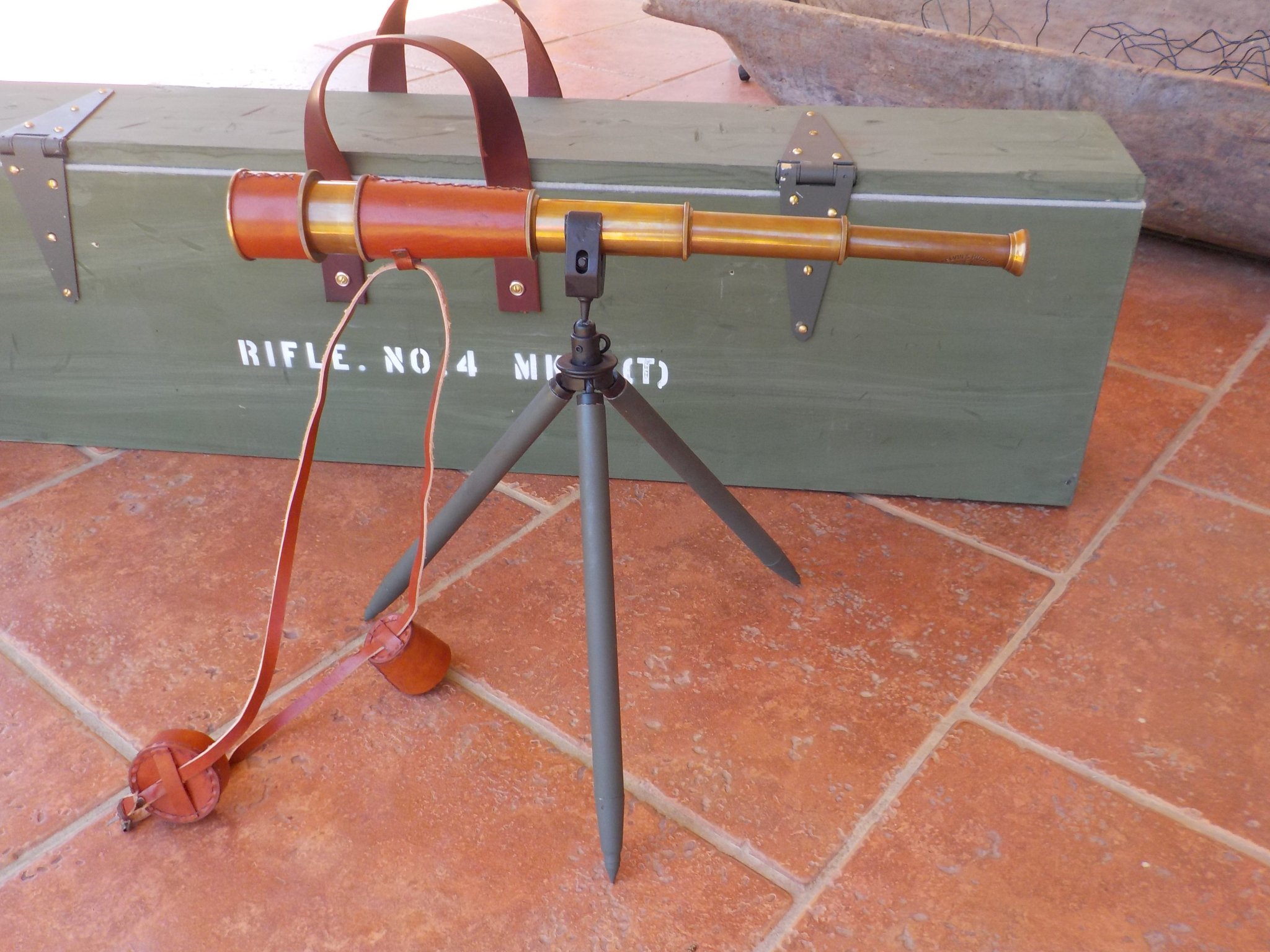

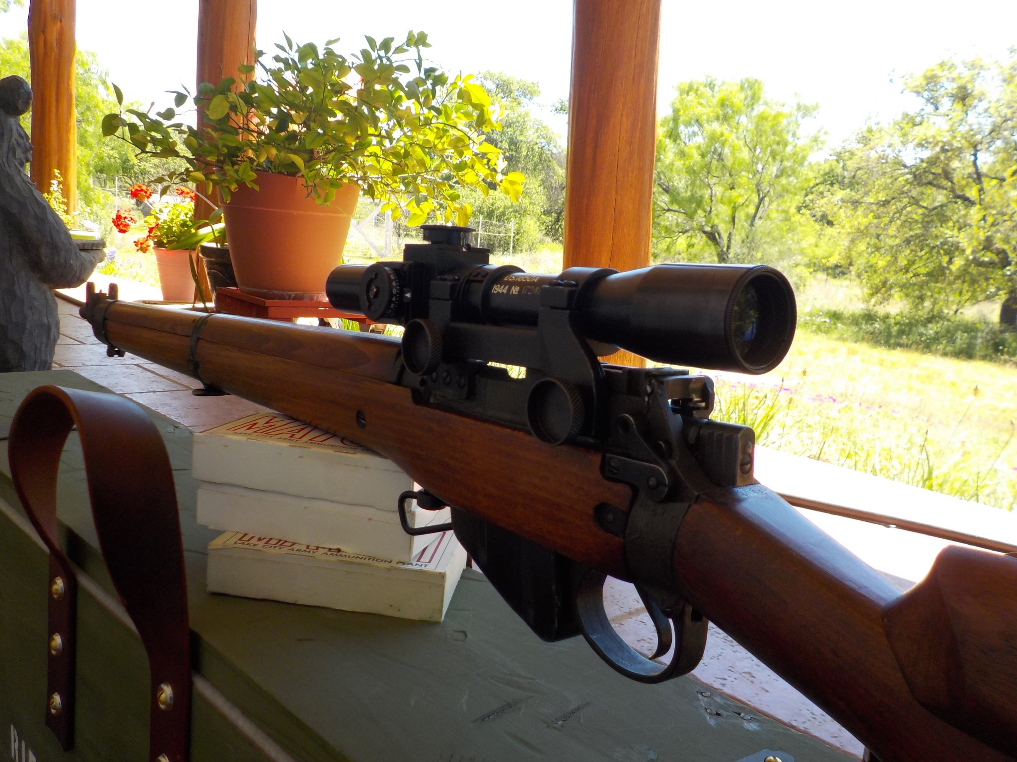

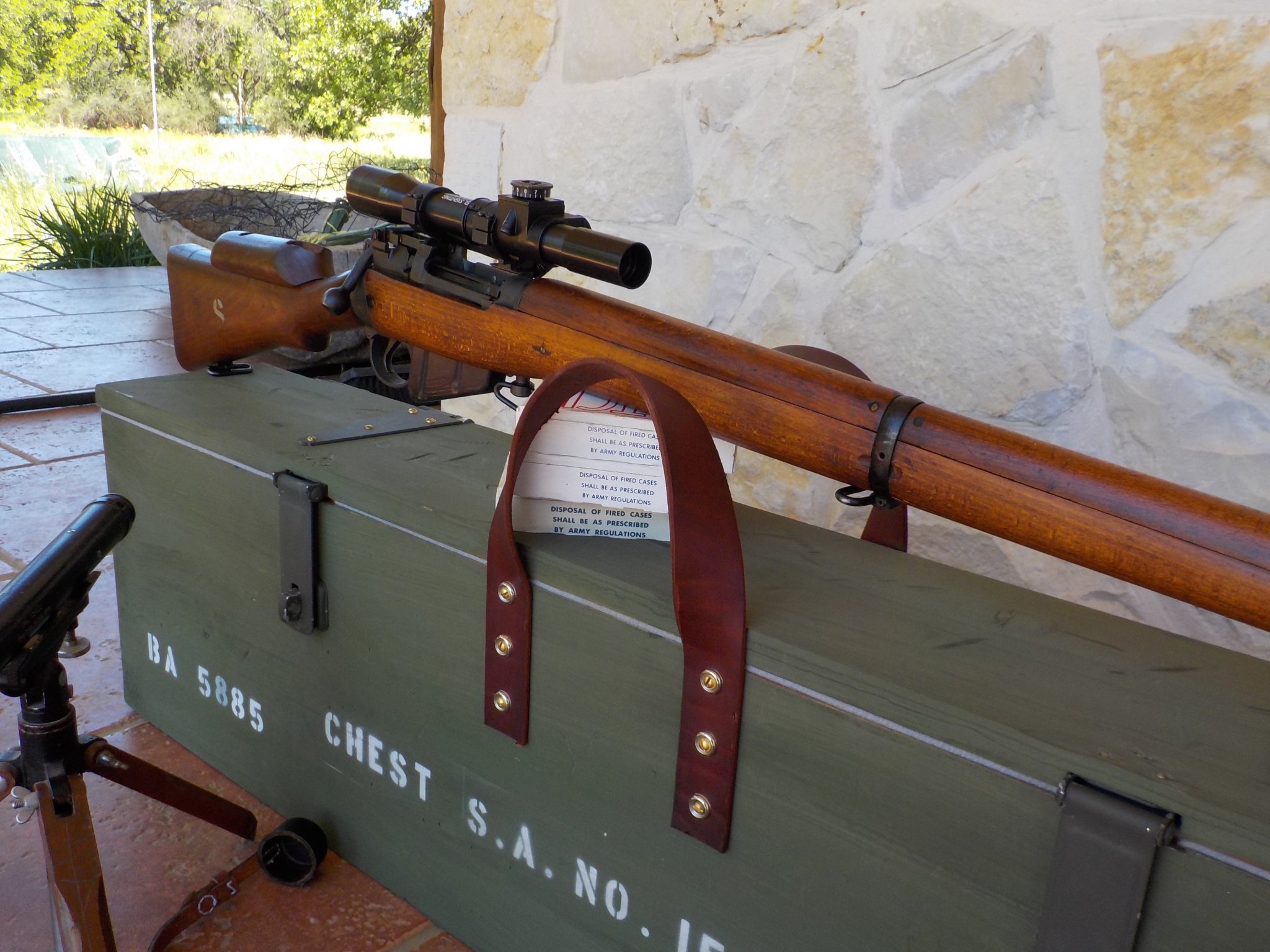

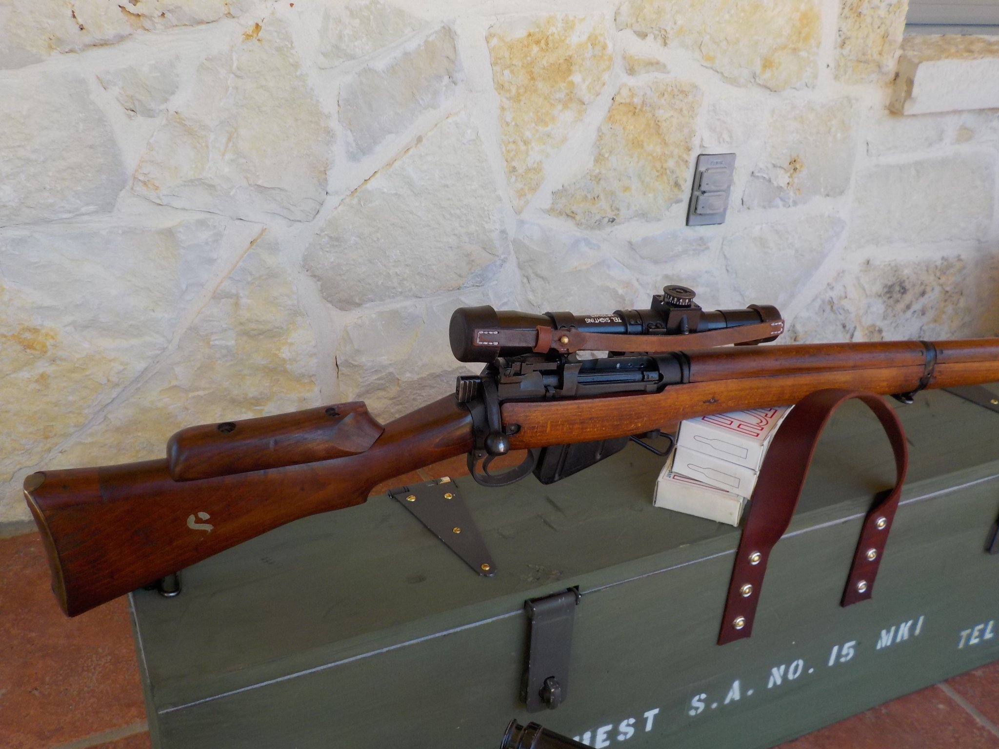

The 32 repro is nice. Here's mine, complete with transport case that i built. Mounting the scope is a bit of a chore.
That's a pretty rifle, is that the numrich repro? I've heard it can be a pain to zero those scopes how difficult was it to zero? And I'll likely get a mount that mounts using the extractor screw and the rear sight holes.
All the repro scopes are the same, I believe this came from SARCO, but it might be from Numrich. They aren't hard to zero...they're just different. They adjust just like the Unertl Marine Corps sniper MST-100. You fire a shot, and then loosen the turrets, adjust the crosshairs to cover the shot using a tool, then tighten the turrets at the new zero. The tightened turrets then have a limited windage and elevation range. The trick is to correctly mount the scope so that the barrel collimates with the scope so that you have enough adjustment range. Here is an article on how to do it. http://www.rsmscope.com/report_pdf/m2.pdf Confusing unless you have the scope to look at. You don't need a tool, you can make do without one. I bought one afterwards just to complete my scope box. Buy the entire "mk 32 scope complete" and get the tool, carrying case, mount etc. It's worth it in the long run.

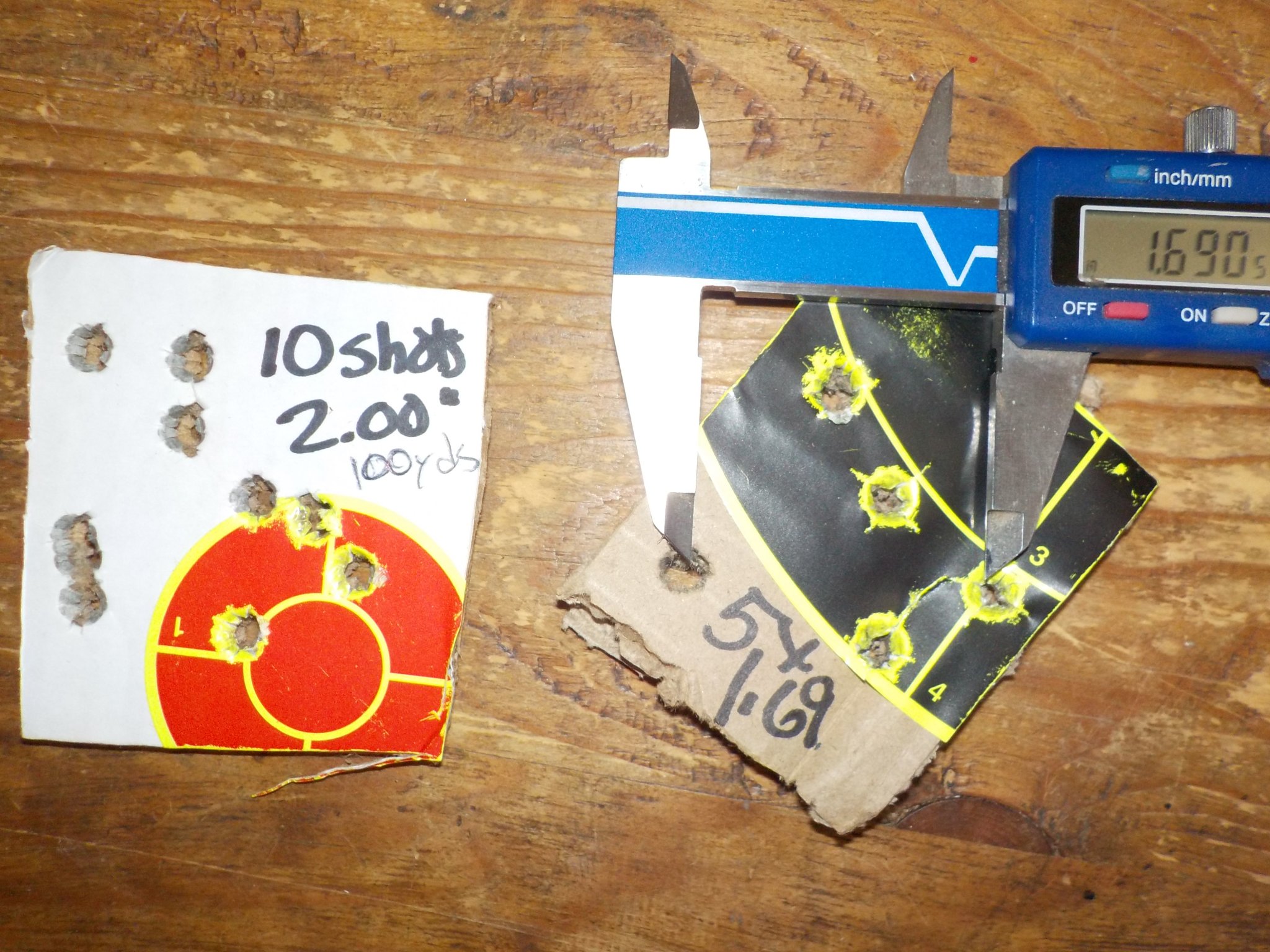

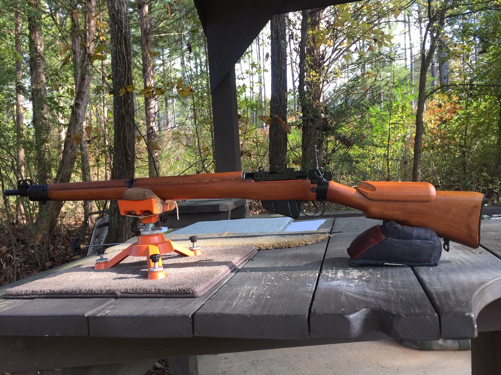

That's a beautiful setup you have there... My Faux-(T) I had built up from a salvaged receiver and a spare NOS stock I had sitting in the closet. Spent the money and got the right parts from Roger Payne and Fultons of Bisley in England. The pad and culminating work and rebarreling (with a Criterion) was done by Bruce Dow and it was restocked by Bruce Dick. It came out really nice and shoots about 2 MOA with Hornady Vintage. Once Spring hits I'm gonna start playing with loads to see what I can really get out of her.
Quick couple questions about the Numrich scope you have... I currently have a vintage K3 but would like to get a repro so it looks correct. Does it hold zero under normal range conditions? Also, I've heard the MkII repro scopes are 2 MOA per click as opposed to the correct 1 MOA per click, can you verify?
