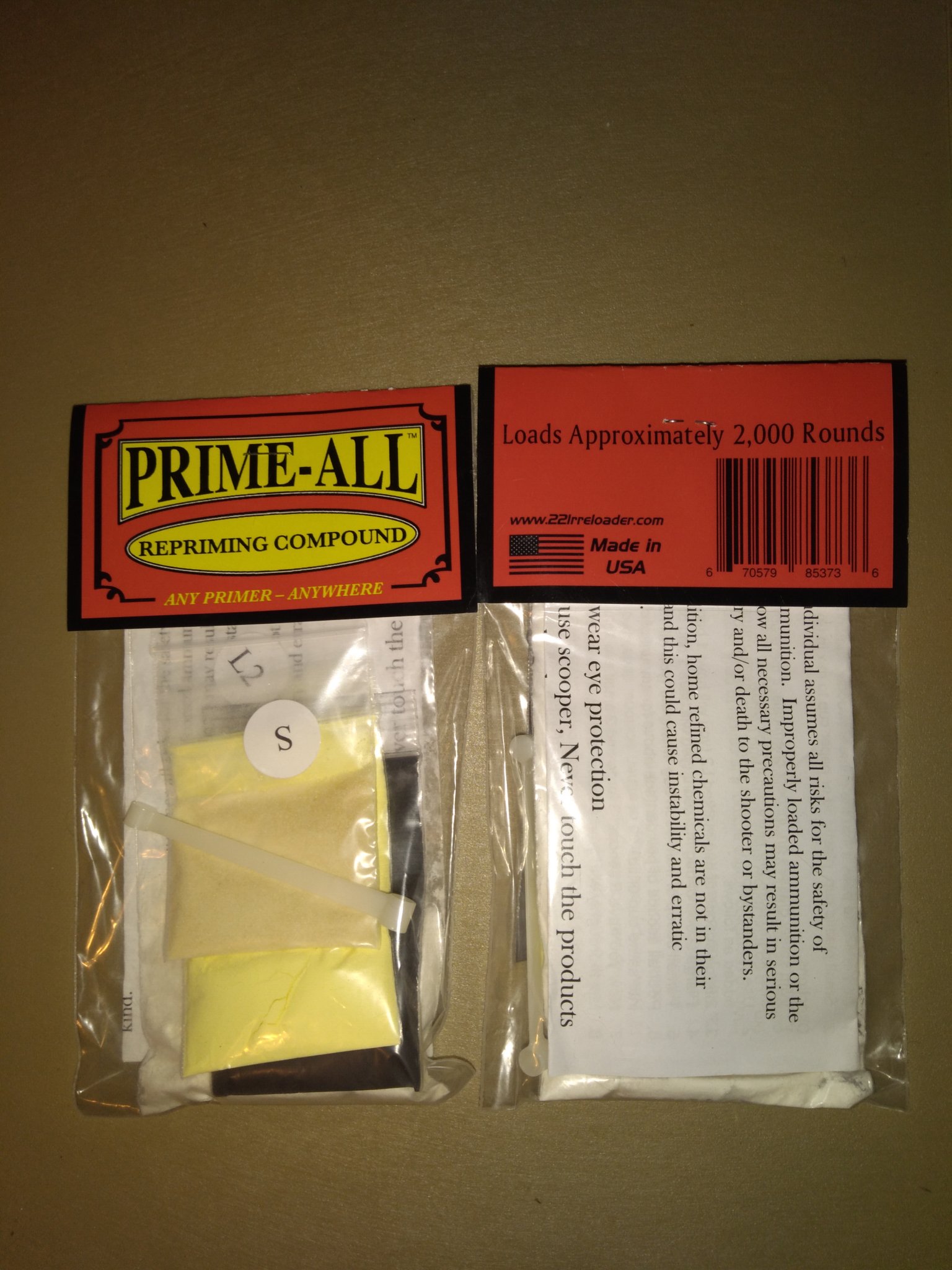

I have been happy with my choice to try loads that keep me using less powder save powder and brass still hoping that reusing primers pans out well enough not to need to buy them for a long while .
What are you reloading your primers with? I bought 5 lbs of primall compound, says its enough to reload 10000 primers. Cost me about 100 bucks but from my testing is super corroasive. Good in a pinch but im not gonna put it thru my guns unless i have to anymore.

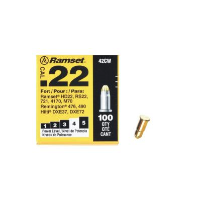

it will be 6.5 creed yea about the same thing I got except I choose to use toy caps and
I have gotten the mixture to go off and even shoot a bullet . I am just having problems with the mix and amount my es numbers with it are really high still good luck with yours .
