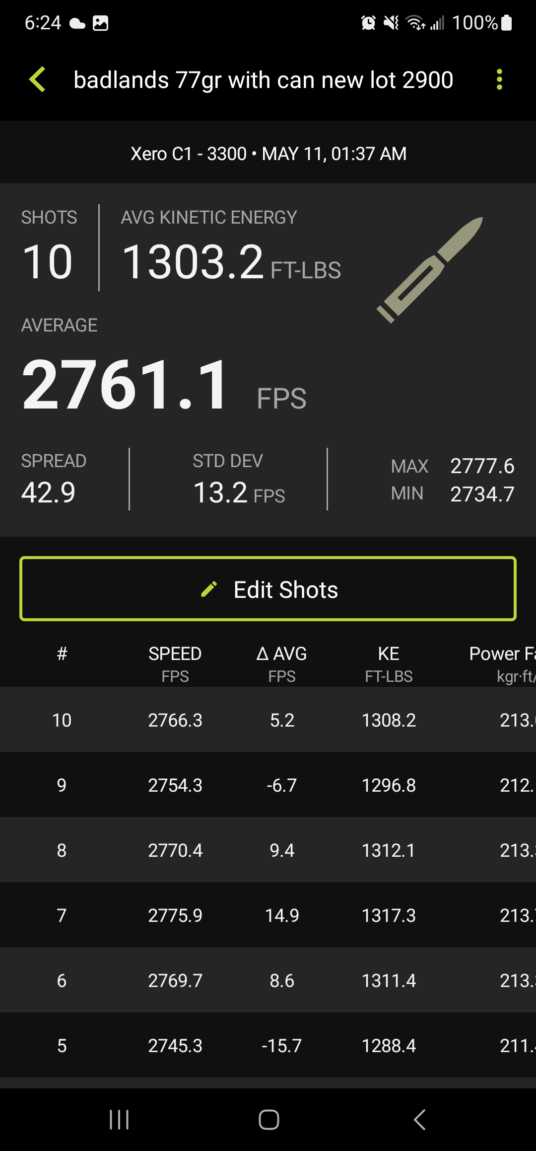

Badlands 77gr shell shock fired from a 12.5 criterion core with a griffin explorr. This is the most recent batch
The mk12 with the can and mk262 is rated at 2750.
I'm essentially getting the same ballistics out of a 12.5 now that I would traditionally get with an 18"

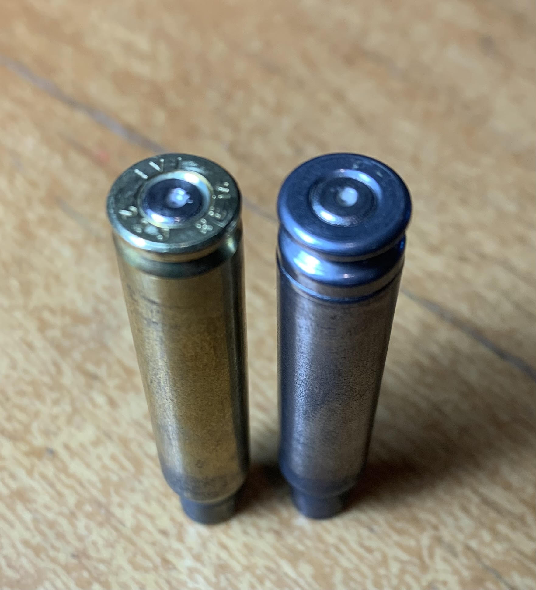

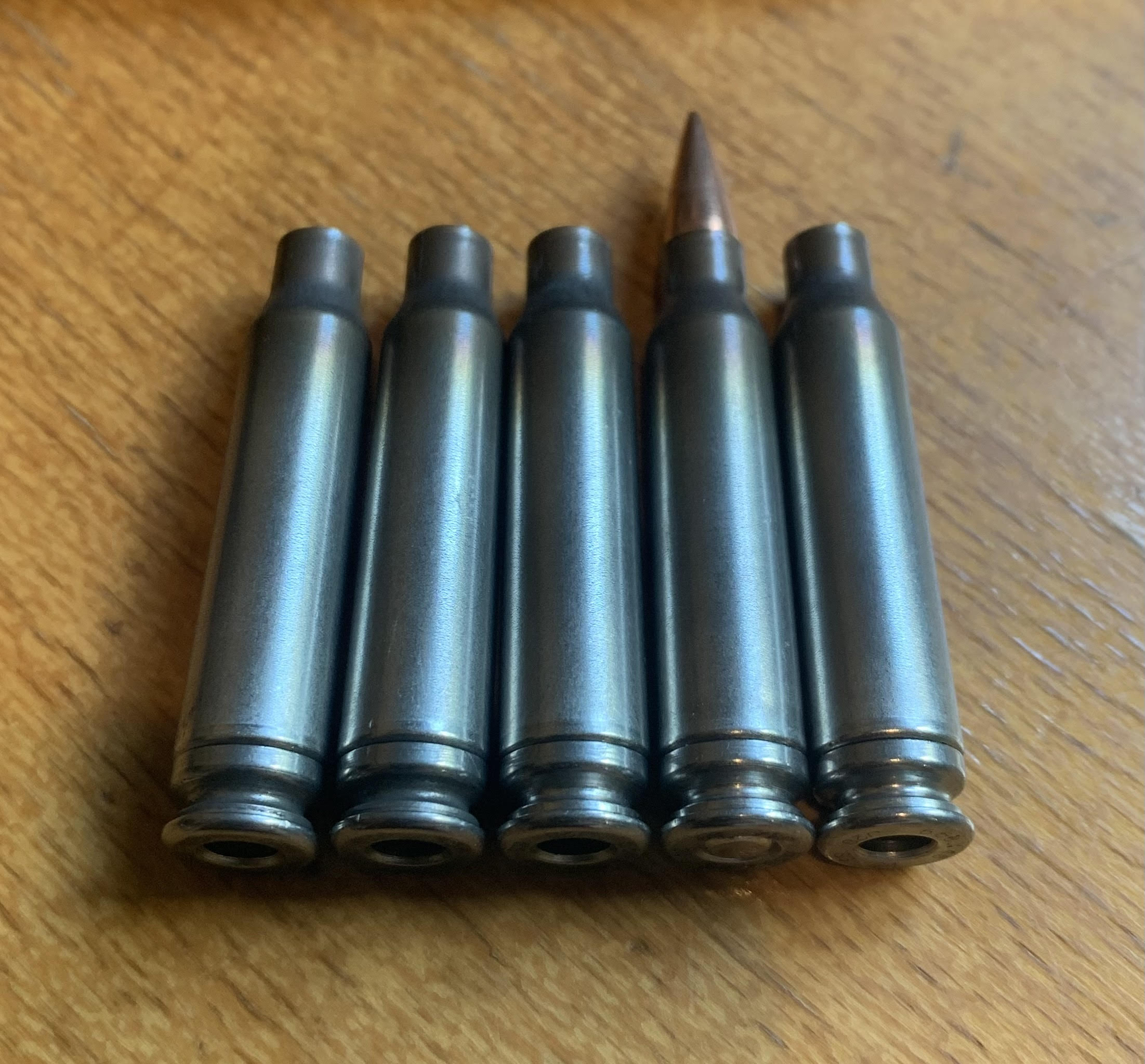

Another benefit I saw that I haven't heard mentioned. Someone else please do this to confirm. In my 10.5" Suppressed AR these shell tech cases ejected clean as shit, almost no carbon.
Here's 4 fired with 1 unfired. Not cleaned or wiped down. I don't know how to explain this but I like it. Gun runs much cleaner with these vs brass.
These bastards still have neck tension after firing.

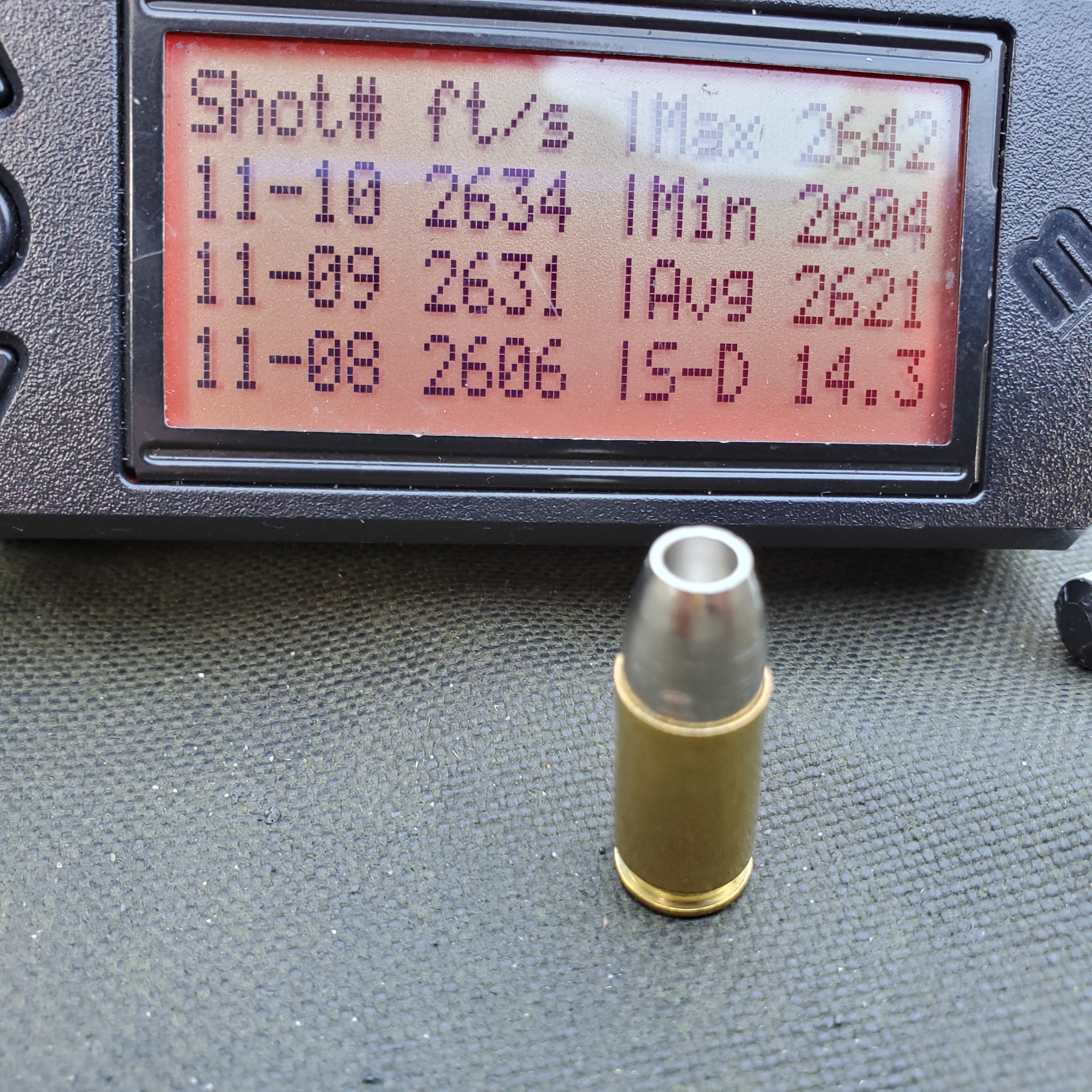

Factory Hornady Black 110 Vmax is pathetic at 1419fps Southern munitions 110 Vmax is better 1712fps
Shell Tech
170 Norma Tipstrike @2.260" = 1722
174 eldm-vt @2.260" = 1640
155 TMK @2.260" = 1933 SD was from 1.7 - 4.9 Powder/bullet/cci450 are playing well together. Still has 775 ft-lb @300y hits steel hard.

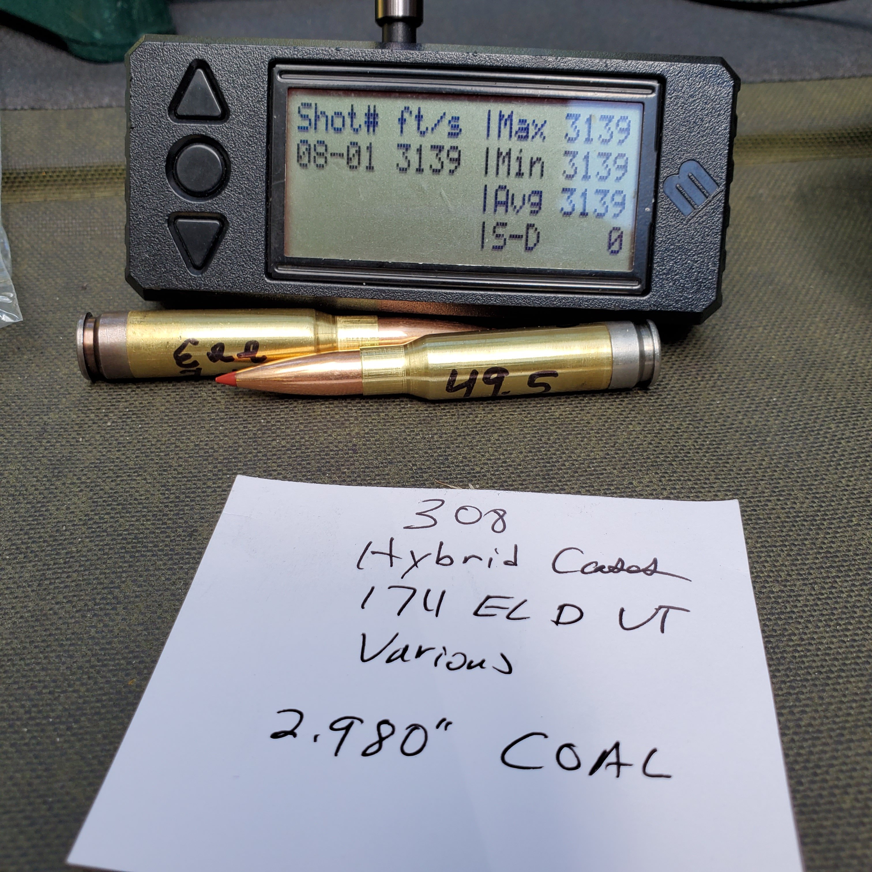

I've shot alot of high pressure SIG hybrid loads in 308, and other calibers.
Like the new 174 gr ELD-VT yesterday at 3139 fps out of the 308.
The 308s shows almost no throat erosion, while the 6.5 CM shows quite a bit and going down the barrel, with a lot less rounds.

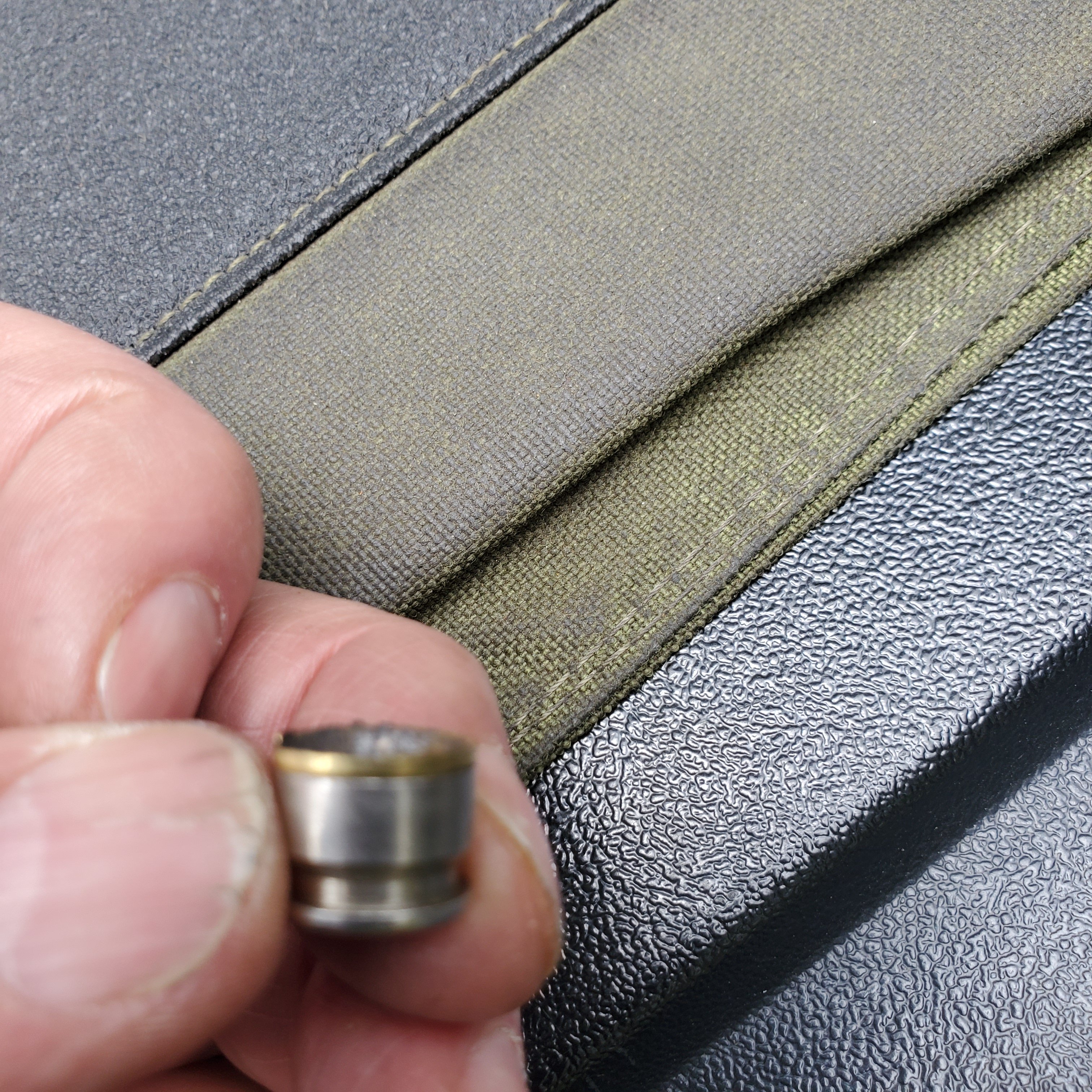

The 6.8x51 hybrid cases can be loaded with regular factory dies, no special tools needed.
After 5 reloads I started experiencing case head separation, just above the Stainless steel case head.
These are early cases and have very thin brass resulting in 58.3 grs of H2O capacity. It's been reported that later cases have less capacity, and thicker brass...I haven't confirmed that.
So now with my early hybrid cases I would recommend resizing as little as possible and discard after 5 reloads.

😳 3,139fps for a 174gr VT…. Wonder what that looks like on gel.

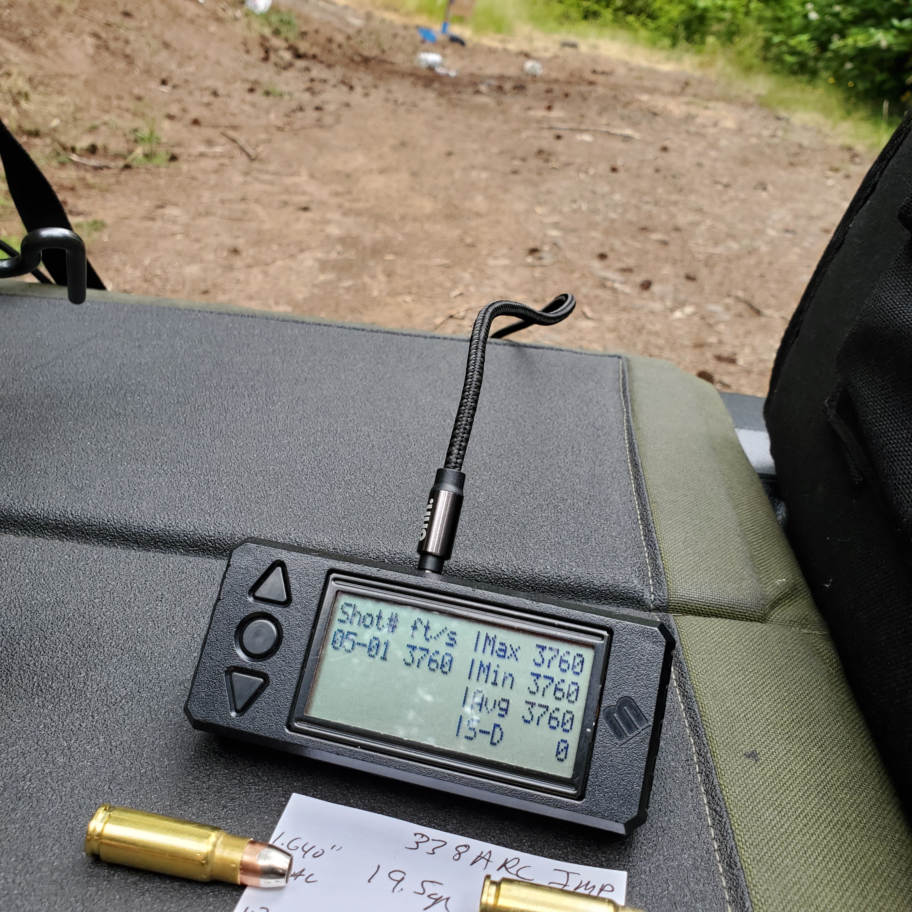

Some more mad science stuff 338 ARC 3760 fps max velocity 16" AR...good for 1 liter jug shooting, regular brass cases.
8.6 blkout 160 gr Barnes 2800 fps hybrid cases.
Same 1 liter destruction purpose 9mm 2621 fps ave 16" AR 15...good load.
Regular brass cases on these.
All the new introduced products just allows one to explore the possibilities even more.

Hybrid cases, pfft
If I recall correctly from the episode with the brass and action with some people who knew more than himself to guide him he went well beyond what was calculated to be 100,000psi. Should go without saying, don’t try this on your Remington 700…
I have been using starline small rifle primer brass to push my 308s to 30-06 velocities. I havent noticed any difference between those and Petersons. The only thing I have done is anneal the starline and I am using mag small rifle primers. It is 99% case fill so it is compressed but have not had any pressure issues with my Origin action. The 155 tmks are running at 3015fps on average. I would not try this in a semi auto obviously or even a lower quality action.

Been dark on here for a bit. Still putting rounds down range though. So far I've shot 1000+ of these cases in 223 bolt, gas & 300bo gas.
I originally wanted to try it for gas gun lost brass matches.
Been very impressed with these cases. Very consistent weight & size. I've yet to find one with a dented neck.
They have more head space then I'd like .008-.009 in 3 of my 223W. They have more neck tension than I'd prefer & I need a .2245 to have any effect on reducing tension. With .2235 you can barely feel it touch. Lot of spring back on these. Case necks are as thick or even a few 10ths thicker than brass. I tried a Lee collet die for shits and the thick steel neck laughed at it. At 24 cents a pc there not worth screwing with as far as reloading. They also have a slight flare on the mouth to help load flat back projectiles. None of these gripes seem to have any negative affect on accuracy though. I do think SD's are suffering a little on the 223 with the high neck tension & it's not super consistent on seating pressure.
I just prime, dry lube the necks, load, & kiss it with a taper crimp just to close the flare.
