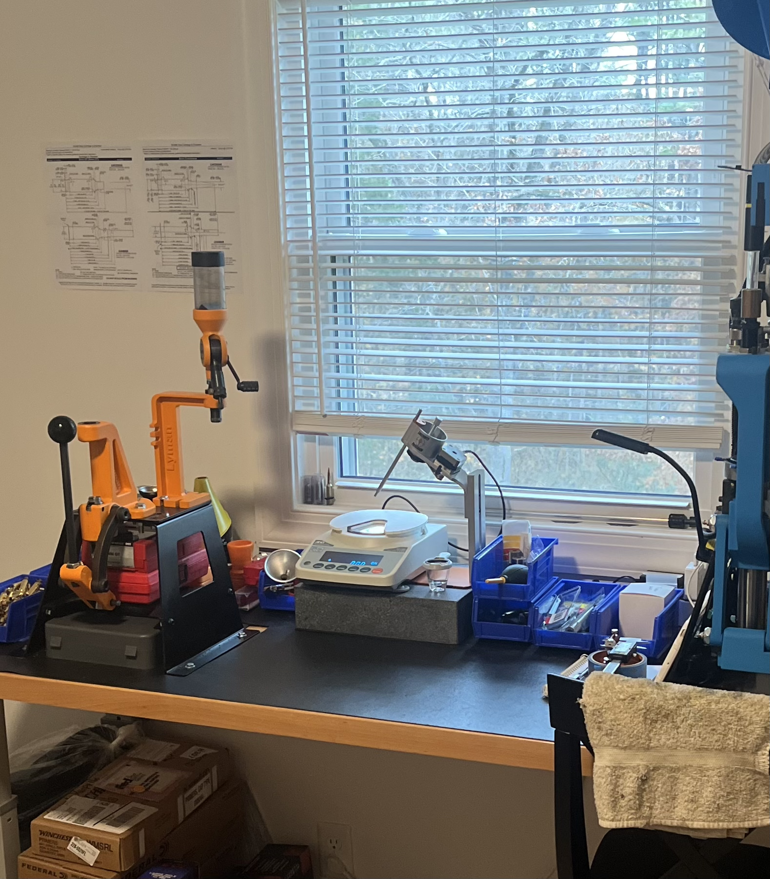

I replaced the thin nut that mounts my RCBS Uniflow to the stand (by necessity because I somehow lost it) with a normal 7/8-14 nut like you'd use on a bolt of that size/thread on a piece of heavy machinery. The nut is about 1 in. thick, and makes it really easy to tighten/remove by hand without a wrench when it comes time to dump the powder back into the jug. Mine is mounted on a swing arm made by Inline Fabrication that attaches to their quick-change press stand. You can swing the powder measure out of the way when not in use. I don't find it to be much of an issue not having it drop directly onto the scale, and probably avoids some of the hassle that could involve.

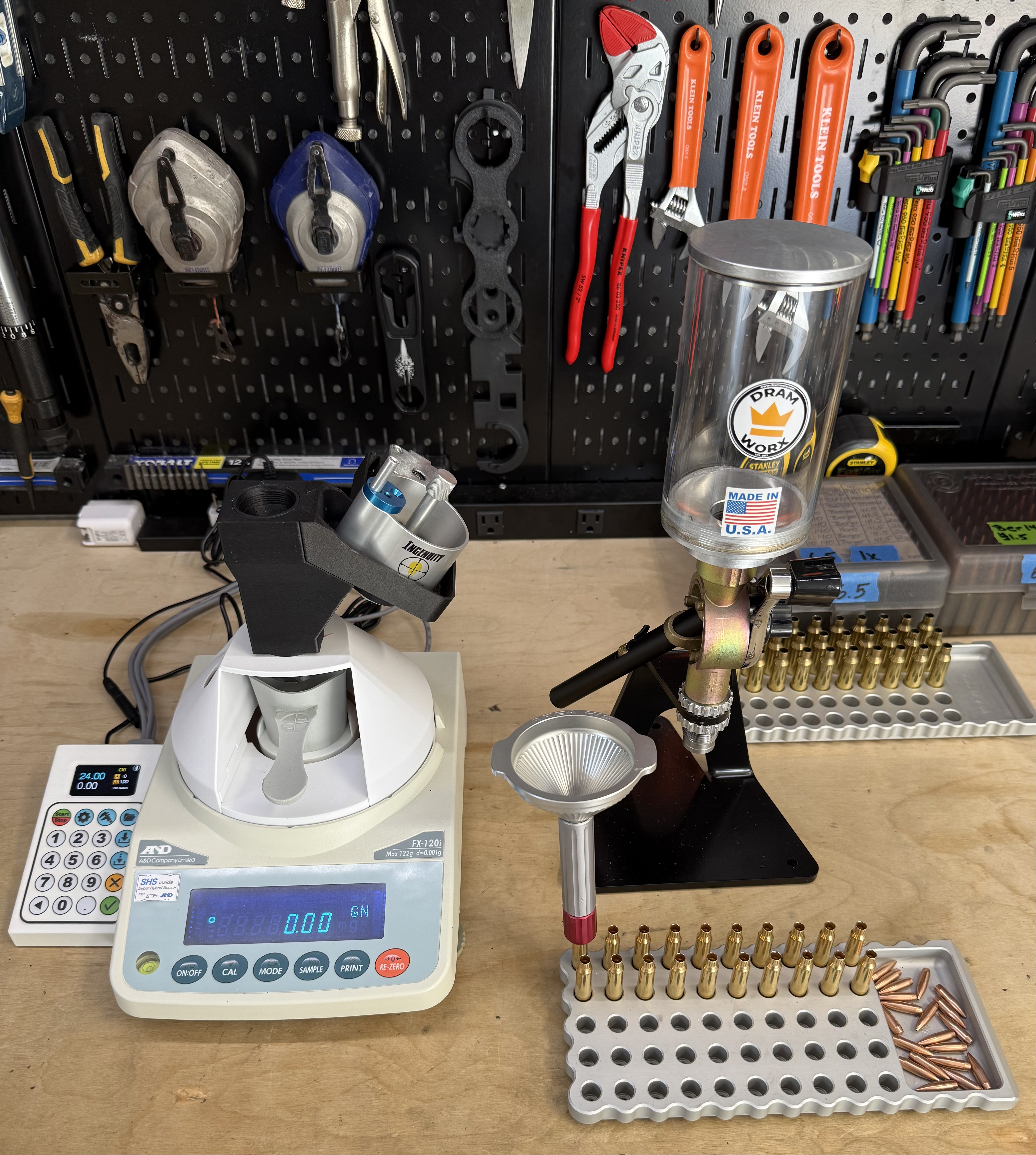

Others have already mentioned most of what I've got to add... You don't need the manual thrower over the scale, and making the bulk drop 1.0-1.5 grains under your target gives the IP trickler time to spool up (and then slow down to the kernel). Even dropping the bulk of the charge manually, drops still only take ~ 6-8 seconds, every one to the nearest kernel (+/- 0.02 grains).
I've been doing it this way for like ~3 years now (?) and IDK if I'm even going to buy the IP bulk dropper when it's finally released.
My shit is fast and has been so bonehead stable and drama-free that, besides good 'ol laziness, I don't even know if messing with it just to save maybe 1-2 seconds per drop is even worth the trouble.
