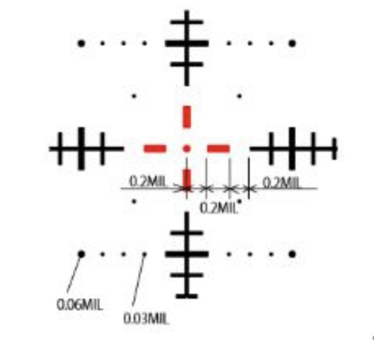

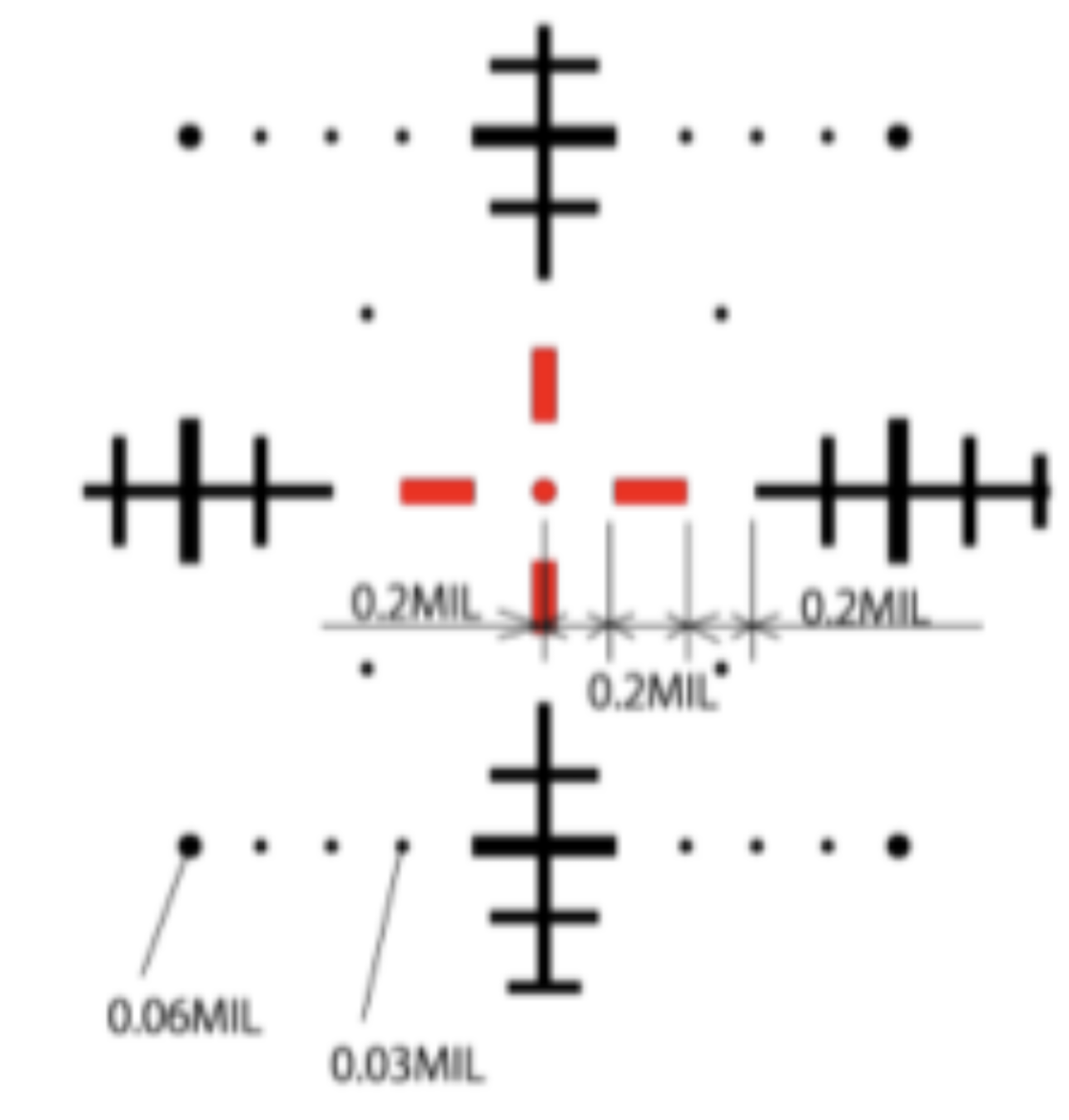

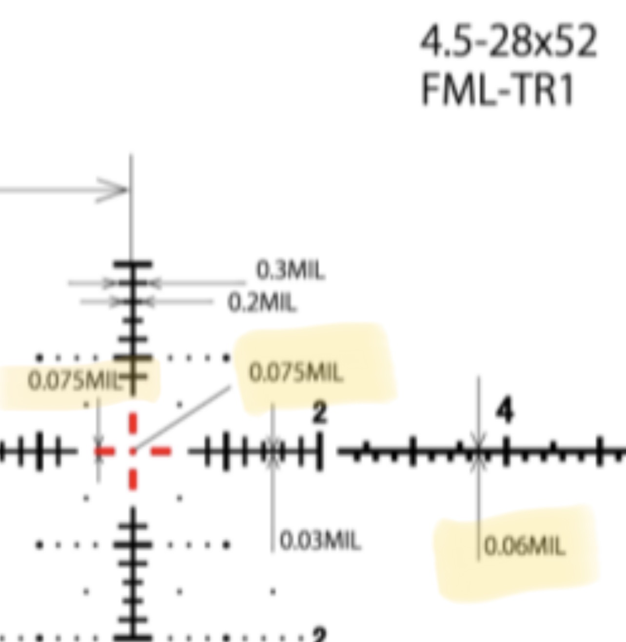

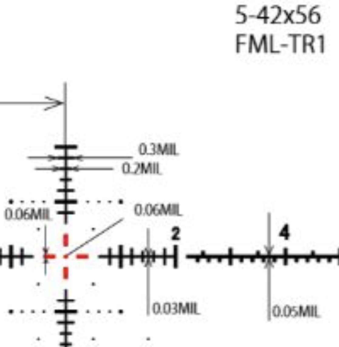

The March-FX 5-42X56 Gen 2 is available with tree reticles such as the FML-TR1.

Some forget that the Tremor reticles were mainly developed for the military to engage human targets, yes it could be used for other things as well. - Richard
Totally agree. I almost bought one after playing with their reticle simulator on their site. It’s pretty cool. I think David Tubbs made a similar reticle, only angled down, left to right, to also simulate aerodynamic jump.
Anyway. Then I calculated out the T3’s .2 mil big dot size, in inches, at 100-1100 yds. I’m not shooting a pdog past 5-600 hundo, but I was just curious.
Range in ydsMore exact
T3 big dot coverage
(inches)
Approx size
T3 big dot coverage
(inches)
1000.72”3/4”
2001.44”1.5”
3002.16”2”
4002.88”3”
5003.60”3.5”
6004.32”4.25”
7005.04”5”
8005.76”5.75”
9006.48”6.5”
10007.20”7.25”
11007.92”8”
Around, say, 350yds the big dot size will become too big and cover too much of some pdog targets.
But the biggest problem, I think, would be that the flyscreen effect of the damn thing would hinder one from finding the dogs in the first place.

For example, here’s a little design analysis:
FML-TR1 for the new 5-42 G2
Here’s that same reticle for the 4-28

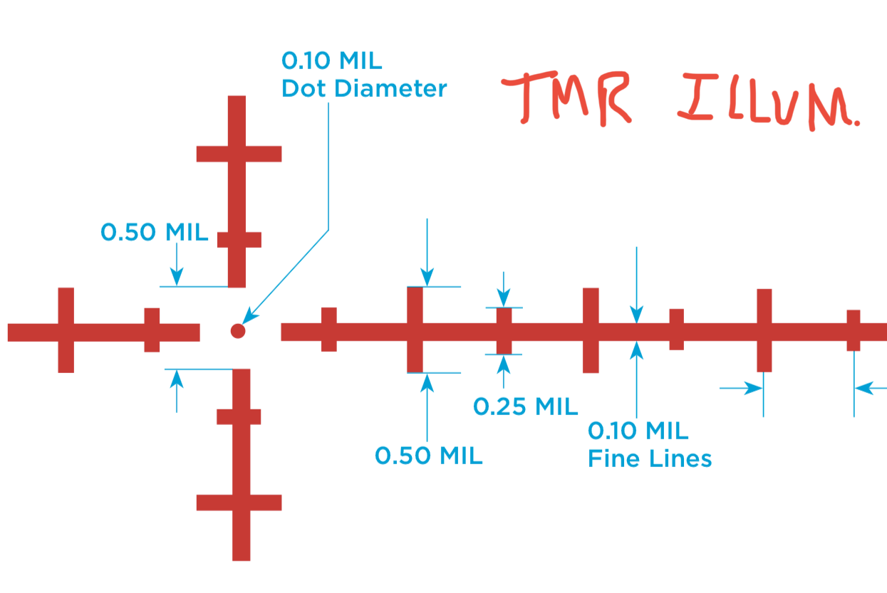

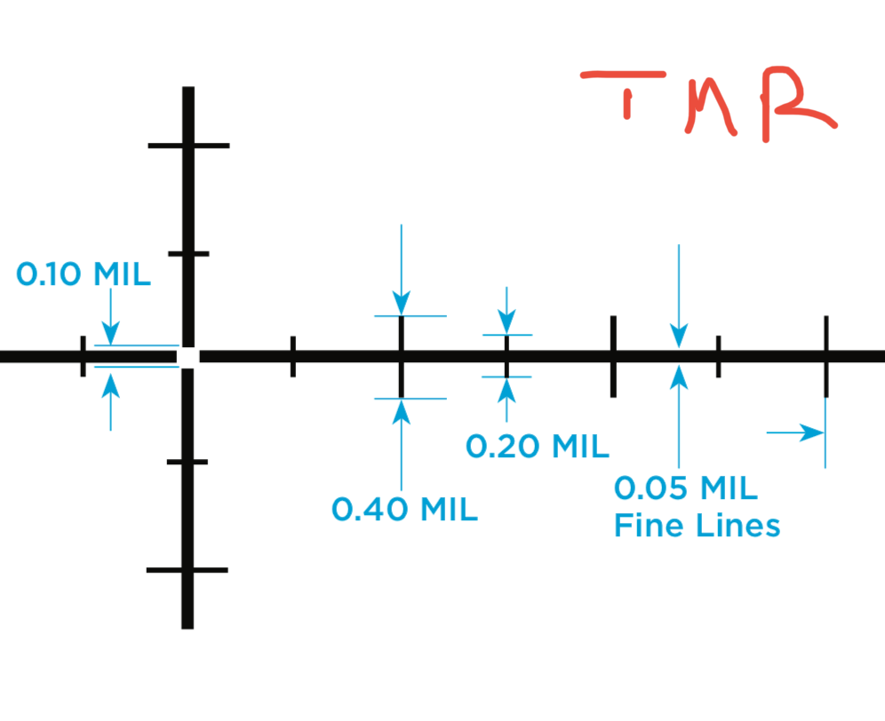

In comparison, here are both the illuminated and non-illuminated versions of the Leupold TMR:
The center area on both TMR’s is 1.0mil, and the main stadia on the illuminated model are weirdly thicker, at 1.0 vs .05 for the non-illuminated version. I would’ve thought that would be reversed, but I digress.
I included the TMR ret as I think it is a typical FFP mil hunting reticle from Leupold. For the US market, anyway.
Here’s a chart of some of the big name’s reticle dimensions.

FML-TR1/FML-3: The sizing on the center dot & stadia on both March scopes seems like it’s sliding towards (but is not maybe at) something like hunting? A little crossover action, methinks, and this is what’s causing some issues for some.
FML-TR1 tree: much smaller tree dots than anyone else. I never looked at the actual measurements before; I’m intrigued! The tree’s “heaviness” of even the EBR-2 & 7 rets is what can cause my pdog spotting issues out in the prairie.
