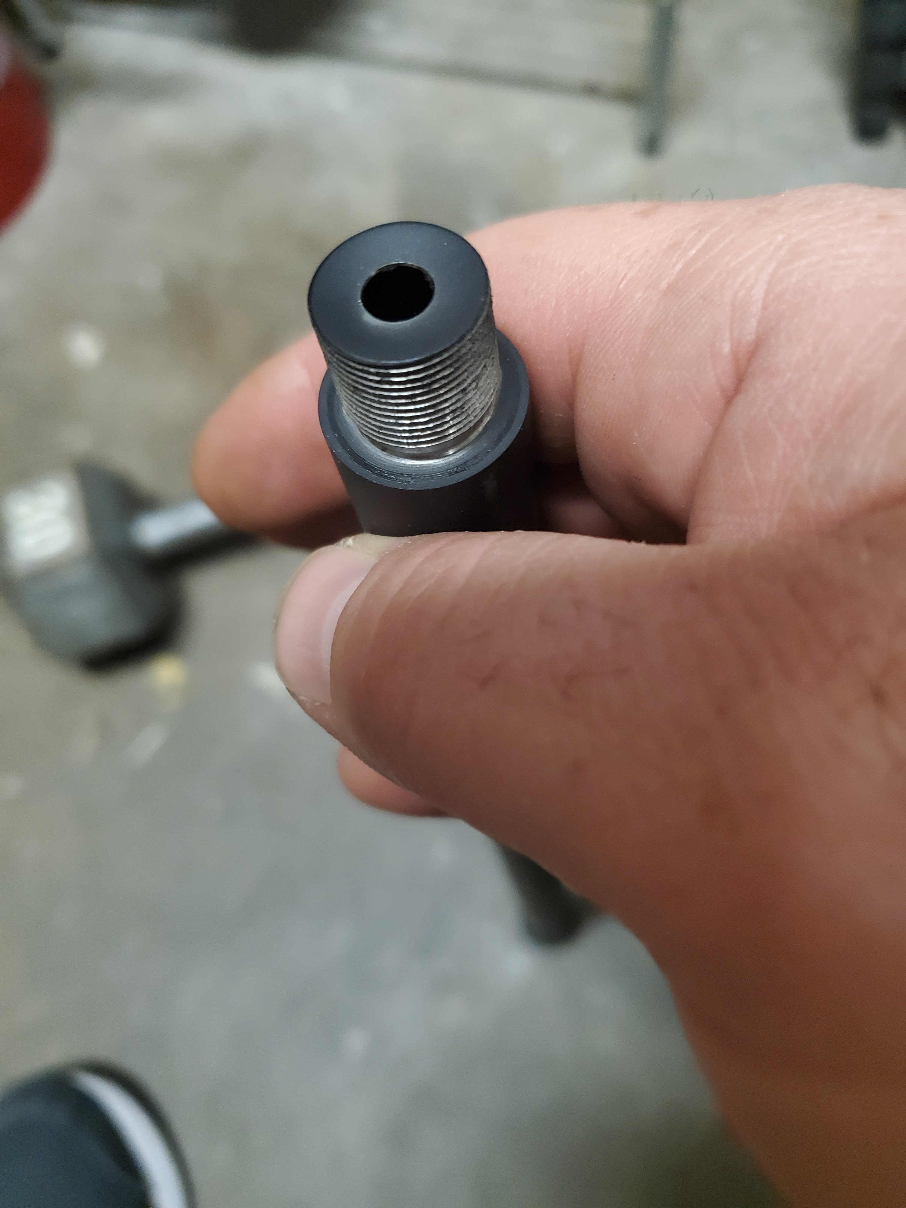

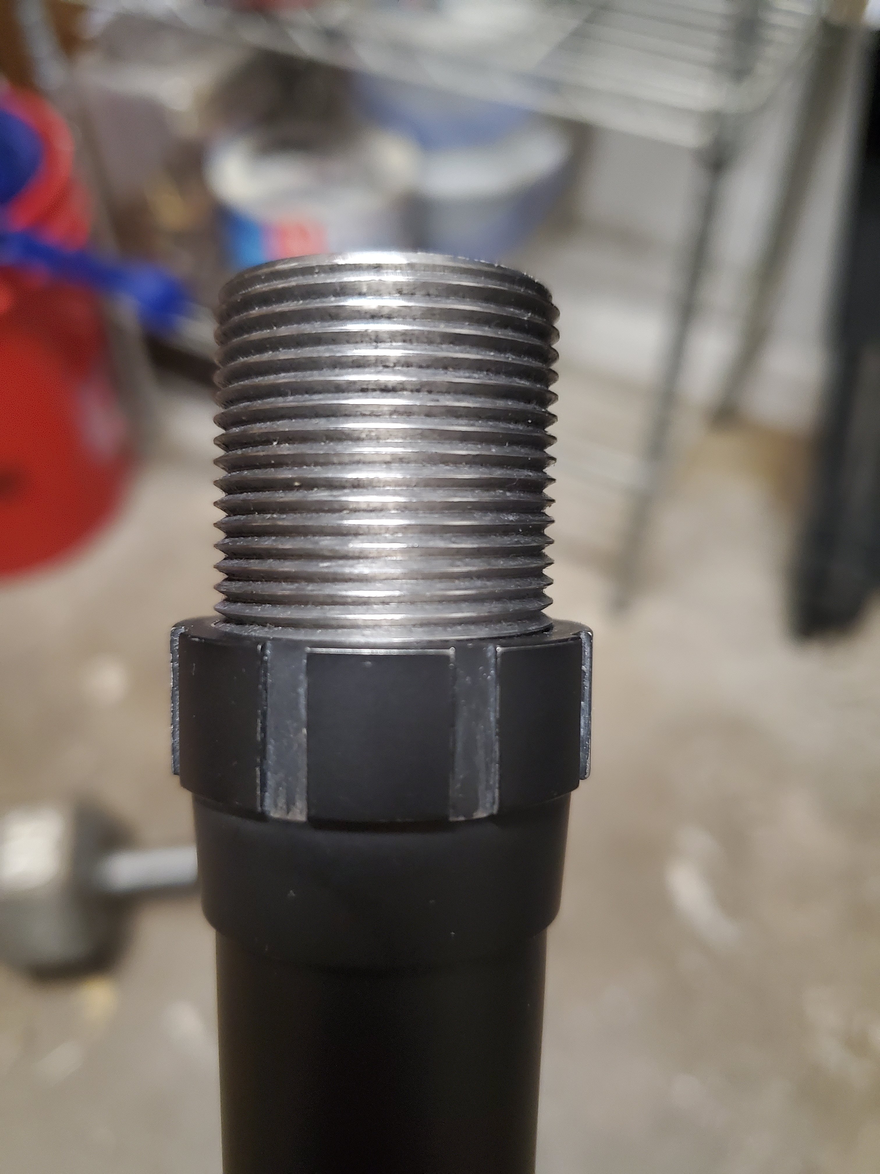

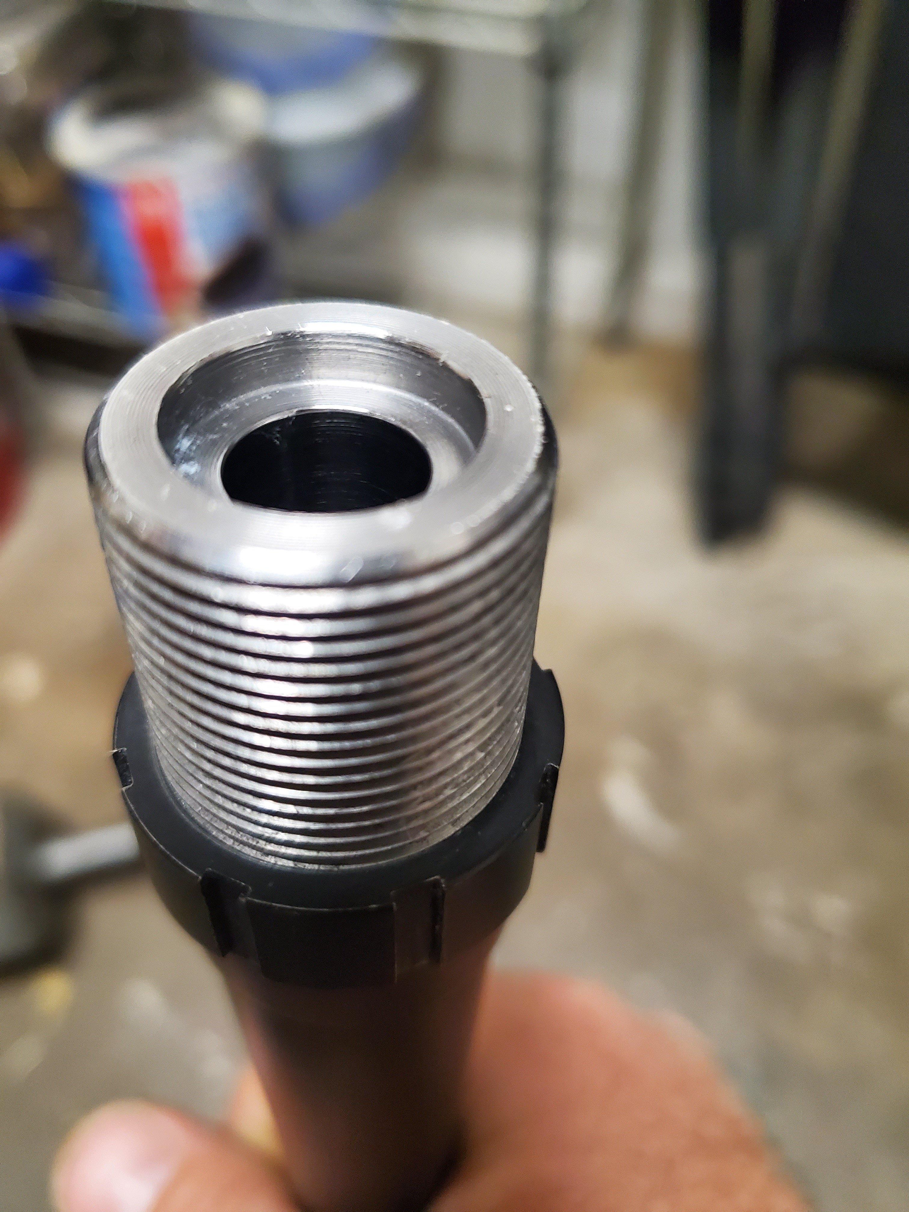

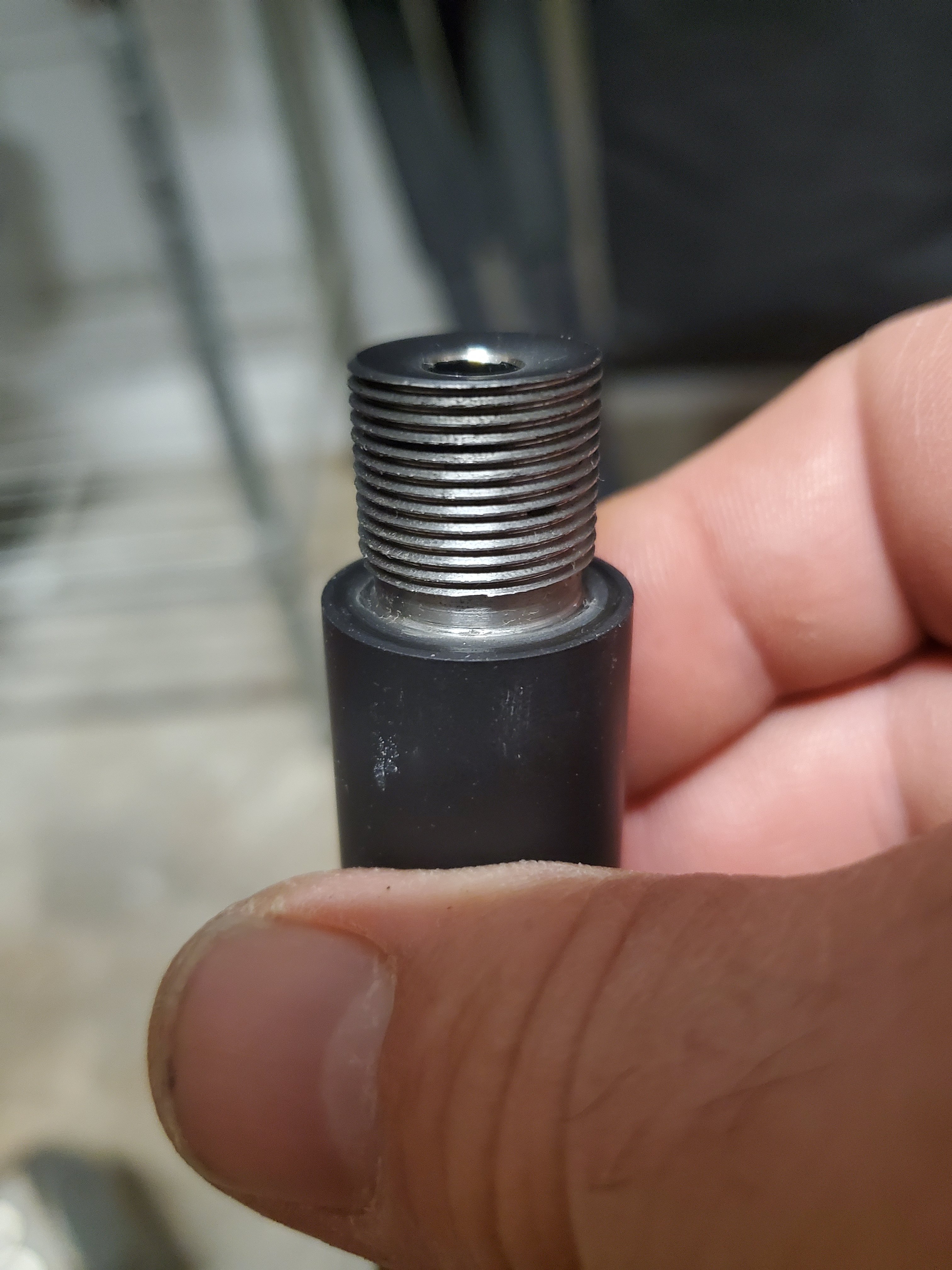

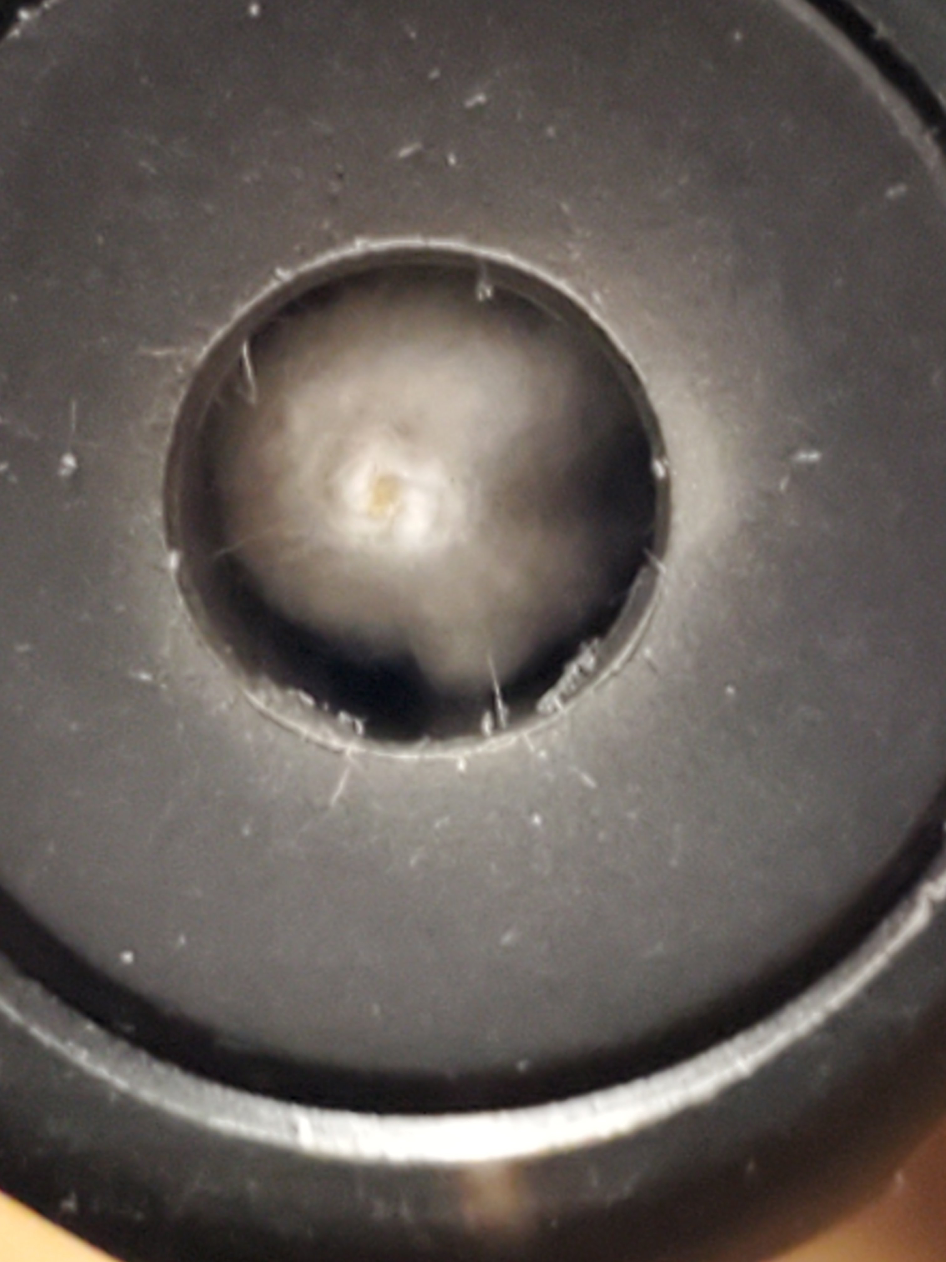

    I would like to see a picture of some of their threads. I have 2 McGowan remage barrels that look like this and they were replacements for a third. None shoot, all threads have been well undersized and extremely sloppy fitting. So when I hear they never miss I want to see proof. I just saw one for sale in PX a couple months ago with the same terrible threads.

    I've read lots of mcgowan/c6 prefit problems reported. Poor threads, poor chambers, crooked and rough, also improper headspace. I don't think there is anything wrong with a Mcgowan/C6 barrel, I just sure as hell wouldn't let their team cut the threads/chamber.
    Reactions: Black Bart
    I've chambered dozens of McGowen barrels, they're solid mid-tier blanks- but I have had issues with a couple of short-chambered prefits that I'd taken in to complete for customers- one needed to be returned as the tenon OD was substantially over spec and I didn't want to fuck with it to make it right.
    Reactions: 4O6shootist
    McGowen blanks aren't the issue. It's everything else they do. I was also a victim of their poor machining. Literally looked like the guy had no idea what he was doing. Just do a search for McGowen and see all their failures.
