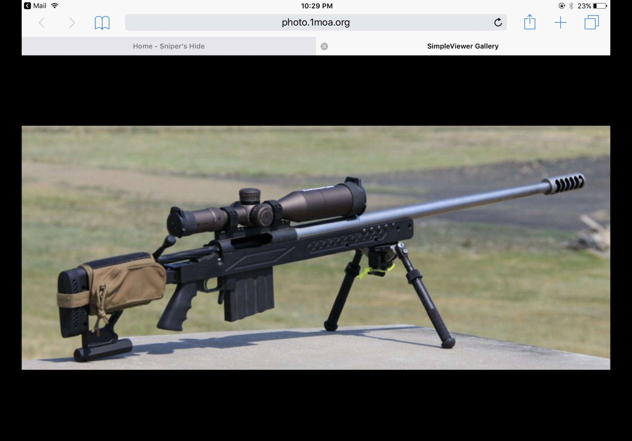

Does anyone know what manufacture of Cheytac sized magazines fit the Mcrees chassis? I called Mcrees and they said none really work well, but the Cadex dont. Does anyone know if the XLR brand mags work with the chassis, but im told they dont make magazines so whos is it? What experience do people have.
To be exact a 1.6 stiller TAC Driver (tac408) with a 585 bolt head.

The mag that comes with the McRee chassis seems to work well, We haven’t seen any issues as far as feeding. The chassis system as a whole has been a great tack driver and has worked well for the last 5 years of use.
375 with a 80 moa rail and scope system
Ok to answer my own question, I rolled the dice and bought a mag from XLR, it fits the chassis. Don't know about if it feeds well, ill know when i get the gun together. Ill check back in with my experience. The mag I got had no markings. I have a strong feeling based on the 3.850 WM mag I got at the same time its accurate mag is who is making it for them.
