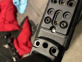

During a match in june, I was finally able to figure out why I couldn't load a round in when I had forward pressure on a barricade, in that my magazine was moving around in the magwell and causing rounds to bind when feeding. I looked up how to adjust the magwell but the adjustements that are in the instructions and on the website didnt really allow for anything on my chassis. I ended up using the tolerances of the plastic modled pieces between the magwell to tighten it up a littl bit, but no where near as much as the instructions say one could. I ended up using a MariTool Conversion card thats .0225 thick and cutting a small section to make a shim for it. Tested my MDT Steel 10 round mags and they were pefect. Here's where my problem starts. I just asssumed my 12rd magazine would fit just fine. but come to find out I have to press it in crazy hard, and to pull it out is just as hard, if not more. Any suggestions as to a resolve that doesnt include removing material from plastic parts? I have kind of conceided and bought a +2 extension, but it would be nice to have a 12rd magazine that fits.

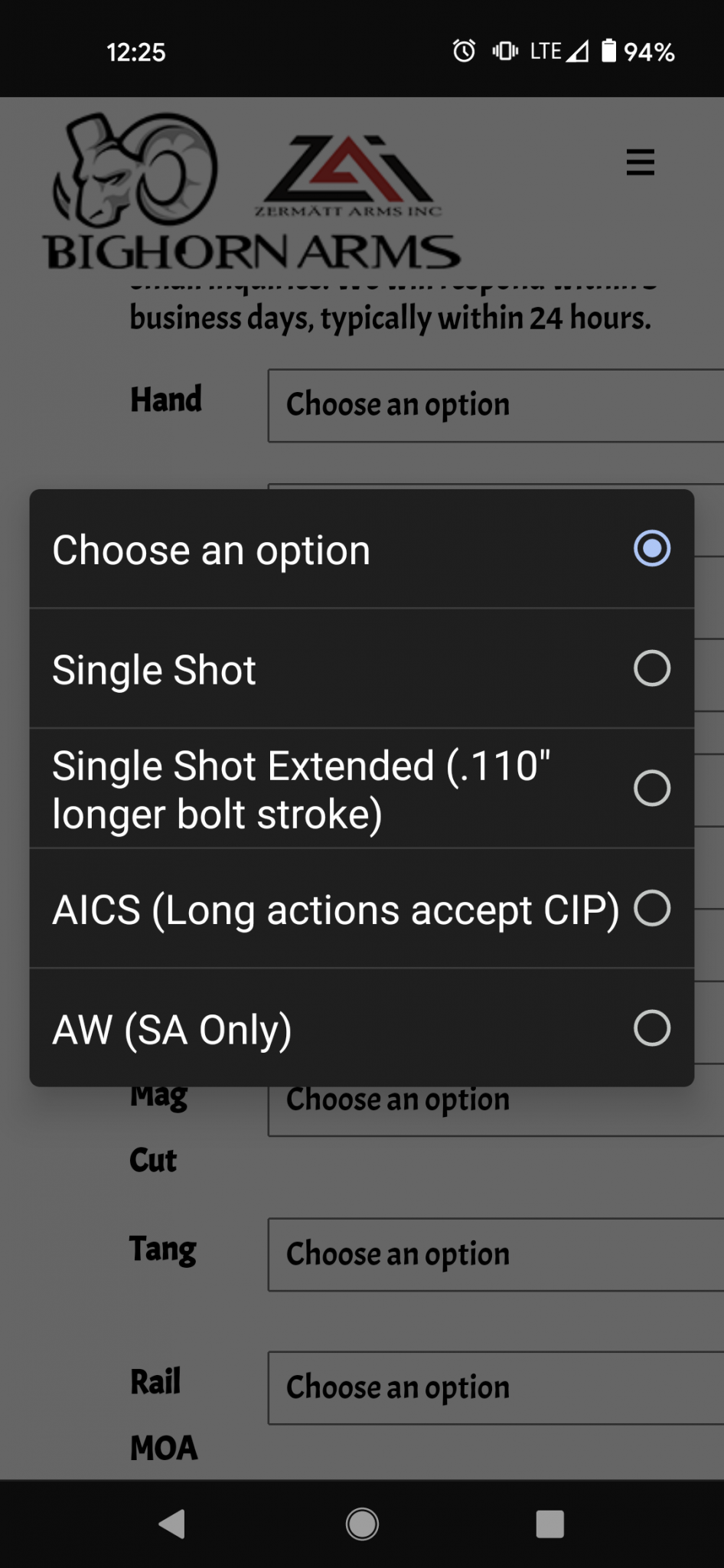

TL3 in 6.5CM and AICS mags
Huh? AICS/AW are the same cut
Do you mean the AW cut will accept AW and AICS?
As i understand it...
You can also get the TL3 with only the AICS mag cut.
If OP has the AW cut, he can use both AW and AICS magazines.
If OP has specifically the AICS cut, then only AICS mags can be used.
