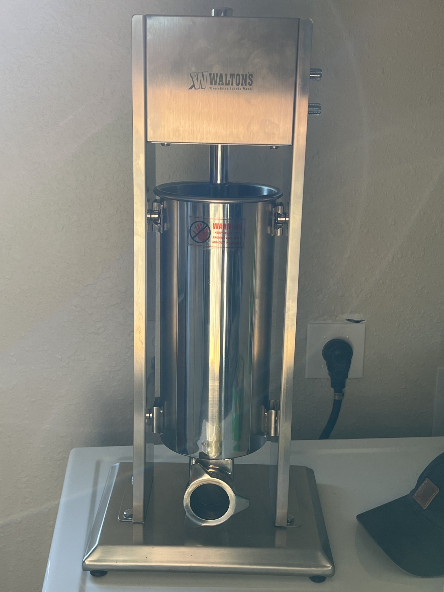

Waltons have metal gears as far as I can tell. Been very happy with it.
Looked this up on their website.
Features:​
  • Stainless steel construction, frame, stuffing tubes, and cylinder
  • Heavy-duty construction frame that will not bend or warp even when stuffing small diameter snack sticks
  • Aluminum gear box with zinc plated steel gears for years of use without the worry of stripping
  • Aluminum piston with a durable rubber gasket keeps meat from leaking around the canister
  • 11 lb meat capacity and 5 liter total capacity
  • Air release valve built into piston to help avoid air pockets in your casings
  • 2 speed gearbox - high speed for raising and lowering the piston and normal speed for stuffing
  • Tilting and removable canister for quick filling and easy cleaning
  • 4 Sizes of stuffing tubes: 12mm, 16mm, 22mm, 38mm
  • Compact size that is easy to use and store

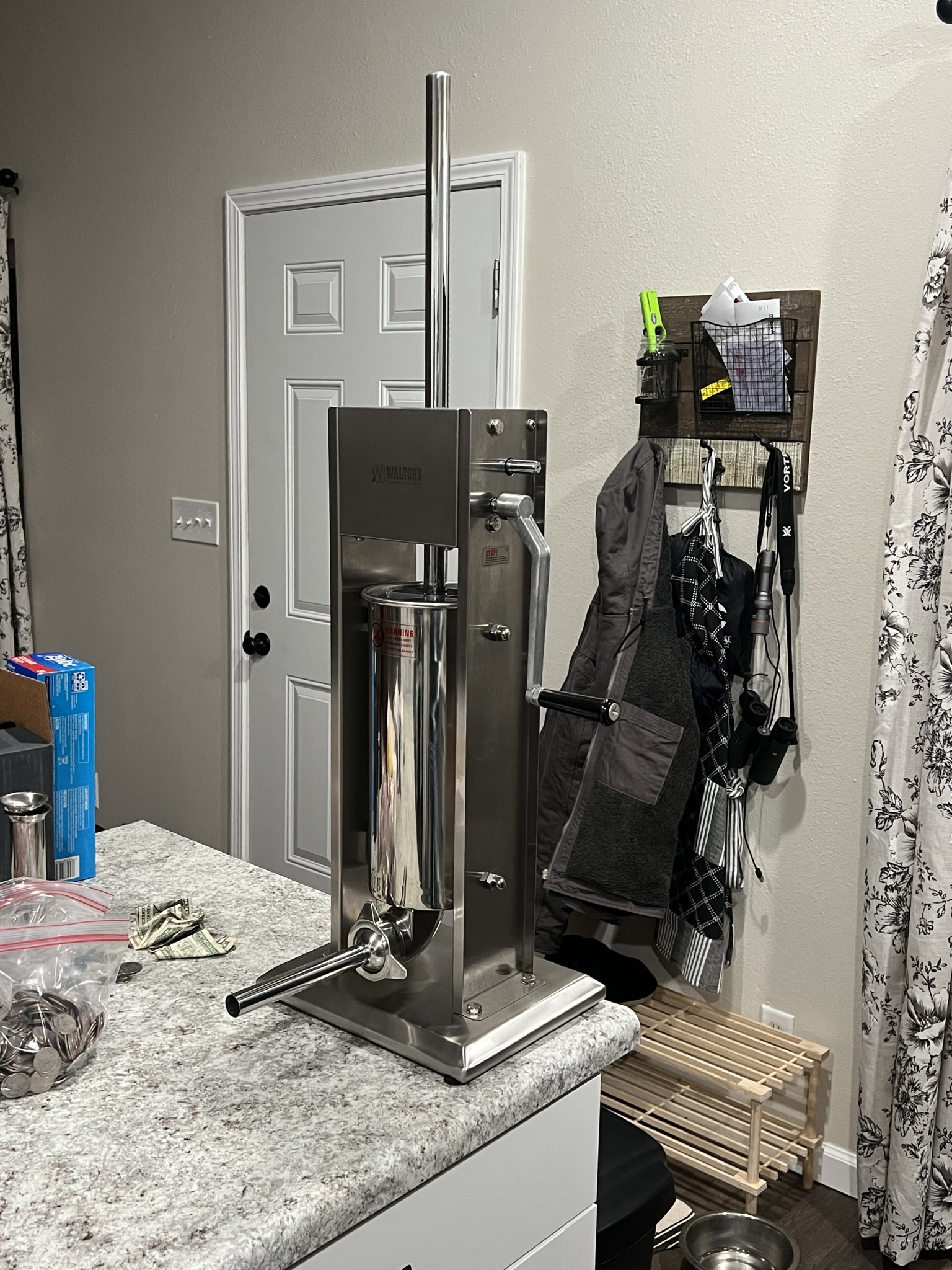

Yep, zinc plated steel gears. I just bought a 7# one. Thanks for the recommendation!

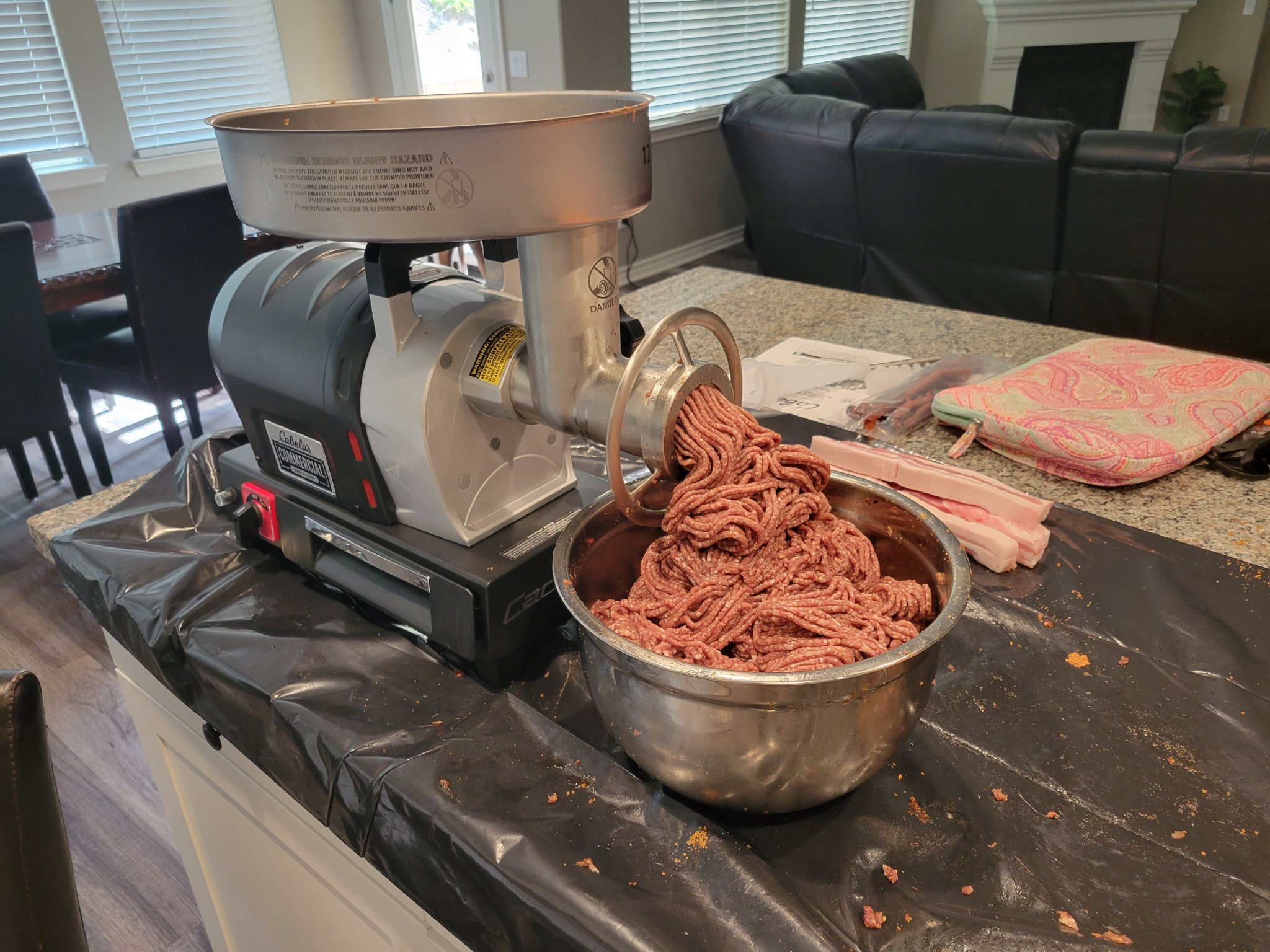

I finally bit the bullet and bought an LEM grinder and stuffer this year… I can’t believe I went all those years processing game without them. It’s not even the same experience. The grinder grinds faster than I can feed it, and the stuffer is amazing for filling burger bags and sausage.

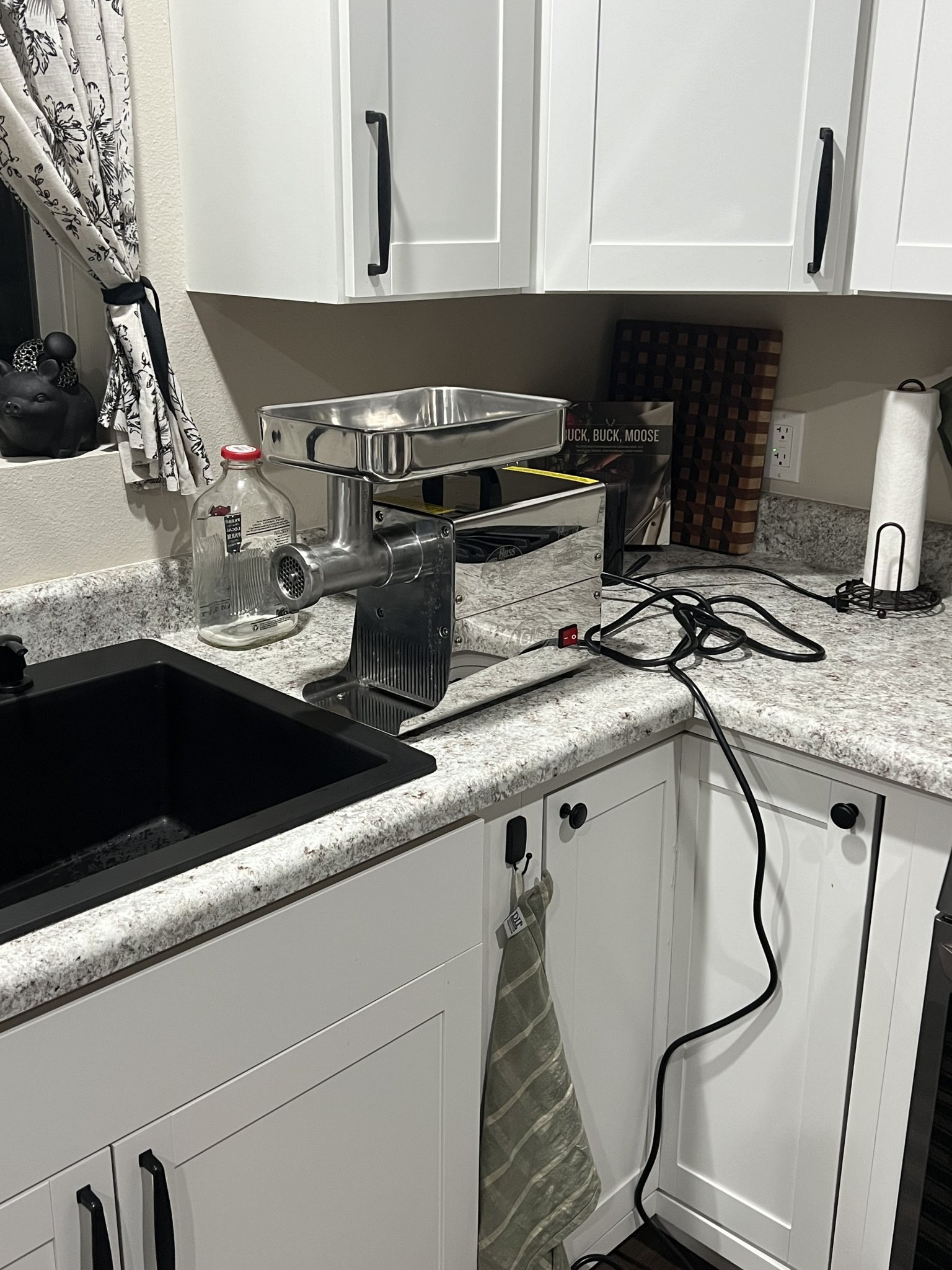

Spent today processing a deer — 31 pounds of meat ground with my meat your maker #8.
.5 horse single stage grinder never even struggled. The grinding isn’t the hard part of this process.
