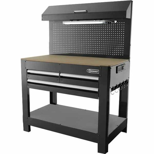

May be a stupid question, but wouldn't be my first or last!! I don't know if this picture will upload correctly but is there anything wrong with having a reloading bench that is made out of metal and wood, or even one made out of metal with rubber wheels??

The only question I'd raise is the chance of a static electric spark if you ever reload with black powder on a steel metal table top. BP (explosive) is very vulnerable to sparks and explodes easily. I don't believe that this issue exists with smokeless powder (propellent), but there are certainly experts on this site that would definitely know.
I have the same bench. It works fine. The top is MDF and not secured to the bench. When I got it I also bought a 24"x48"x3/4" birch project panel, glued it to the top of the MDF. And bolted a 2"x4" to the back pegboard, tight to the bottom too keep the top from lifting off on stubborn cases.
Be advised that most press's will block one of the drawers. I bought an Inline Fabrication riser for mine got the press plenty high doesnt block the drawer.
Also it'll take some time to put it together it comes in a lot of pieces. Best to have an electric screwdriver and a couple spare batteries
All in all it works perfect for me. I like the drawers I have dies in one, all case measuring instruments in another and brass and bullets in the bottom drawer. The bottom shelf stores my stainless tumbler media separator and all my powder with room to spare.

I was not really talking about using this specific bench, just the theory behind the question. I'll try to take a picture of one I was thinking about using for a portable press setup just so I can get some processes going!!
