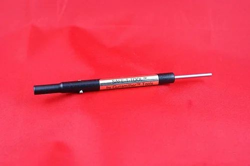

These two tools greatly reduce the amount of swearing when taking a 10/22 apart that far:

Ironically, I have both those GS tools. Bought them ages ago in prep for the eventual day I cleaned this thing.
Didn’t tear down the two stage Kidd trigger as I’m not that brave, and I’m not sure the Gunsmither tools are designed for that specific trigger? Anyway, the trigger area looked ok enough to leave alone. Just wiped off some grime.
But the Bolt Bar was handy! Gotta bone up on how the two little pins work. When in the heat of battle and your hands are oily, it hard to take the time to grab the phone to look at the manufacturer’s how-to vids.
