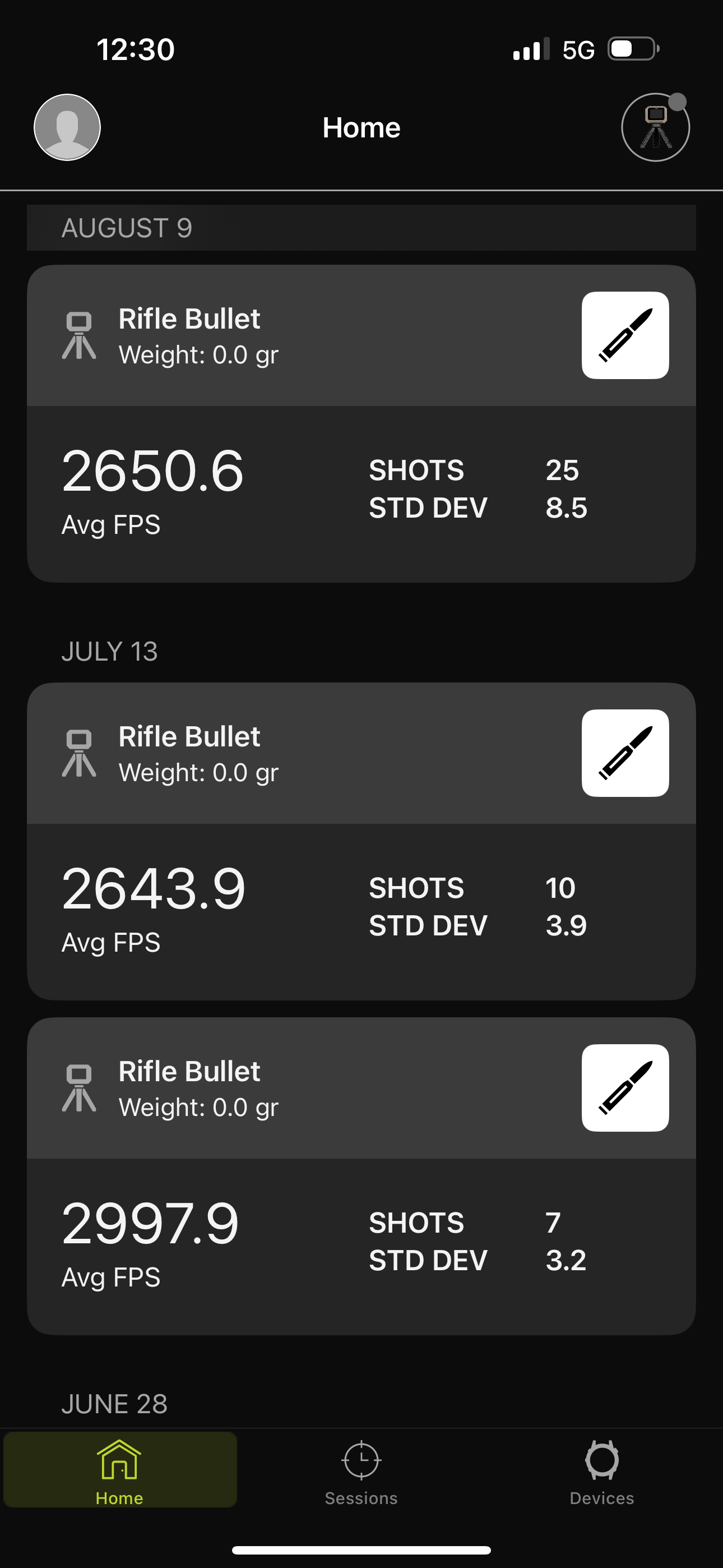

    Load 10 of each separated and go shoot them over Garmin if you’re really worried
    10 shots of each lot over a chronograph would be my starting point also.
    That is if I came up with a good enough reason to mix them.
    Before I get to 10 shots, I'll do a series of 3 shots each to cull out those the did poorly. They're easy to distinguish from the good. It's the good groups in that series that's not definable due to small sample count. Once I've identified what what looks like good groups than might be repeatable, then I repeat the test to see what repeats or not, select those that do and then shoot the longer strings of 10 or more in 5 shot groups to verify. Though I chronograph everything, it's the target that determines the good load. . . not any particular velocity or velocity SD. The chronograph doesn't tell me anything more than how well I'm reloading my cartridges. :giggle:

    Target doesn’t mean anything in load dev to me. I only care about es/ sd.
    I’ve never seen a group that metered well shoot poorly and the reality is without a $2k rest you can’t tell which of the half dozen sub half moa groups is better than the other.

    I would want to know if the brass mixing is going to affect ES, and SD spreads. I don't care about the target at this point. But I do tend to shoot everything at a target.
