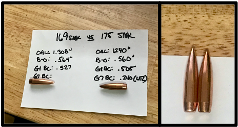

    The 169 SMK’s advertised G1 BC is .527, which is an improvement of 31 basis points from the 175 SMK’s G1 BC of .496 at 308 Winchester velocities. The bullet itself has a much longer, more streamlined profile compared to its elder siblings, the 175 and 168. Sierra clearly designed this projectile to compete with some of the more modern, higher BC bullets in the 165-185 weight class like the Hornady 178 AMAX/ELDM and 185 Berger Juggernaut. Specifically, they intend for this bullet to enable the 308 Winchester to be consistently effective out to 1,000 yards (915 meters).
    Here it is compared to the 175 along with relevant info. 169smk is on the left and 175 smk is on the right in both images.

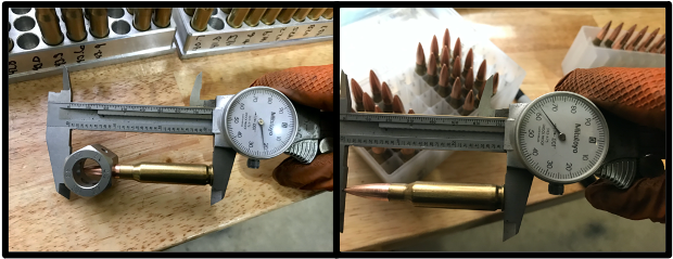

    I used Varget and chose three charge weights, 42.8, 43.1 and 43.4. Primer was a Remington 9-1/2 Standard LRP and cases were 1x fired and full-length sized Lake City LR 07. All rounds were loaded to a cartridge base-to-ogive of 2.110, which put the OAL at 2.850, quite a bit longer than the 175 SMK which I load to a COAL of 2.800.

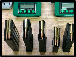

    The extra length shouldn’t be an issue for most bolt guns but will be cutting it really close for semi-autos depending on what mag you run. Here is the loaded round in selected short action magazines...From left to right: KAC Steel, Magpul AICS, Accuracy International AICS, Accuracy International AX d/s, Magpul P-MAG for SR25/AR10s

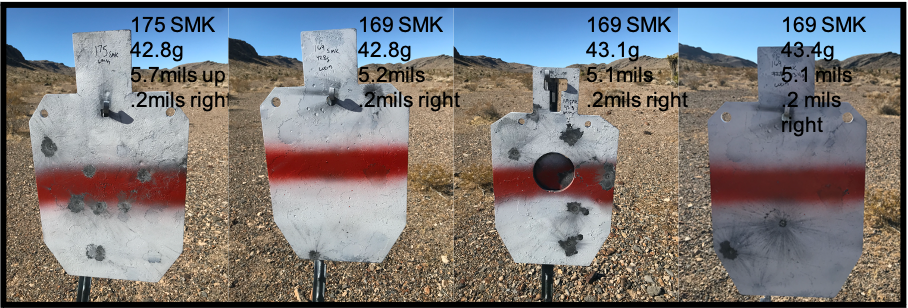

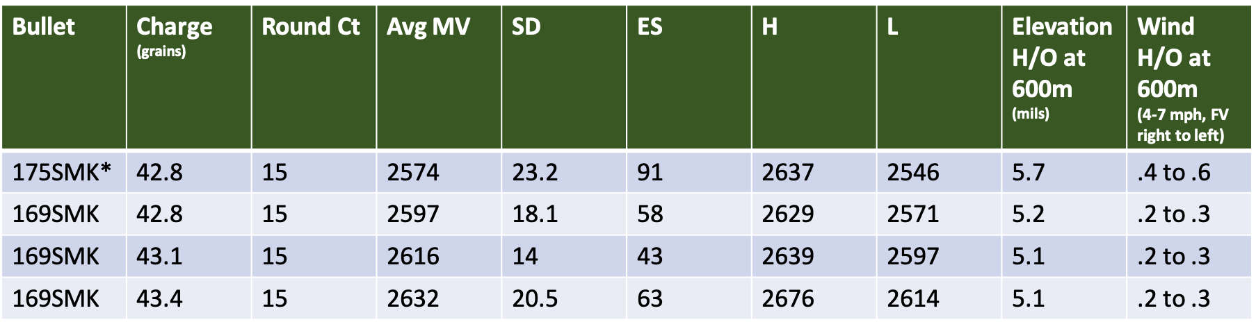

    Testing at 100 meters yielded similar or slightly better group sizes compared to the 175 so the rifle likes the bullet. Here is the OCW w/notations.
    * The cold bore shot with the 175SMK was 2637 fps, which was 36 fps higher than the next fastest round, skewing the SD/ES numbers for that load. Excluding that shot, the SD would have been 15, ES 54 which is more typical.
    At 600m, the 169 was .5 mils flatter and required .2-.3 mils less wind compensation vs the 175. I elected to load up 40 more rounds at 43.1g Varget for additional testing (see below).

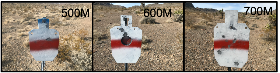

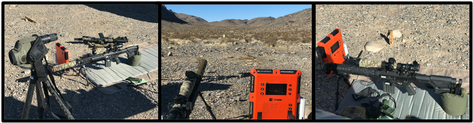

    Shot the same above 43.1g load at multiple targets in 100m increments out to 500m then from there, 50m increments to 700m. Conditions were largely the same as last week, the 169 required between .2mils left and .3 mils left wind hold at 650-700m.
    At 700m, I initially went with 6.2 mils, which resulted in the two low impacts on the target, one at 5:30 near the bottom edge and another at 8:00 left edge. I adjusted up another .2 mils and shot another 5 rounds, which can be seen in/around the water line (yes, my water lines are a bit thick and not entirely straight - going to make/use a card board template to paint them for next time).

    I shoot a Mega Maten in both 6.5CM (22" JP barrel) and 308 (20" Proof steel). I run either KAC or ASC magazines that give me a max COAL of 2.850"
    My AICS magazines (AI# 3902) give me 2.865" max COAL. My AIAX mags (AI# 6677) give me 2.955" max COAL while the AW mags (AI# 0726) that work just fine in my AXSA have 2.965" max COAL.

    What was your base to ogive for 175's at COL 2.800, or 168's at similar overall length? Based on the Hornady OAL gauge and BTO comparator, I believe the difference in bullet profile (and the way it meets the angle of my rifling at the leade) accounts for the 168 SMK touching the lands in my M1A Loaded (.308 Win chamber) at BTO 2.391, but the 169's would touch if seated at BTO 2.361. So that gives me a comparative adjustment of .030" to get a similar jump.PLEASE DISREGARD THESE NUMBERS SEE NEW REPLY JAN 22, 2023.
    Math's not my strong suit, so check me on this, but my GMM clone loads with 168 SMK are seated to COL 2.805 (book length being 2.800) which measures on my BTO comparator at 2.215.
    Using that .030" adjustment to get the same jump, I seated the 169 SMK's to 2.187 BTO (close enough to my goal of 2.185, the last .002 even with a micrometer seating stem would be chasing my tail). SO that puts me at COL 2.841"
    Should I have arrived at this differently? Granted,with what looks like 0.174" of jump, I'm not expecting to get anywhere near the Berger ideal jump of .040" and certainly nowhere near the .020 starting point that Panhandle Precision uses for his custom reamed match rifle.
    I emailed Sierra and the ballistician referred me to the page in the reloading manual for bullets of similar weight, which has still not been updated to include the 169's (and they no longer have the app).
    Have some tests loads ready for my M1A, will advise...
    CBTO at a 2.800 would vary slightly given lot to lot bullet differences but it was generally in the neighborhood of 2.120”. My current 175smk load has a CBTO of 2.150” and feeds reliably from the KAC mags.
