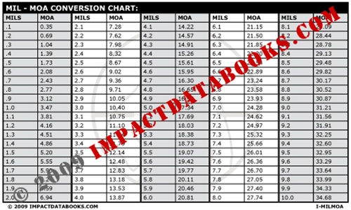

Yea I get that you wouldn't want to take the time with a calculator when trying to call shots for someone, but a printed conversion chart would be helpful like the one from Impact Data Books if I was trying to call shots for someone with a MOA scope I would have one.
I’d call 0.3 mil ~ 1MOA. That math is sufficiently easy. And, you are unlikely to need to call a correction where the difference will matter.
I was given a class handbook during the class, I can't find it, but the more ya'll talk, the more I remember about it. I remember something about .3 mills equaling a MOA or something close to that.
That is correct
1 milliradian subtends 1 yard at 1000 yards. At 100 yards (1000 yds/10) a mil subtends 1/10 yards. 1/10 yards = 3.6 inches (36 inches/10). So one milliradian subtends 3.6 inches per hundred yards.
To see how many minutes of angle a milliradian is equal to, divide 3.6 inches/1.047 inch per MOA = 3.438 MOA
So 1 milliradian = 3.438 MOA, then divide both sides by 3.438 and you get this: 1 MOA = 1 mil / 3.438 MOA/mil = .2908 milliradians.
Since we need clean round numbers to use in the field: 1 MOA = .3 milliradians
