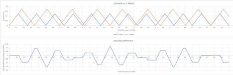

Taken from a mathematical standpoint,
Example: You impact 1.346 MOA right of your POA
1/4 MOA Gets us: 1.346 - 1.250 (5 clicks) = .096 MOA away from POA
.1 MRAD or .344 MOA Gets us: 1.346 - 1.376 (4 clicks) = -.030 MOA away from POA (negative just means we are left of the POA now, but still closer to POA then the 1/4 MOA)
The first graph has POI on the X axis (.002, .004, .006 .. 3 MOA) and the Y axis is how close you can get to the POA, two plots, one for 1/4 MOA and one for .1 MRAD. As we can see (just like the example above) sometimes MRAD is closer to POA then MOA, although not as often. As I calculated it, 1/4 MOA gets you closer ~63% of the time and . 1 MRAD gets you closer ~36% of the time with about a 1% tie.
The second graph plots the difference between how close 1/4 MOA is vs how close .1 MRAD is for each POI of .002, .004, .006 ... 3.0 MOA.
The beginning of the graph where it is flat is because from 0 to .125, neither 1/4 MOA nor .1 MRAD can get any closer then each-other. The parts in this graph above the X axis represent when 1/4 MOA is further from the POA then .1 MRAD. And the parts in this graph below the X axis represent when 1/4 MOA is closer to the POA then .1 MRAD.
The takeaway from the Finer Adjustment debate is: but which one is actually closer to center, the fact one number is different from the other only means you are missing a major component of the debate which cannot be determined correctly on paper. We are assume ballistic solutions are to center, rarely are they off enough to miss if properly trued.
