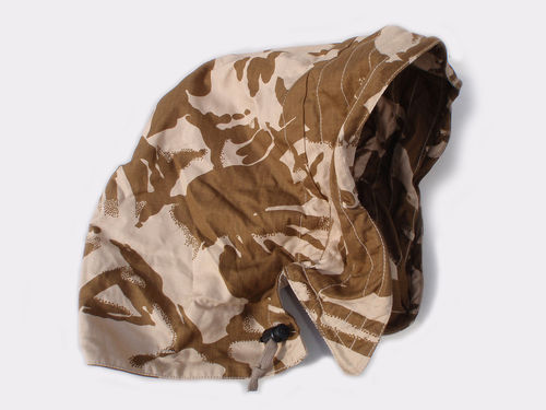

Bought a Brittish desert DPM hood for my ghillie suit project. These have a wire running on the inside of the brim, making it easily moldable to different shapes.
Also the ability of removing the hood when it's not needed is a nice feature, you just have to cut and sew the button holes for your jacket.
Image of one of these hoods (not my ebay page nor am I affiliated with the seller in any way, it just had the best picture of this item):
While the hood is nice and roomy it has a weird pointy tip on the top, easily fixed with a minutes worth of sewing. Also there is a wind/rainproof double lining on the inside that needed to be cut off with scissors. My goal was to keep it cool and light while keeping the structure sturdy. Sewed on some polyester chocolate chip mesh on the inside of the hood for ventilation and for sounds to carry better, then cut the material off from the outside (much easier this way). Used a zigzar/jagged cut for the holes to break up the shape, this also gives you nice "leafy" shapes to sew on the outside later on.
