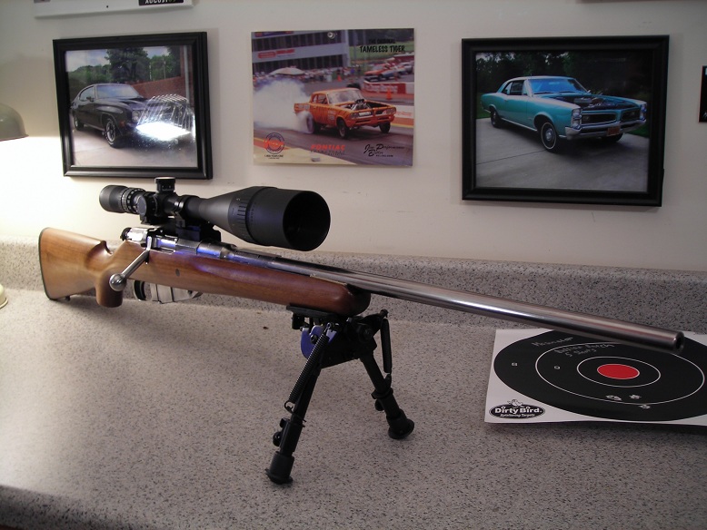

What kind of accuracy are you looking for? That is the big question. As posted above, you will get better accuracy for less money w/ a Rem 700 or Savage. That being said, if you want to do this as a project, that's cool, I have done it before as well.
I did a 24" cut barrel, polished barrel, target crown. bedded stock, Timney trigger, Rock Solid scope mount and a host of other modifications. I can machine parts in my garage, so it was a fun project. I hand load and it has been best of a .750" MOA at 100 yards and 1 MOA out to 400. Everytime I take it to the range, people ask about it and what it is. So it's been a fun project. However, by comparison, my box stock Savage 10 BA is a 1/2 MOA gun at 500 yards with hand loads. So there is no comparison in accuracy.
Just wanted to point out the upside and downside. Have fun if you do move forward!

What scope mount/base is that? All the ones ive seen are forward of the ejection port and not like yours. Is that a bent bolt to mod as well?
It's a Rock Solid Industries mount... they make several bases for the Mosin Nagant. Rock Solid Industries | Dedicated to Precision, Quality, and Strength.
They also have pre-fabbed bent bolt bodies that are drop in. Big Gorilla Gun Works also sells bent bolts, as well as some aftermarket stocks. Mosin Nagant Stocks, Custom Gunstocks for your Mosin Nagant - Home
