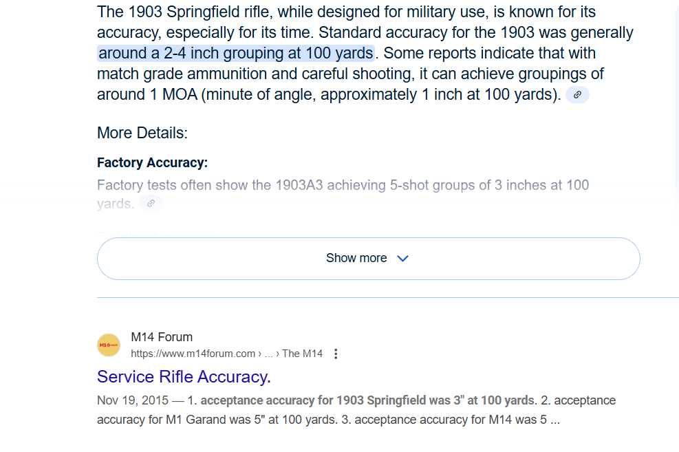

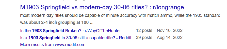

Standard accuracy for the 1903 was generally around a 2-4 inch grouping at 100 yards.

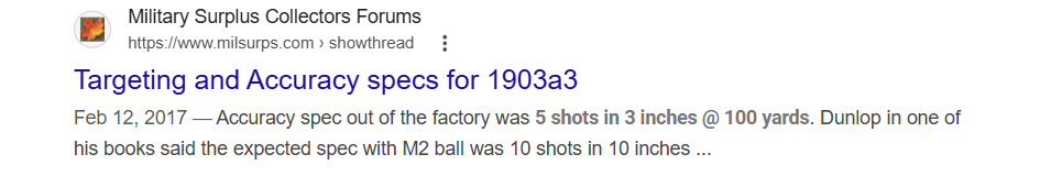

Not sure where your accuracy information comes from but a 1903 is generally much better than that.

3” at 100 as the accuracy standard? I don’t have a period reference book or actual Springfield Armory “requirements” docs handy. But I would expect that the design specifications would be “better”‘than that. Though that may be the expectations for a good rifleman on a range back when issued. Especially with iron sights.

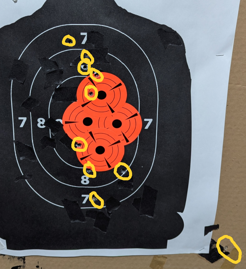

I present a target of the last 10 rounds from today.
Now the first thing you are going to say is why 4 read pasties....Well with the progressives I can see one, but the sight is a blur, I need to start moving my head across the progressive area of the lenses to get the sights in focus, when I do that I loose the target. So in shooting with the progressives, what most of this target is that has been taped I tilt my head back to line up the sights then tilt my head forward to see the target then take the shot. I may go back and forth a time or two, but the results are not very good at all.
So I use my "computer" glasses, they are fixed to about 6' and the sights are nice and clear, but if only one pastie is on the target I can't see it, I can't see two, so I stick up four, and that is a struggle. I think the one in the cardboard is likely the last one as my eyes started to really bother me trying to focus. I had shot a total of 25 rounds today, and by the end I had a hell of a time seeing the target, the sights still nice and clear, but the target, no dice.
I think the vertical string is a by product of that. I need the front sight on something pretty contrasting to pick it up even with the close up glasses, and I just raise till I start to see the orange fuzz of the sticker. When shooting I had a feeling I was not holding in the same place, it just felt off, but I took the shot anyway. I am really thinking this is the issue.
Even sitting here home now and typing this post the letters on the page are a bit fuzzy, I think my eyes are stressed and need a rest, they burn a bit.
So in a nutshell I think with my current eye setup this is where I am. I did ask a question about glasses a bit ago and have an appt with the eye dr in Oct IIRC. I will talk to him then about this issue and if there is anything they can do for me, or if it is what it is with these eyes. I have wore glasses my entire life if that matters.

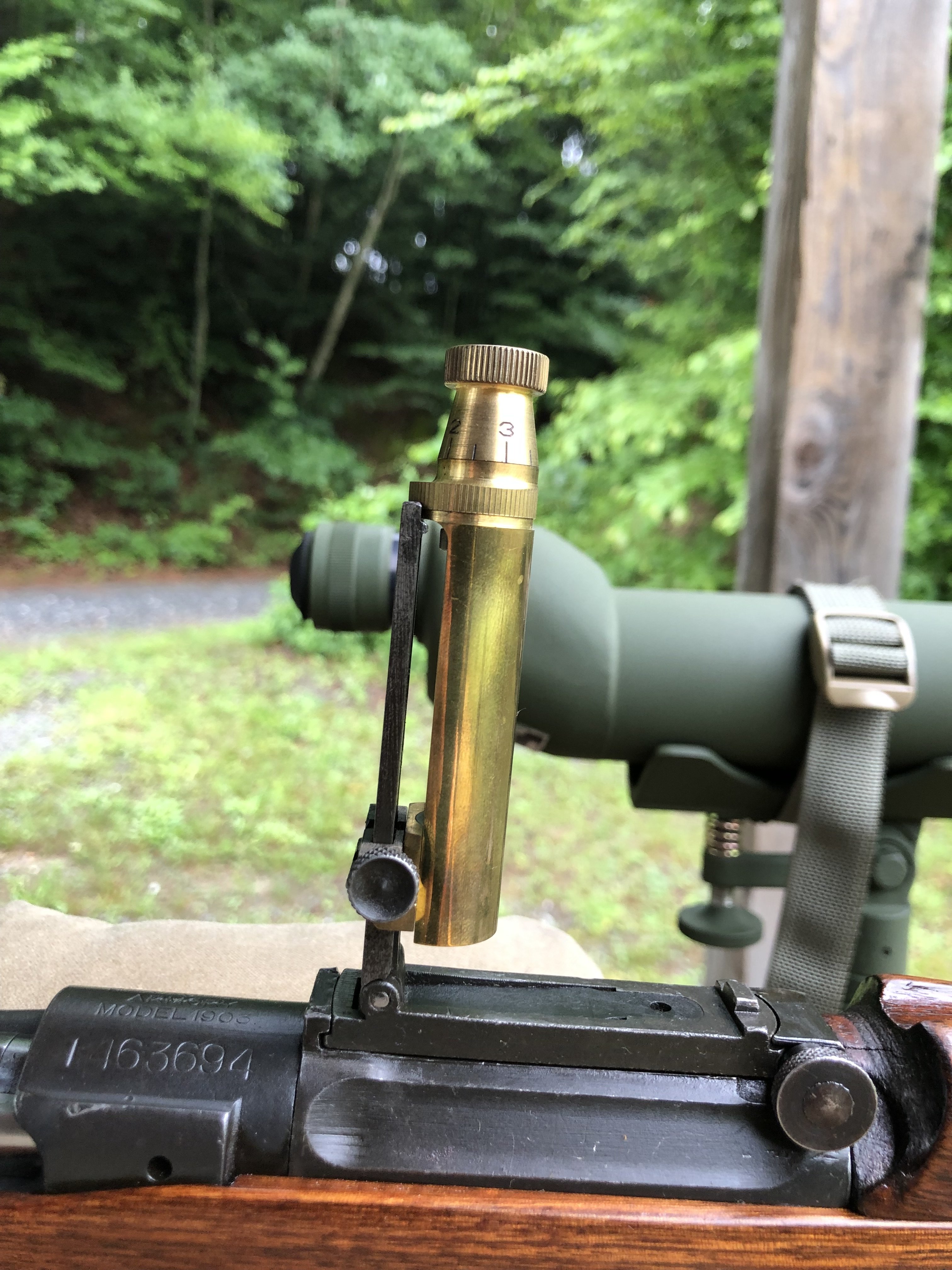

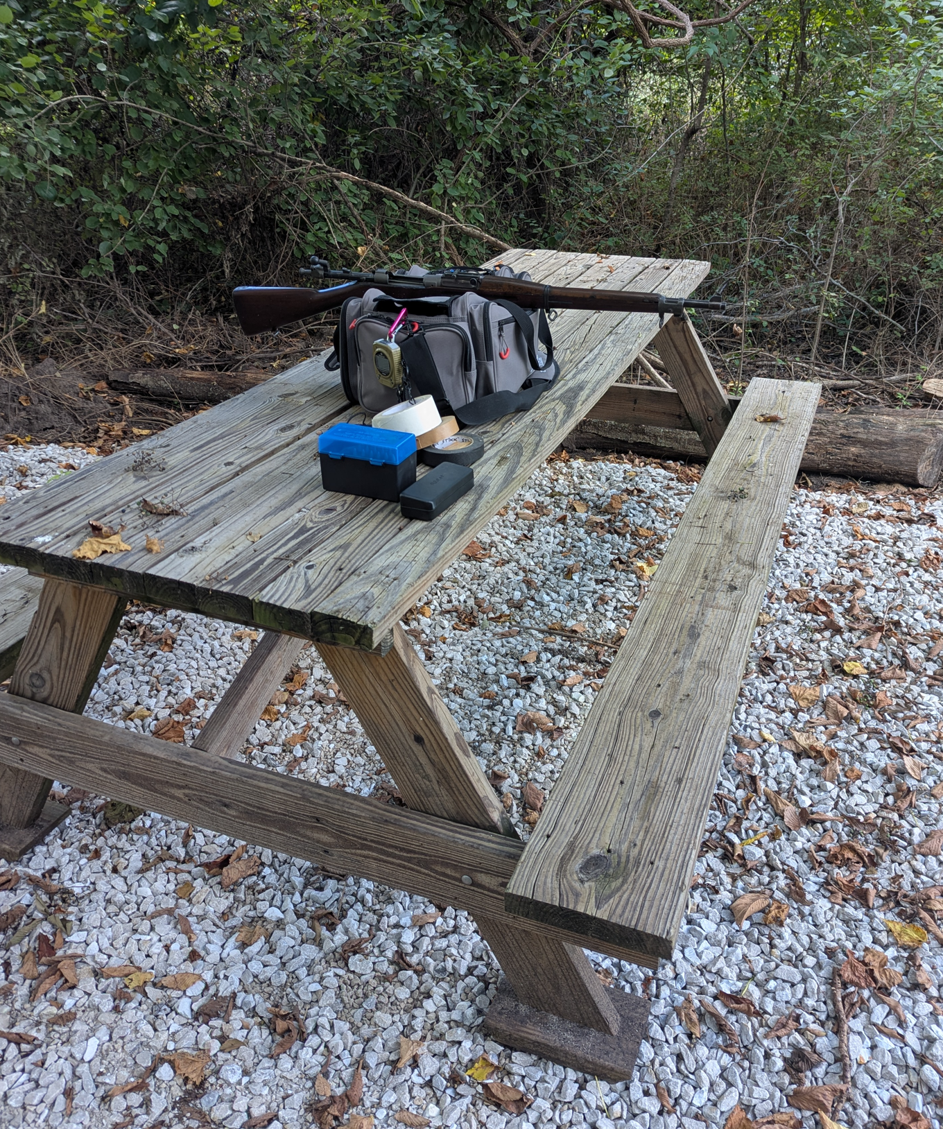

Oh well thats my story and I am sticking to it. For the record this is what I am shooting off of.
