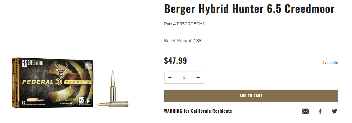

    I thought the federal Berger’s were130
    Box I have says 135???
    The Gold Medals are 130
