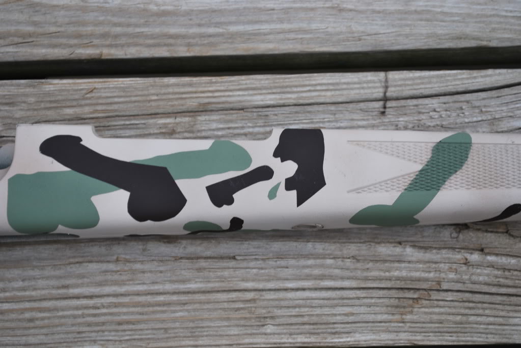

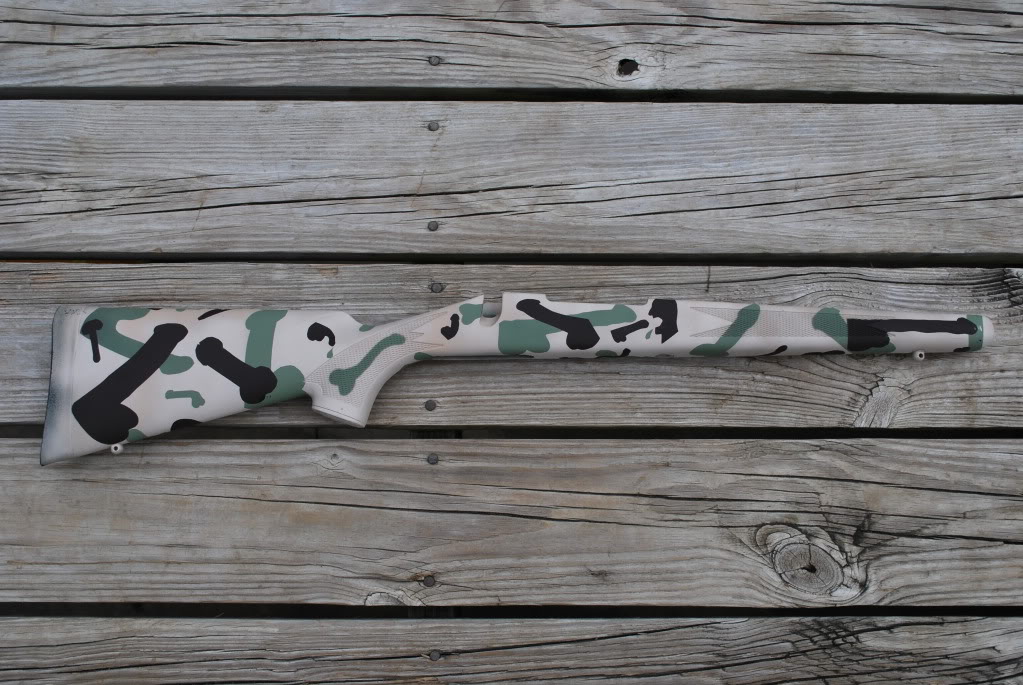

Would you shoot a brake if it was good but was in the shape of a big fat dick? Actually, what am I asking here because I’m sure some guys would opt for the dick brake
That would be the woman's and or lesbian's option. Put a couple rounds down the tube and it would be nice and warm....
Got a nice paint job to match the brake
