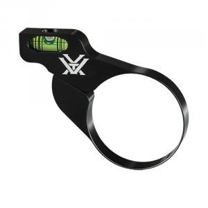

I remounted a Vortex PST 6-24 I had to send in for warranty work on my R700 and decided to add a level. Scope is mounted and set using a natural prone hold (a slight cant in the weapon system to properly fit my shoulder pocket) and the scope reticle is leveled using a plumb line at 100yds. I added a Vortex slim profile bubble level and am having a hell of a time getting it plumb to the reticle. Every time I get it set just right and start to torque the level to specs it pulls/bends/flexes just enough to pull quarter bubble. So I back it off, bump it around the housing a smidge and retighten. Now its off the other way. Back and forth, trial and error and an endless exercise in frustration. Finally quit once I had bubble between the lines when the reticle is plumb, but it is not centered. Does anyone have some tips/tricks to getting an add on level plumb to the reticle? On a side note I got so pissed I was looking at NF unimount and adding a level ring. Are there other manufacturers of rings with built in levels I should be looking at also in case I shitcan that Vortex bubble level?

Are you alternately tightening the screws (about 1/4-1/2 turn at a time) or tightening one side, then the other?
If you don't alternate them, the mount will turn just a bit as you tighten

^^^^ Do this. that is the only way to keep it from moving on you.

@ Blowby. This is a 30mm tube mounted level. @ Mike. It only has one set screw since its the low profile Vortex level and not the traditional two screw mounted clamping ring. I will see if I can get a pic to post. @ BearNaked, good to know. Not sure how a tube mounted ring could dork up tracking unless I'm really crushing it and egging the tube. I don't see that happening with this low profile bubble since its more of a band on the bottom half.
The curse of the impulse buy. I'm thinking the design on this type of level isn't worth it. Was at local big box store picking up some cleaning itmes and saw the level and thought to myself, "self, you need one of those since you have money burning a hole in your pocket and it will make you super cool and cure all your long range precision problems."

So it sounds like you will have to treat it like the original Weaver steel and aluminum rings of old.
They were and still are notorious for making the scope turn as they are snugged up.
The trick is to figure out how much it rotates, and then compensate for that amount before you begin the torque process.
Lots of fun to be had...
Well, The bubble is between the lines but not perfectly centered now. I'll just leave it until I get a better design for a level and upgrade it. I don't think its worth the hassle or time trying to perfect it when its going to move every time I torque it down. I followed Frank's advice and video on getting the reticle plumb while shouldering the rifle in a comfortable hold. Figured I would add a level as a check to make sure I'm keeping the reticle plumb. Back to my question regarding scope rings and mounts with integrated leves into the base or rings are there other recommended manufacturers besides NF? They are the only ones I'm finding while searching. Thanks to all who took the time to respond.

I agree. I don't think it's necessary to have it perfect. Here's what I did with same type of level once...before I got different style. I just made a reference mark with black paint pen on the right side of the bubble when rifle was level. So, when shooting, I would just look up at my bubble and make sure right edge of bubble was hard against MY OWN LINE. I actually think I held the gun more consistent that way because I had a hard line reference, not just getting bubble to float between two lines. Now that I think about it more, should have just left it alone...but that's not In my nature! Most of us on this site are probably that way....Try to improve it or tweak it to make it better until we break it and then we known everything about how something works! Good luck.
Yeah, it doesn't have to be perfect. Your brains internal level will do most of the work for you. The bubble is more of a quick reference if your shooting position is off-camber or you're into terrain with no horizion. A lot of folks will set it up to be one one of the lines vs. trying to center it in the middle.
