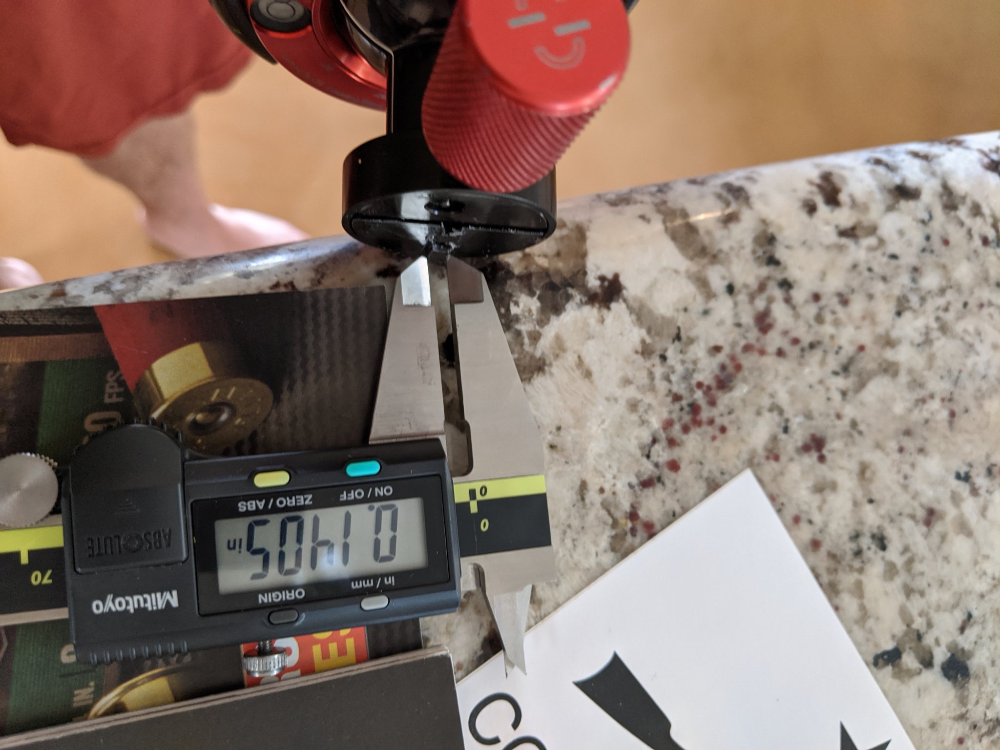

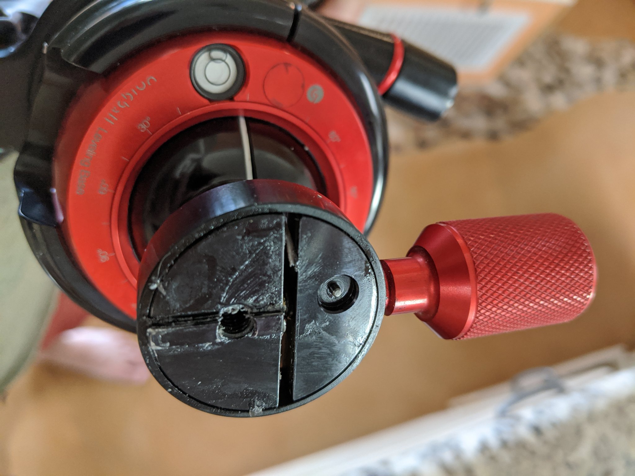

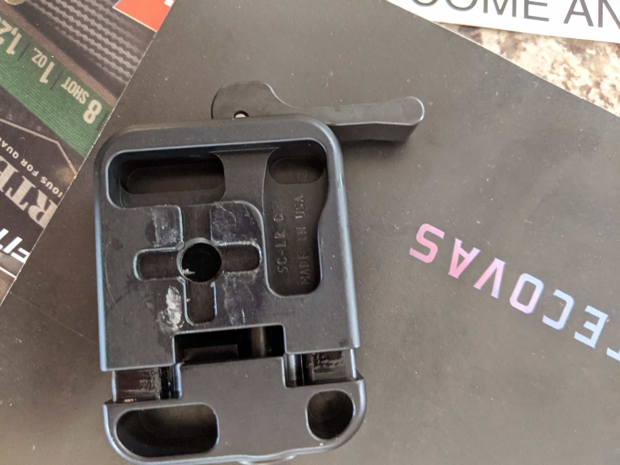

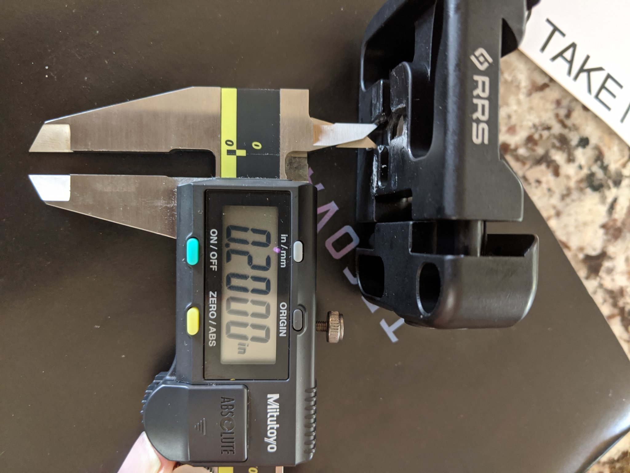

The problem I'm encountering is getting it properly mated to my Uniqball Ballhead (I know, different manufacturers). The problem I'm having is that the "anti-slip" slots (for lack of a better word), are not the same diameter. This allows the clamp to turn slightly side to side when putting any torque on it, or swiveling the rifle + ballhead on the horizontal plane.
Uniqball Ballhead:
RRS SC-LR clamp:
You can see the "key" on the Uniqball head is about ~0.060" thinner then the slot on the RRS clamp.
Any ideas on what the best way to remedy this is? I'm sure there's an easy fix, curious to hear your ideas. I want the make this combo work as I love it (aside from the slipping).
