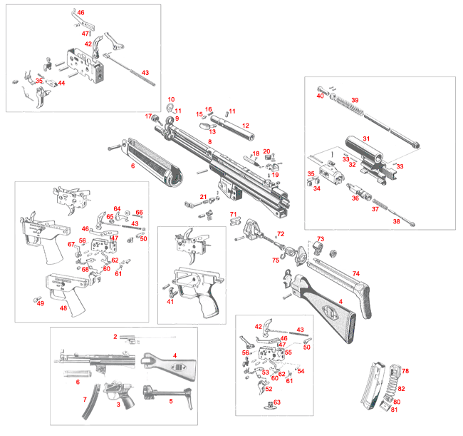

Ok, you seem to be pretty well knowledgeable on the MP5/94 guns..........would it hurt anything for me to put the bolt and trigger assembly in my sonic cleaner?
I use 50/50 Simple green and tap water............put it in a baggie and float it in the sonic cleaner.............works good on AR and AI bolts..........
I'm not sure this gun has been cleaned since my brother bought it..............took it apart today and it is filthy.................
I can't see that hurting the bolt carrier. I have never had to clean the trigger so I can't say.
I clean my AI triggers by flushing them with lighter fluid but that is once in a blue moon.
... would it hurt anything for me to put the bolt and trigger assembly in my sonic cleaner?
I have a three-digit MP5 SBR conversion originally sold as an HK94 as well. It has the original HK94 stamping on the receiver.
The Form 4 and NFA Registry says it is an MP5 SBR.
Simple Green and water make a good-fair solvent -- just be sure to rinse it off thoroughly and lube. As stated above, something like mineral spirits (available at a hardware store) are a good cleaner (they will generally evaporate and dry off quicker).
Once you've removed the trigger pack from the grip frame there aren't any plastic pieces. The buffers on the ends of the recoil spring assembly and in the butt cap don't do well over time when exposed to petro-chemicals.
