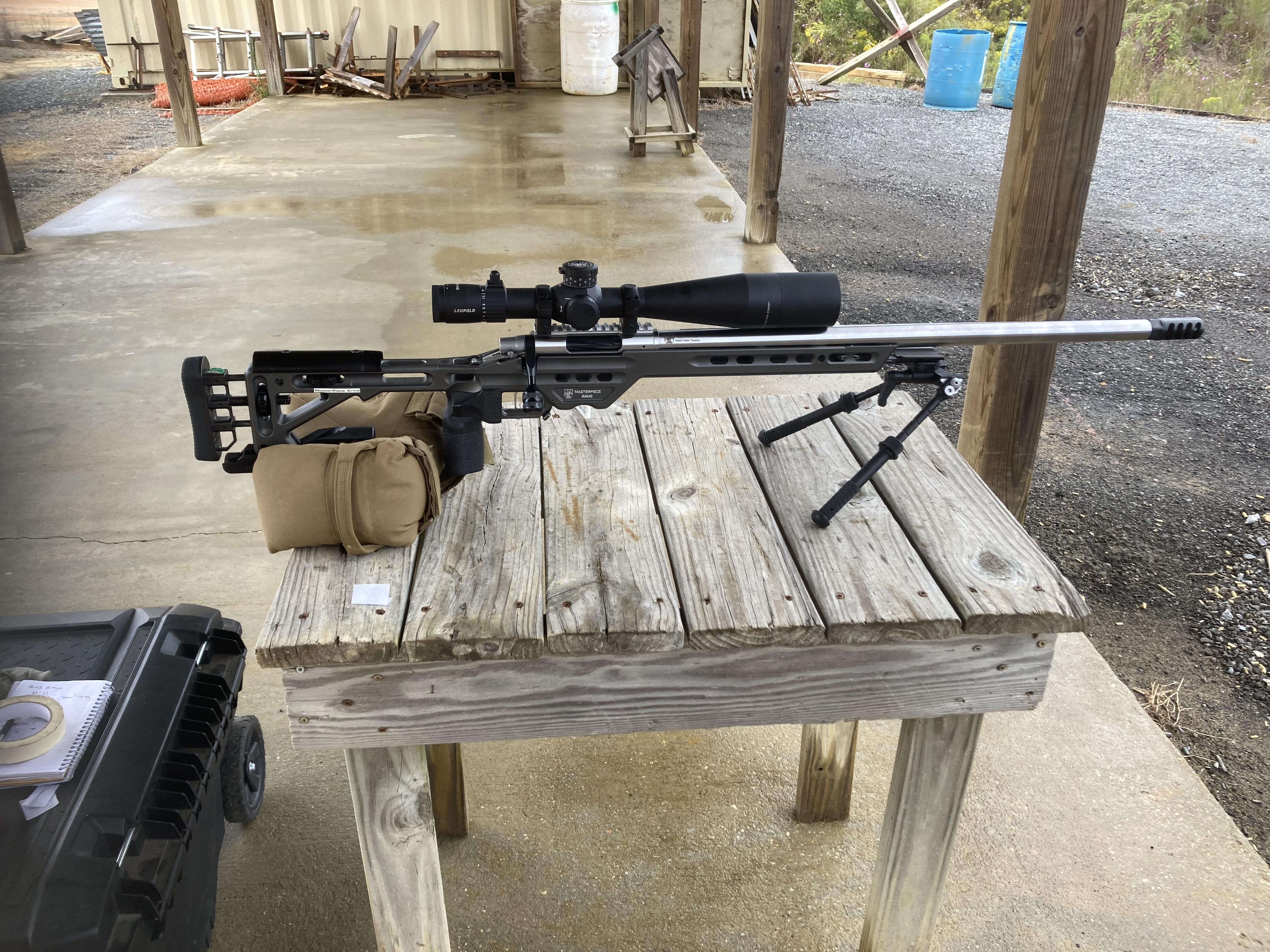

Its a little tight, I can get card stock between the barrel and the top of the bridge but I dont know if its enough. I'm thinking of getting some gasket material from Napa in the morning to make shims. Eventually the rifle will be rebarreled when I kill the current barrel. Gasket material shims be good enough to get me some clearance and keep the bridge steady enough when I use a friends gear?
I’d personally shim it. Guys had issues running straight 1.250 barrels in ATX rifles. They fit but flexed and contacted the bridge when fired. Better safe than sorry.
Barrels are like a tuning fork and flex more than one thinks

Here's what I use ...
Your kidding... Thats, uhm irritating.....
Not sure ... but probably.
Yes, I think they are 3D printed. Could definitely be cheaper. I bought the first set expecting metal. When I realized they were printed, I made my next set.
That being said, these spacers do give more room, especially if you have a QC action and attempt to use 1.25" barrels.
I talked to Woody. he said the chassis would be fine if I left the bridge off. So I did. Rifle shoots fine. (When the nut behind the trigger does his job).
Your missing night time coyote hunting in your pic. Don't currently own clip on but have access to and future plans for clip ons.
