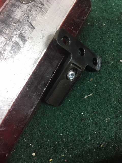

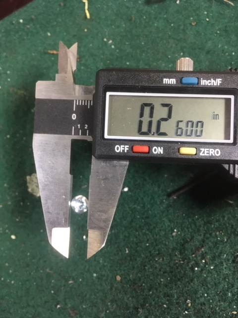

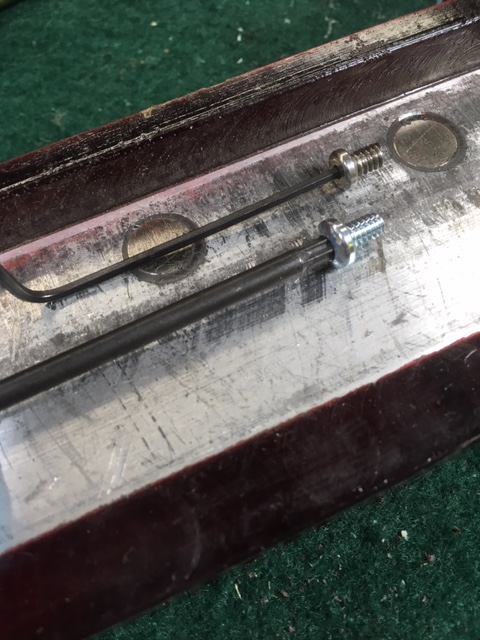

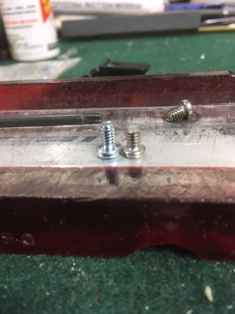

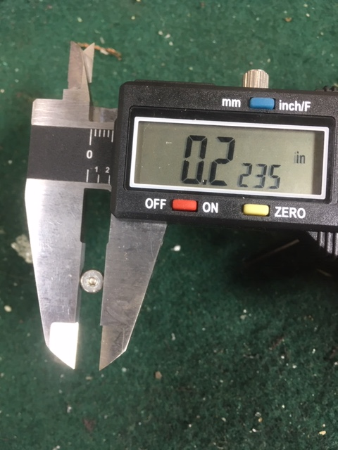

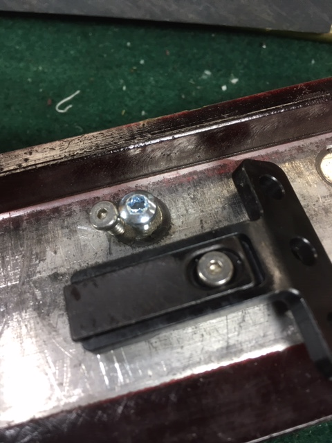

Here is what I did to fix the issue. The original screw is stainless, not good, and the Allen size I believe is 1.5mm, also not good. The modified screw is a T15 Torx. Compare the purchase between to two screws not to mention the harder material in the steel screw.
Original screw is 0.233" diameter, slot in mag catch is 0.230"
New hardened steel screw is a diameter of 0.260"
And a slight bit longer.
So I place screw in drill, turn down outside diameter, and then thread screw into jig and grind down. I can now use a T15 Torx instead of a 1.5mm Allen. I can now crank down on the screw and problem solved.
If I get some interest in replacement screws I can run a batch of these and ship them out to other members who have this chassis. PM me if U are in need of a screw and I will help wherever I can. I have performed this fix on several other MPA chassis. How do I spell plural chassis? Chassises? Cheers.
