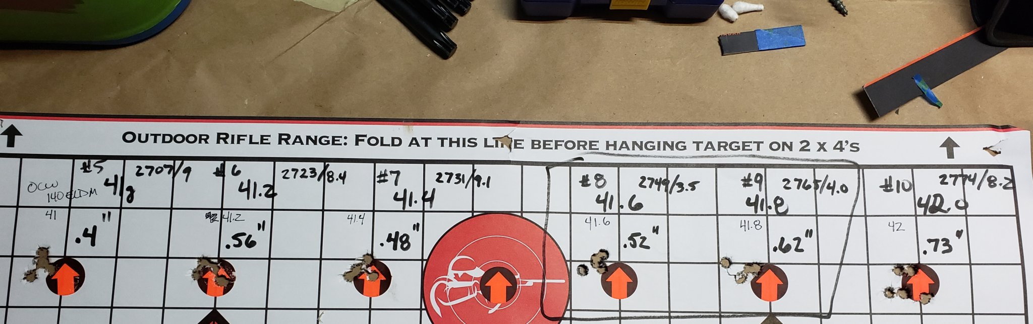

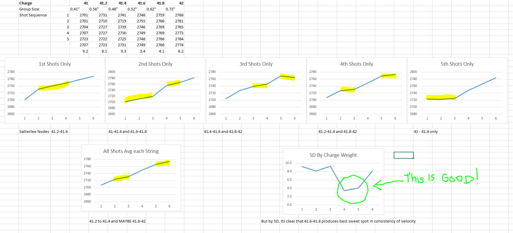

Here is a picture of a multishot/OCW style test with a new Bartlein 26" 6.5CM barrel chambered by Area 419, 140 ELDMs, Hornady brass 4th fire, BR2 primers, (40 rounds through barrel when test began) :
Here is the data if you look at like running 5 Satterlee tests with the same charges. Notice that each String (like running a new Satterlee test) shows different results. I've hightlighted the areas that would called nodes using this method, but its different or ambiguous for each new sequence. But if you simply use the SD for each charge weight, the decision is Simple and easy: between 41.6-41.8gr.

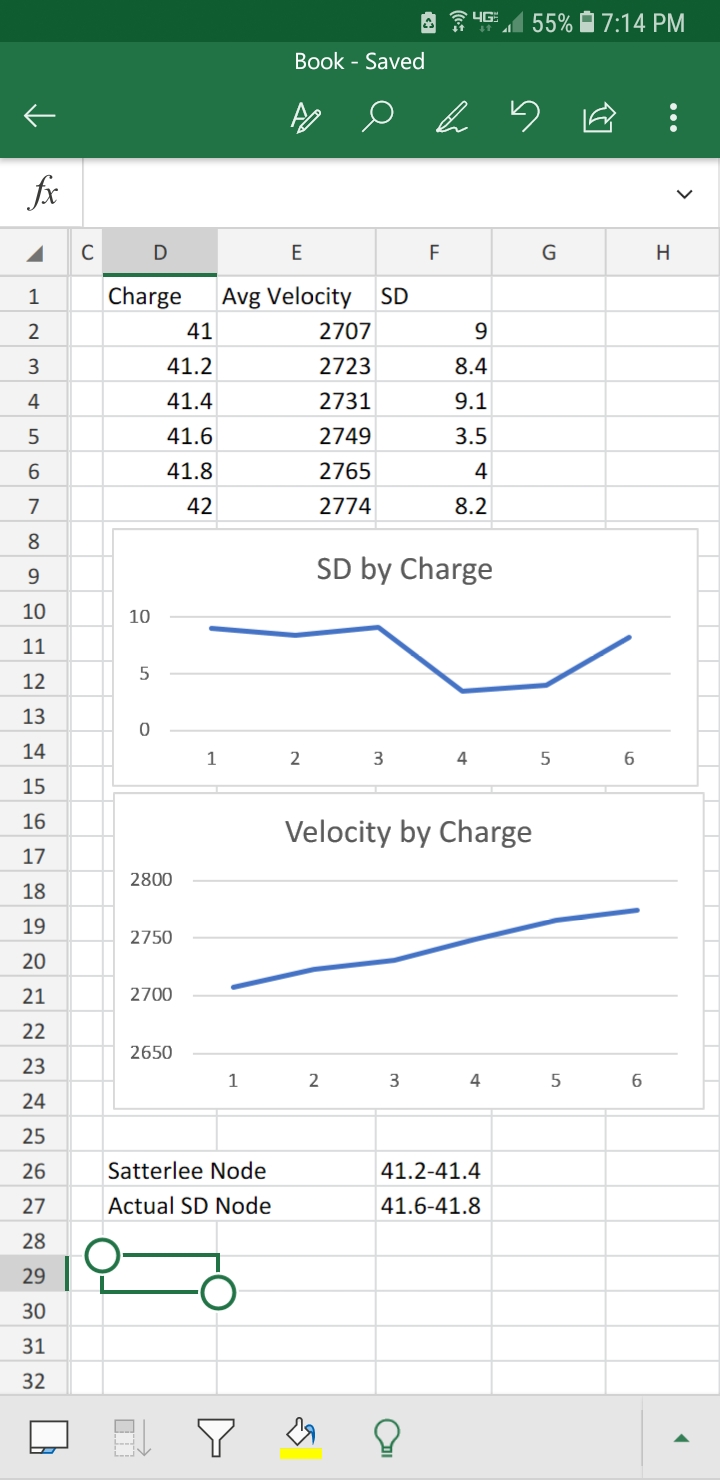

I logged the data averages into Excel to get this set of graphs:
To be clear, the data in the charts is not a Satterlee plot, it's the avg of 5 shots per charge, which means the velocity listed per charge has MUCH higher confidence than if I simply used one or two shots each.
The upper graph is looking at SD by Charge weight and the lower is velocity by charge weight (AKA Satterlee Method).
If I used Satterlee Method: I would have fired 10 rounds to find my node for future work up, I would have tested 41.1-41.5 at .1gr intervals with 5 rounds each (another 25 rounds following the results from above). Then I would need to test seating depth at best SD/group from above (another 5 rounds each +-.010 increments; about 25-30 rounds). Total rounds needed to find load: 35 without changing seating depth and 60-65 with seating depth test.
BUT I would have been testing the wrong node and ignored a series of charges that would have reduced my SD by +50%! I would never know it existed if I didn't fire more rounds to begin with!

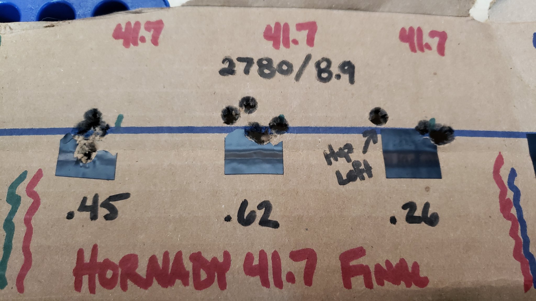

Now using the OCW like method (this is not an OCW exactly; that would evaluate relative POI by charge weight): I fired 5 round groups at .2gr charge increments (30 rounds total) and have the following results from 30 rounds: an average velocity for charges that is reliable, avg group size by charge, POI shift by charge, plus most importantly: SD for each charge. I can say with confidence that any load with 41.6,41.7, or 41.8 should have an SD around 3-5fps, velocity between 2749 - 2765 and produce groups of about .5-.6 or better. If I feel I need to decrease group sizes, I could then test seating depth (another 25-30 rounds) and be done.
Essentially, I've gotten to the same round count with both methods but I have better data shot in the same conditions, and best of all, I don't have any doubt that I've picked the best node possible.
Some might wonder why not choose 41gr as it's the smallest group and SD is still single digits. Simple: all of my "5th shot fliers/misses" are left which indicates is probably me. I was having difficulty with NPA shifting during string and my common miss is left. But the other 4 shots tell me 41.6 is capable of .3" and 41.8 is capable of .4" with practice.
So in summary, both methods will require a minimum of about 30 shots to develop a load, but any method with more shots per charge will at least let you make the right choice with better data more confidently and more quickly with fewer range trips. If you don't know the cartridge or bullet well, you might not shoot some of the loads due to pressure, but you will have good data for rest.
Edited: updated with all data and comparison as if running 5 separate Saterlee tests to check reliability of data/results.

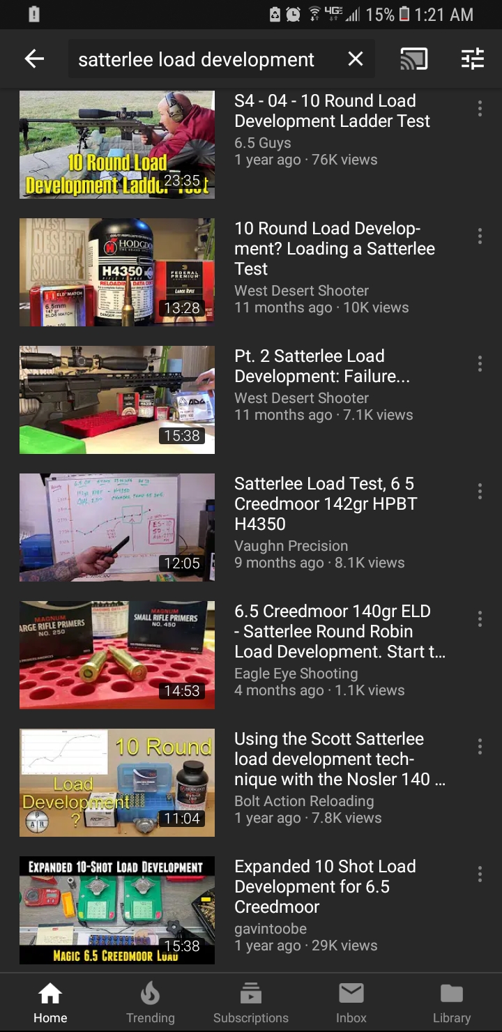

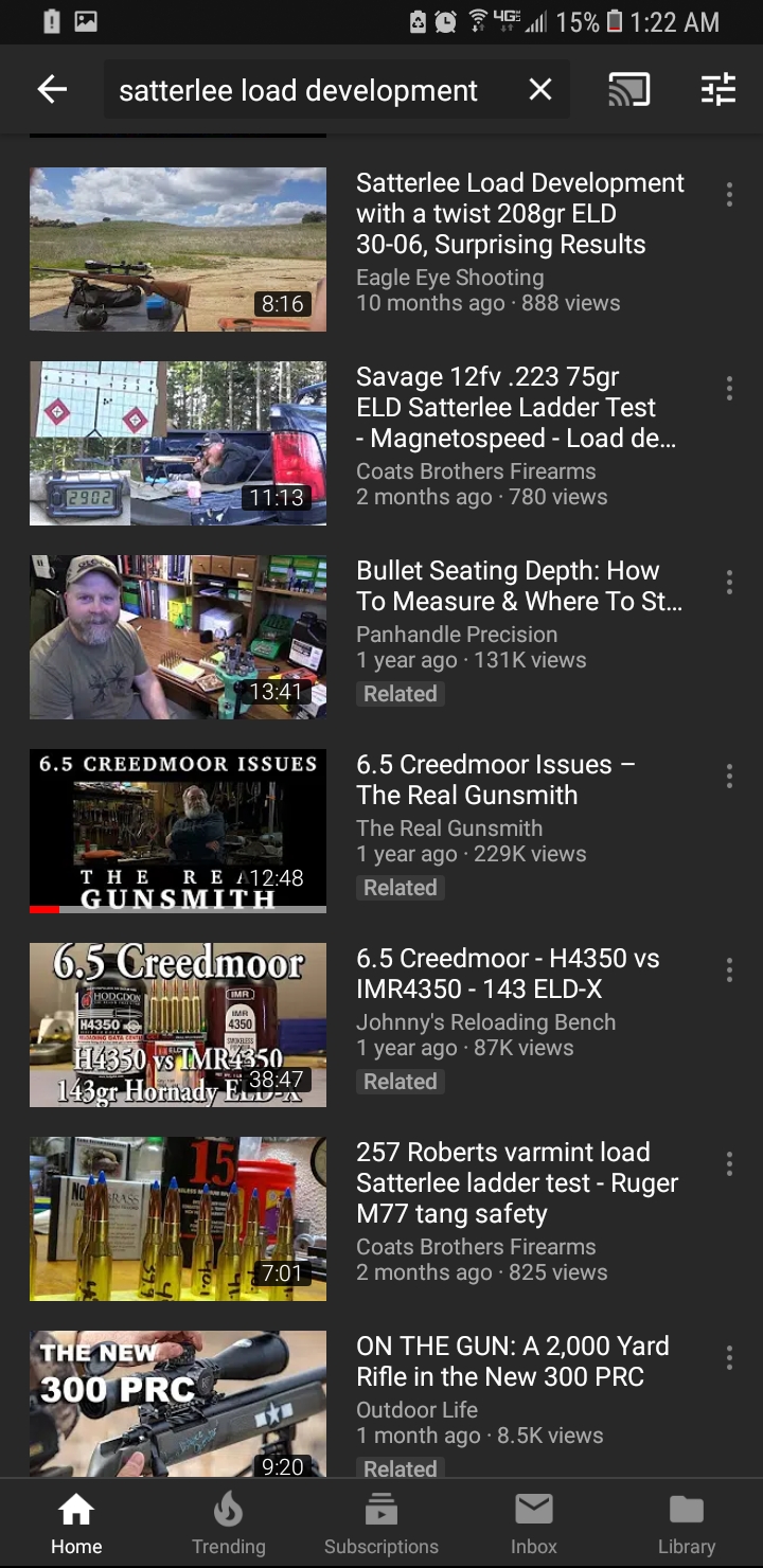

I think it's mainly because of the 6.5 Guys videos. When they were super popular a few years back (not that they aren't now for some), they interviewed Scott and discussed his method in some detail. They then used it in a series of load development videos and tests.
Fast forward to present and a quick YouTube search produces a metric ton of videos with "Satterlee" in the title along with some variation on load development. See:

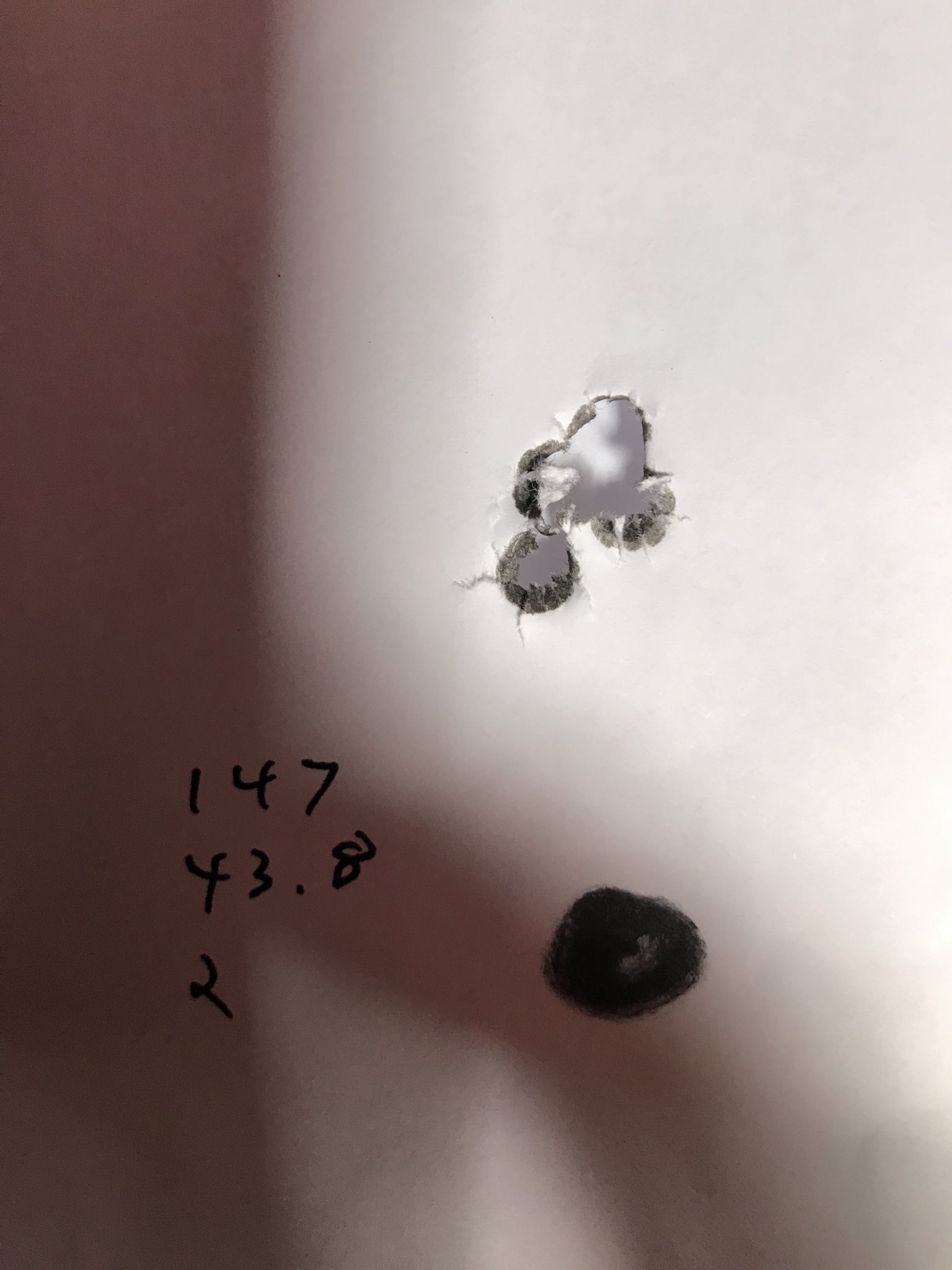

Basically, Scott is using heavy bullets (147's in the video) for the 6.5 Addiction (Sweedmoor), slow for caliber powders (H4831 burn rate), and loading them 0.010" off the lands. The flat spots he sees and uses are within 1% of max charge or exceed max charge, and are a natural result of the load reaching the point of diminishing returns.
These are the missing elements that noobs don't understand.

So I've thought about it some more and this is what I'm thinking. I have a good idea where i should be with the powder/bullet combo I'm using, so I'm going to run a fine "satterlee ladder" of about 8-10 rounds over my expected node. Mainly to check for pressure, but also to get basic velocity data. Then I'm going to do a 4-5 round ocw without the magnetospeed and see if i get the same answer both ways. Then I'll pick a load and shoot a five round group and run five more with the magnetospeed to check sd/es. That would be 50-70 rounds, more if i need/want to mess with seating depth. I'll try to stay around 50, hopefully that will give me a good load.

The funny thing is the 6.5 Guys created a spreadsheet that uses 3, 4 or 5 shot groups that tracks SD and graphs it relative to other charges specifically to find good SD nodes. They very much use statistics to their advantage.
I've done the above with my own tests and it was 50/50 at best. It's just not enough data to make conclusions.
My idea was to shoot 3 or 5 shots for each charge weight leading up to a max charge, then find the cumulative SD of three successive charge weights. Something like this
45.0-46.0gr total test spread, 3 or 5 shots each 0.1 grain increment
SD of 45.0, 45.1, 45.2
SD of 45.1, 45.2, 45.3
Repeating this pattern to the max charge.
If an “SD Node” existed I would think this would identify it by singling out a median charge of a charge range which is velocity insensitive.
I’d be curious to see if this would be an effective method. Once I have a few more rounds through my Sako I may try it out.

Had a chance to retest 41.7 with same brass from original test today. 41.7 is right in the middle of the good SD node found in OP. (3) 5 shot groups, working on body position to fix a left miss with 10 min between groups. 25deg, 40mph winds (I was a bit sheltered though) and snow. 15 shots chronoed:
POA is top right corner of black electrical tape (the green vertical line and blue intersection. Avg groups is ~.4" for 5 shots. But even after barrel is 25fps faster, it's still shooting tiny holes at the same node as before. I'm fighting setup/recoil control issues which is shifting misses to the left (right should angled to rear, stock slights right, muzzle goes left, miss left) but managed to pull it together for the last group hitting exact POA 4 out of 5.
With known POA/POI, SD and velocity confirmed multiple times, this load is ready for matches.

So this thread kinda inspired me to try the ten shot method with my relatively new Shilen prefit in 260 rem with 147 ELD-M’s with 4451.
Loaded 10 rounds in .2 increments stopping at 44.1 in my roomy Winchester brass.
Started a.040 jump.
Found a velocity flat spot from 43.7 to 43.9.
As I’m new to this method I tried 1 round each at 43.6 and 44 and found 43.6 jives with the flat spot and 44 was just slightly ramping up in speed
I then picked 43.8 did a seating test in .020 increments.
Yesterday I shot two 5 shot groups with charges thrown with my hornandy electronic powder measure with the chrony and got this.
147 43.8 4451 #200 2.30 base to ogive.
2780 avg 10 sd 24 es
2779 avg 4 sd 11 es
7049522
Zero’d scope and shot this.
7049525
I’m totally satisfied with that.

I am glad you are satisfied with your results, I would be also. But you need to understand that when you look at this from a statistics standpoint then the reasoning doesn't hold up. You didn't post your numbers so I can only make up numbers but if you look at your ES of 24, you could have the following:
10 shot avg:
43.5 2750
43.7 2770
43.9 2790
44.1 2810
If you do a 1 shot test and assume a possible ES of 24 (+-12) we can come up with the following:
43.5 2738 (-12)
43.7 2782 (+12)
43.9 2778 (-12)
44.1 2822 (+12)
this would look like a flat spot at 43.7-43.9 but in reality, the avg velocity changed the same amount for each .2 grain increment. Now the probability of having -12,+12,-12,+12 is low but you are still going to have a super low confidence interval for the results of a 1 shot per charge saterlee test.
I mean you can literally see the problem with this in a pair of 5 shot groups. You have a difference of 6 fps SD and 13 fps ES and you had a sample size of 5 for each group, now think about how inconsistent it would be when you use 1 shot and assume it is the avg for the population for that powder charge.
