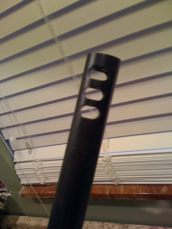

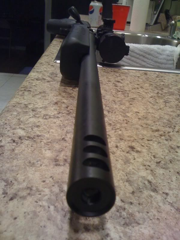

    I purchased a holland style brake from hide member Ross (username RWS), for $40. He will answer emails the same day and shipped my brake to my specs the same day. I ordered one with a 1/8 inch cantaliver that covers a 308 crush washer that I ordered from Brownell for less than $4. That way I did not have to pay a smith to time it. Works great. I don't know how to post pics but you can go to the link below to see pictures.
    http://www.snipershide.com/forum/ubbthreads.php?ubb=showflat&Number=1302004&nt=4&page=1
