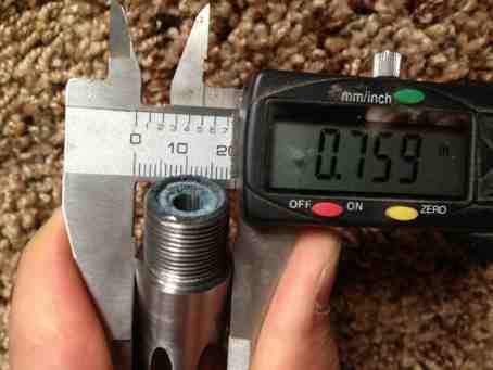

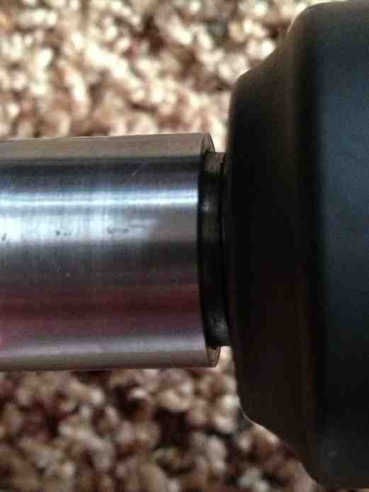

    [MENTION=6264]xdeano[/MENTION] This is 5/8-24 thread on a .750 barrel and a TBAC 30P-1. There isn't much of a shoulder but it works and is repeatable.
