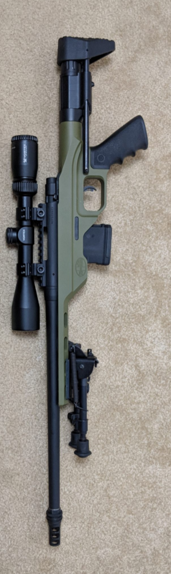

Another project I've been working on. It's a 16" 300BLK Mossberg MVP LC this gun will be run suppressed primary, the top photo is the most recent, before I had photos with high optic mounts. Finally replaced them with low profile mounts.
Rifle: Originally a Mossberg 5.56 MVP LC.
Optic: Vortex Crossfire 2
Modifications: 30 cal button rifled barrel blank with a 300BLK chamber cur into it. Currently 1:10 twist. Had a new bolt head made and pushed the ejector out to help with ejection.
Modifications to come:
Most likely will make my own barrel again. Going to go with a hammer forged, 1:7 twist, cut chamber, with a proprietary coating as well as closing the bore up by about .0001 near the muzzle.
If there's an interest in barrels or bolt heads let me know.
