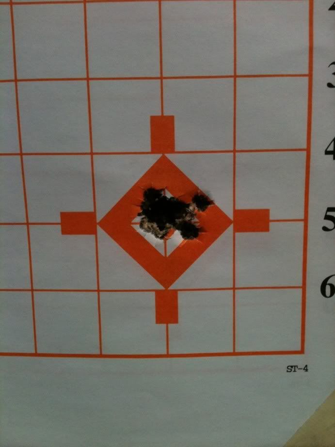

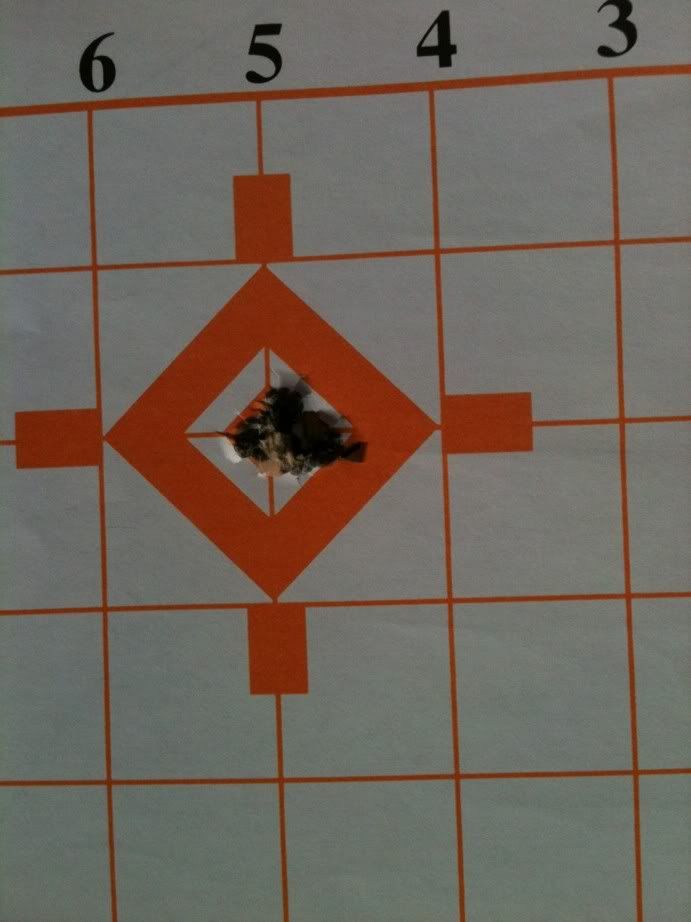

Well, I got her already by Friday night, and shot her on Saturday morning. The rifle performed as good as I expected with me doing the shooting. I used Hornady factory 140 Amax loaded ammo. At $25.00 a box for 6.5 ammo, I think I will just continue to buy it, considering the results. This will surely be one of my favorite rifles to shoot. It's the newest, but it might need a barrel before the others. Below, as promised above, I have posted what videos I took as I went along. Sorry that I didn't capture every bit of it, but there were circumstances along the way that didn't permit it.
First the test targets. This one is of a five shot group at 100 yards
This one is a twenty shot group without a lot of care
This is me messing around with the turrets on the scope between shots. Notice the center above the diamond, it has 5 shots in it
This last one is a 10 shot group fired as fast as I could, and still making it count, what a nice muzzle break!!!
