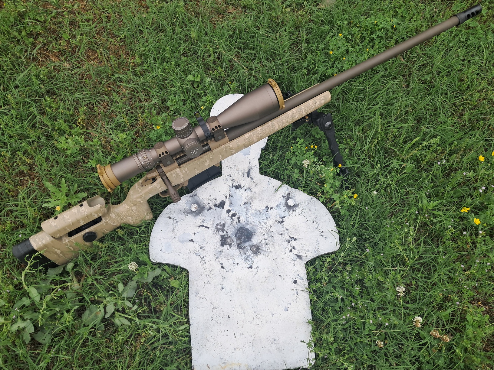

I've started down the path to putting together my own hobby-level ELR/long range hunting/just messing around rifle. Why? Because I got a small case of "the envys" when I got to do load development for my buddy's 300NM. However, I'll admit it right off the bat that I wanted a tad less recoil and was willing to trade 20% less barrel life for 20% less recoil with similar ballistic performance. There, you can have my man card.

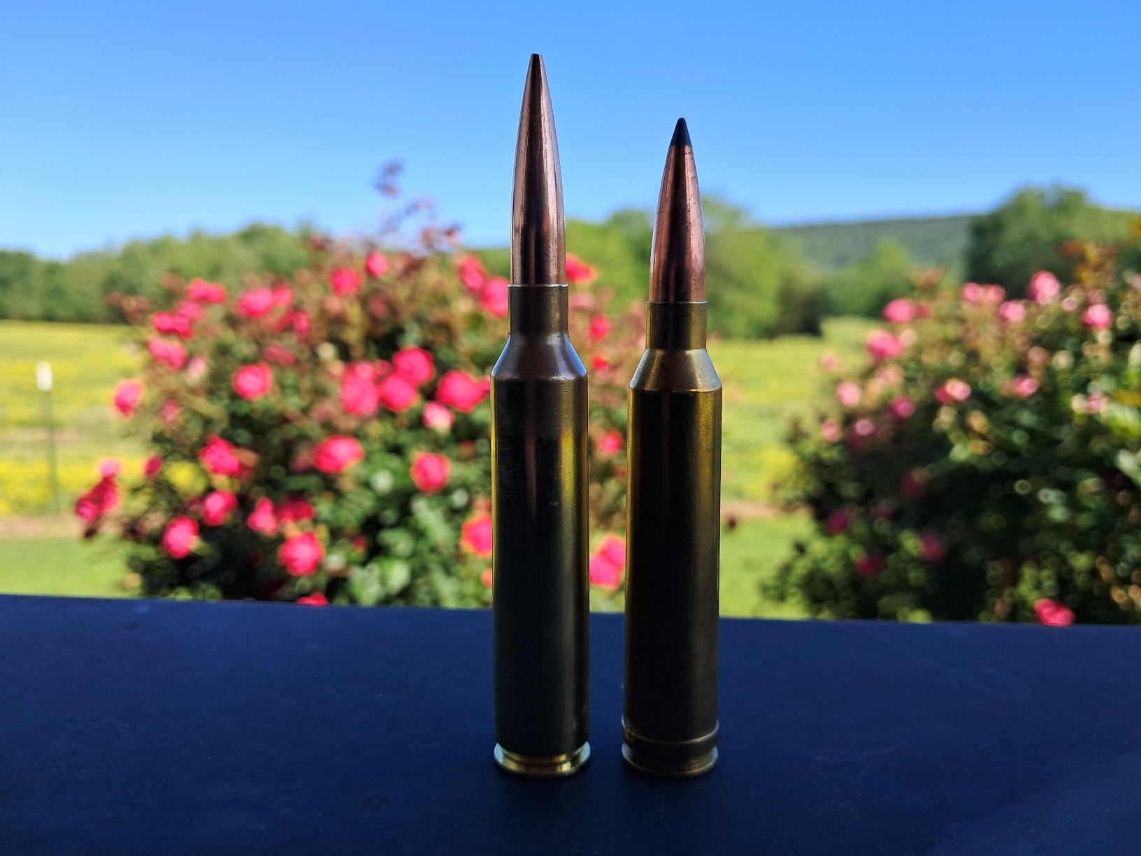

I chose the 7-300 because quality 300 PRC brass is plentiful. There is some difference between it and the 28 Nosler, but not a whole lot...and I wanted access to more brass offerings. And I didn't want the length of the RUM case or to open my bolt face up for the Norma Mag.
(7-300 / 195 Berger Vs. 7RM /150 ABLR)
I went with the Manson 7-300 PRC M2 reamer because it has a generous .225 freebore, allowing me to load long, and a .319 neck, negating my having to neck turn (.313 loaded). Perhaps other reamers are similar here, to be honest I didn't really look much further after stumbling across the Manson.
My minimum goal was 3K FPS and 2/3 MOA accuracy. Of course, I'll always settle for better than that. I know that some guys claim to hit 3K FPS with the 7RM and PRC and a 190+ bullet. I don't doubt that it might be possible, but I didn't want to live at 70K PSI pressure either.

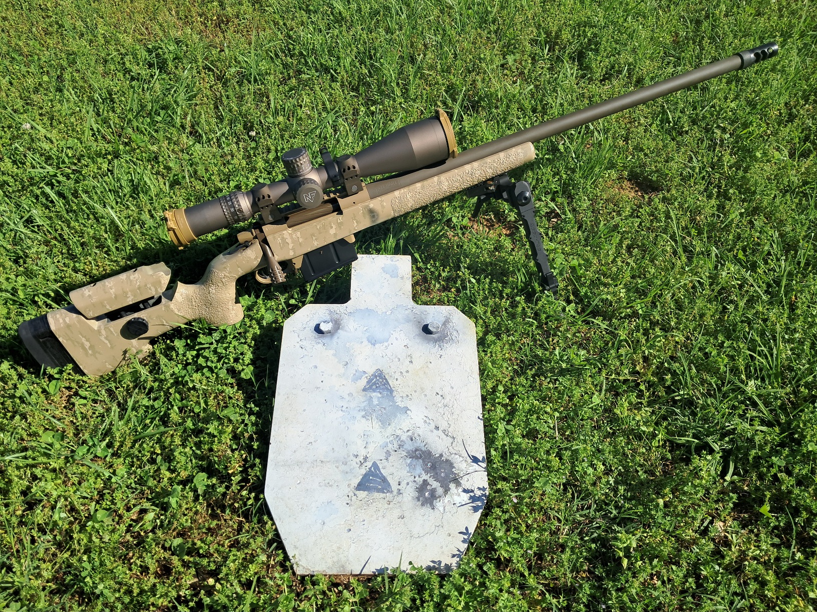

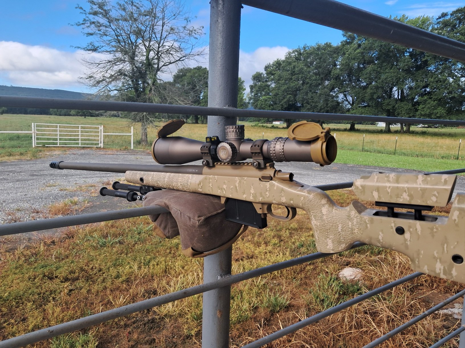

Barrel is a Bartlein, 1:8, heavy palma, that I had cut to 27". Any longer wouldn't fit in any of my safes with the Area 419 Hellfire attached.
** Here is where I handicapped myself a bit **
-Rifle is built on an older 1086 Surgeon that was originally in .300WM. That thing feeds and shoots beautifully in its WM version. I'm going to have to mess with it in 7-300 configuration, as right now it is a single-feed rifle. The 195gr Berger at .035 off is measuring 2.945 CBTO or right at 3.700 OAL.

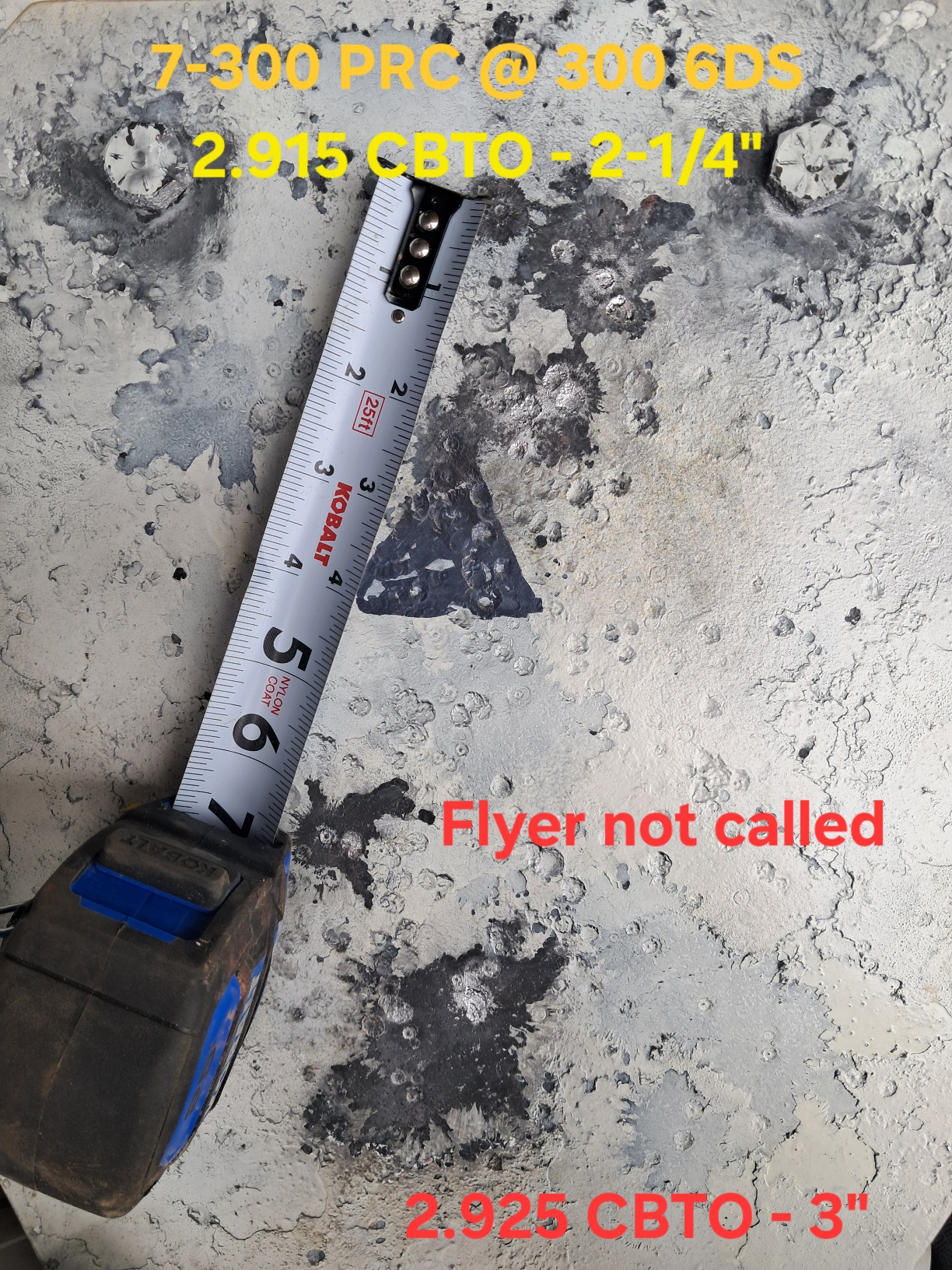

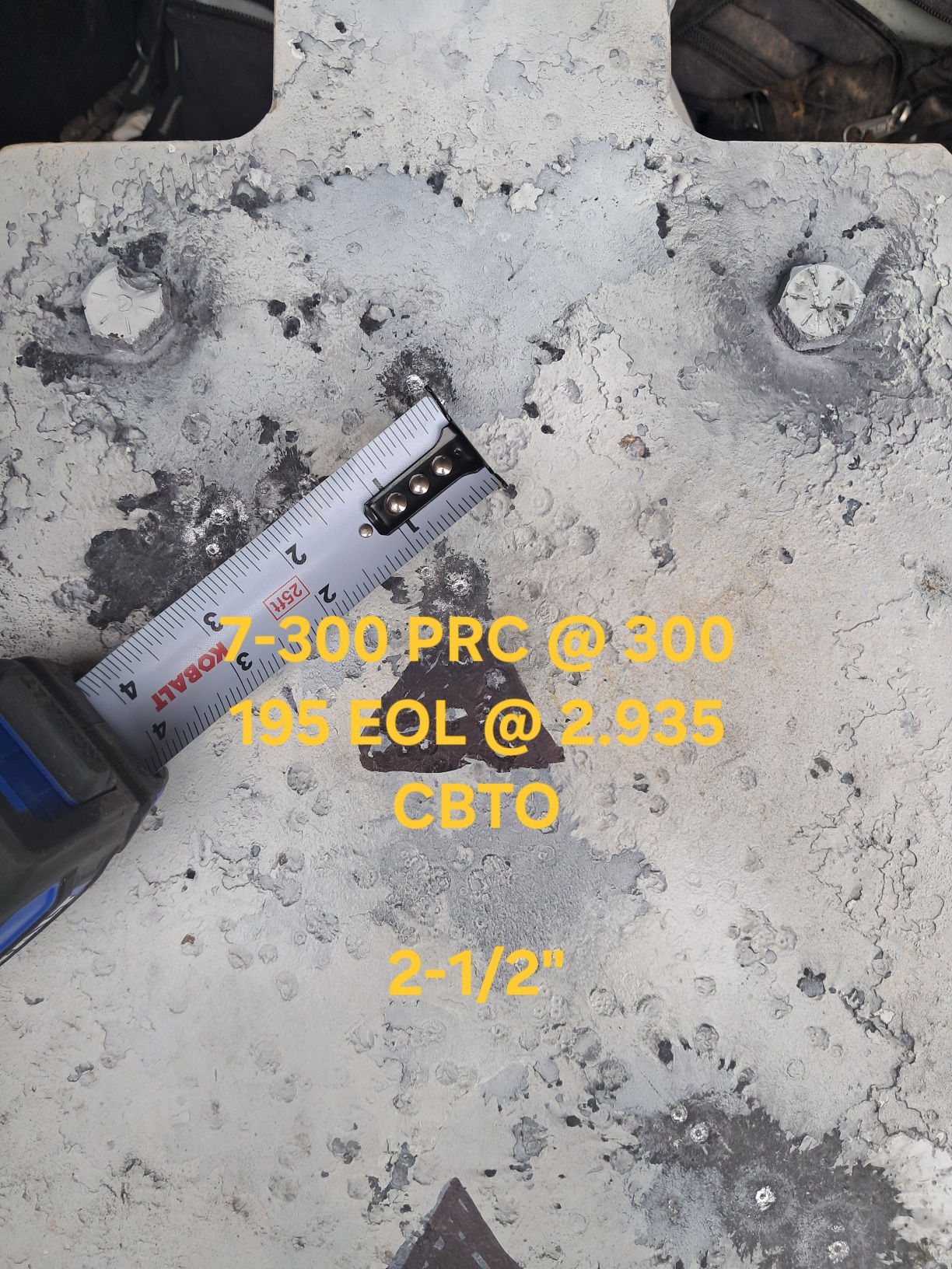

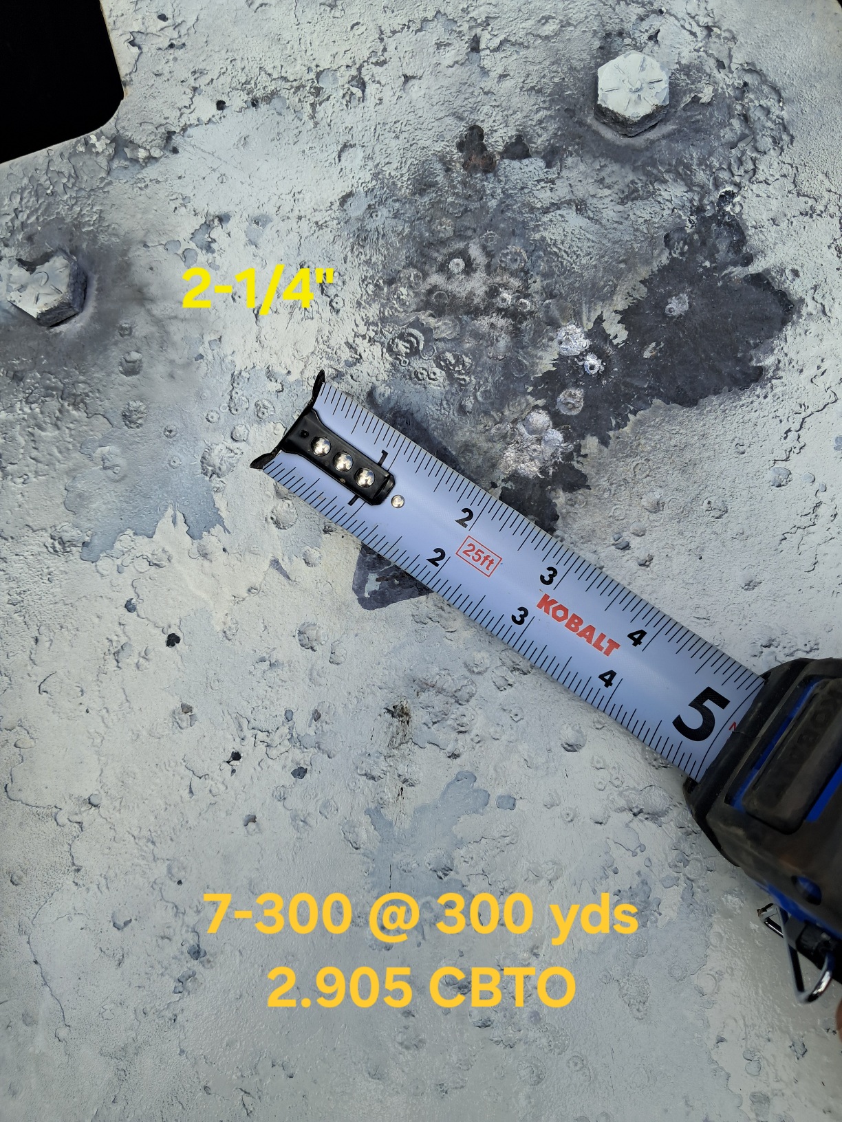

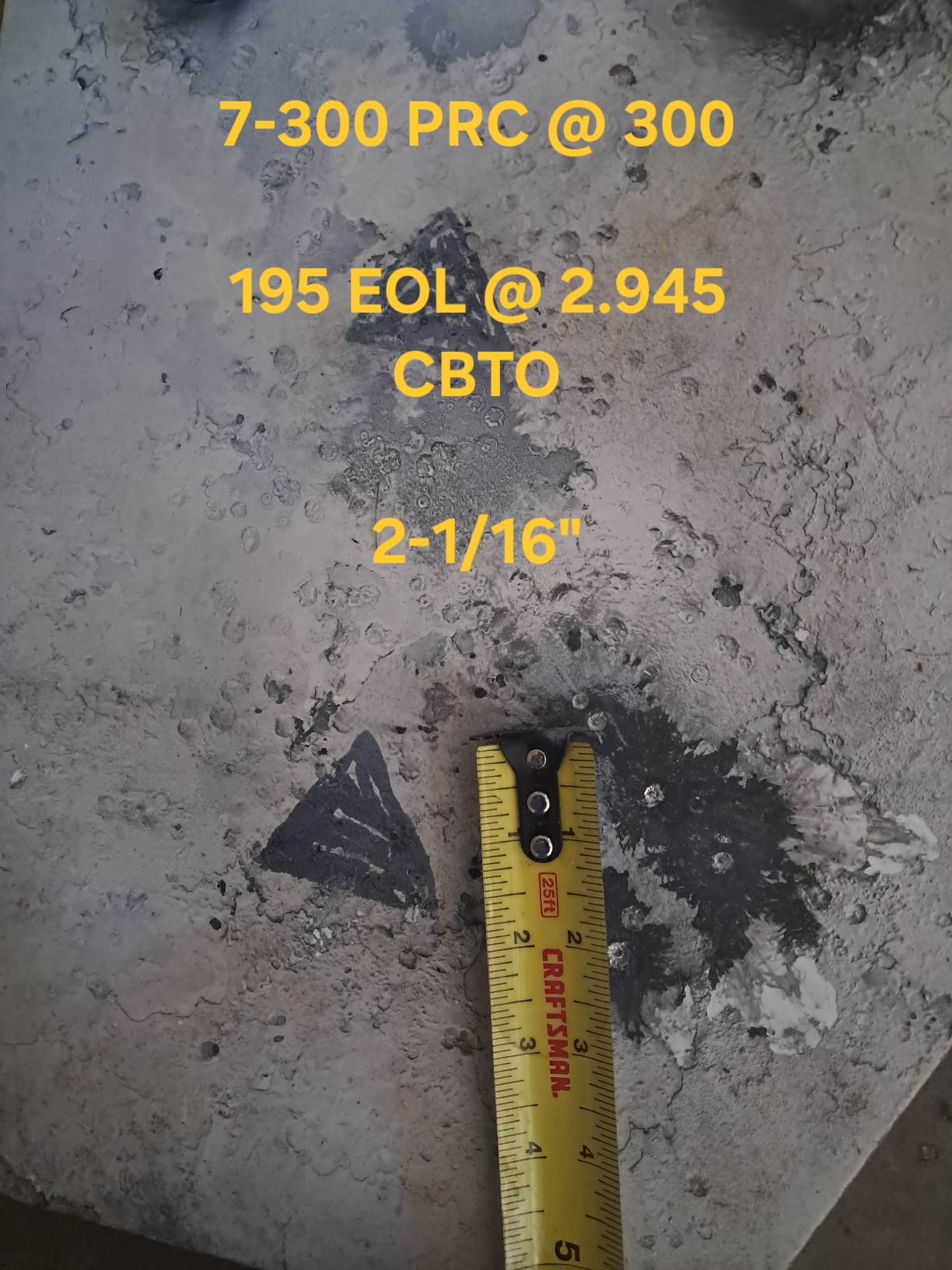

On another day, I then tried seating in and out again in .010 increments, going from .015 - .065 (@ 79.0gr), but did all of that at 300 yards this time on steel (five round groups still). Across that .050 range, every group measured between 2-1/16" and 2-5/8". I did have one group with an uncalled "flier", but it was still only 3" on the nose. I doubt that I could shoot much more consistently if they had been the same length. This barrel/bullet/powder combo might not be lights out, but it has the widest window of consistent accuracy that I've got. I'm surprised. That test took me up to 100 rounds even. I just went with .035 off as it is going to give me at least .030 erosion before I have to (or don't have to) worry about it.

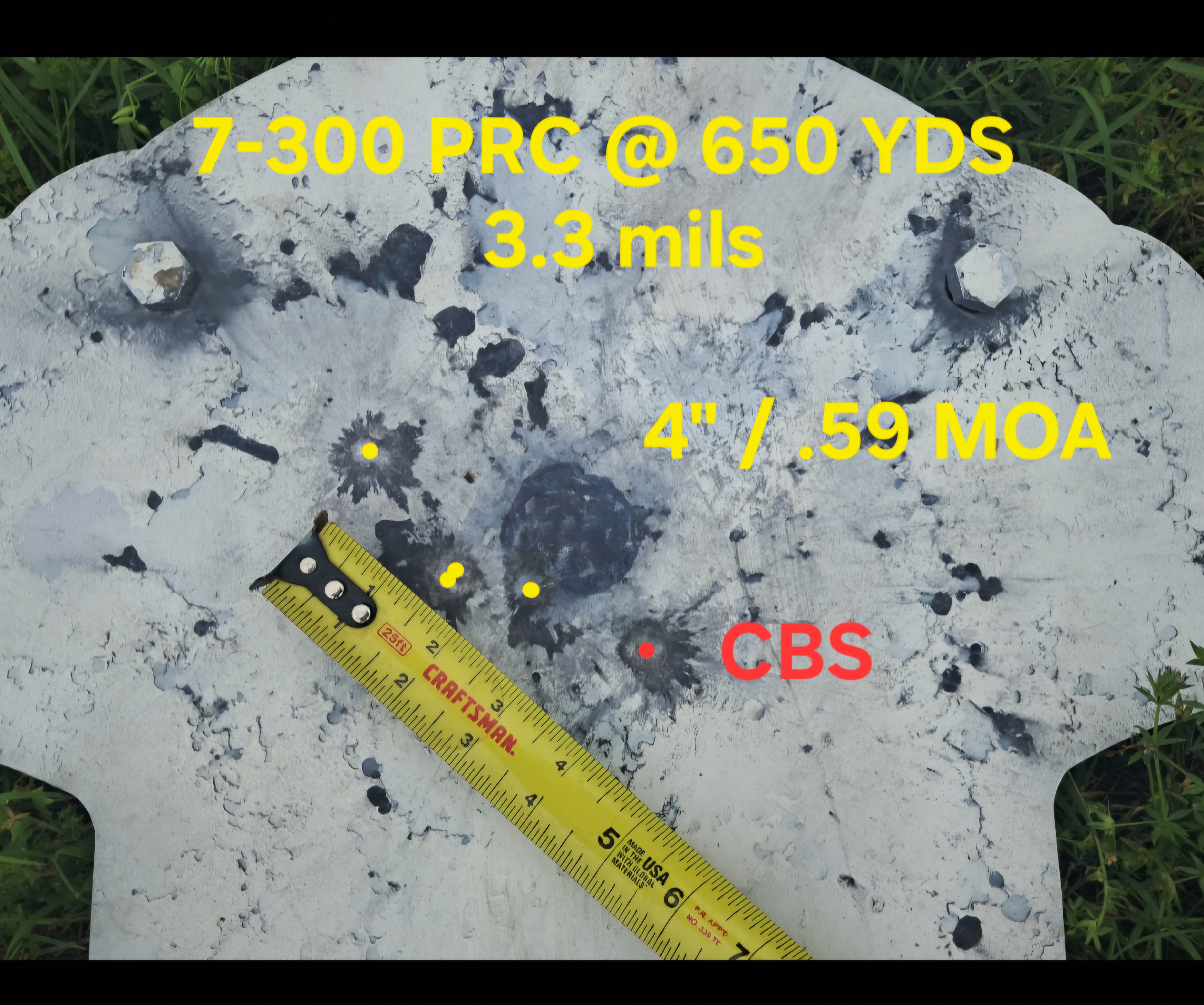

I shot the 79.0gr load again at 650 to verify/true velocity (I use an old chronograph, but it works). It was spot on at 3.3 mils. Accuracy was ~.6 MOA. That is right in line with the 2-1/16 and 2-1/4" @ 300 yards groups I've shot with it.
