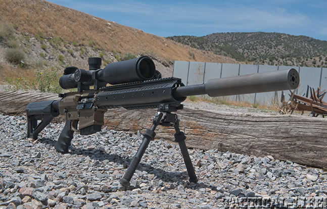

Pic copied off the internet because mine is on back order.
I am new to AR rifles. I didn't know you could get them in 6.5CM until recently so I pulled the trigger. I want to be able to stock up on 1 caliber of ammo so this works great.
Rifle - CA-10 DMR (on backorder through my local gun shop)
law tactical folding folding stock adapter (backorder through brownwells)
Suppressor Nemo Scout - been in jail for 3ish months
Magpul vertical rail mount
Going to stick with my holosun red dot for now
3-30 round magazines
Any suggestions as I am new to this world?
