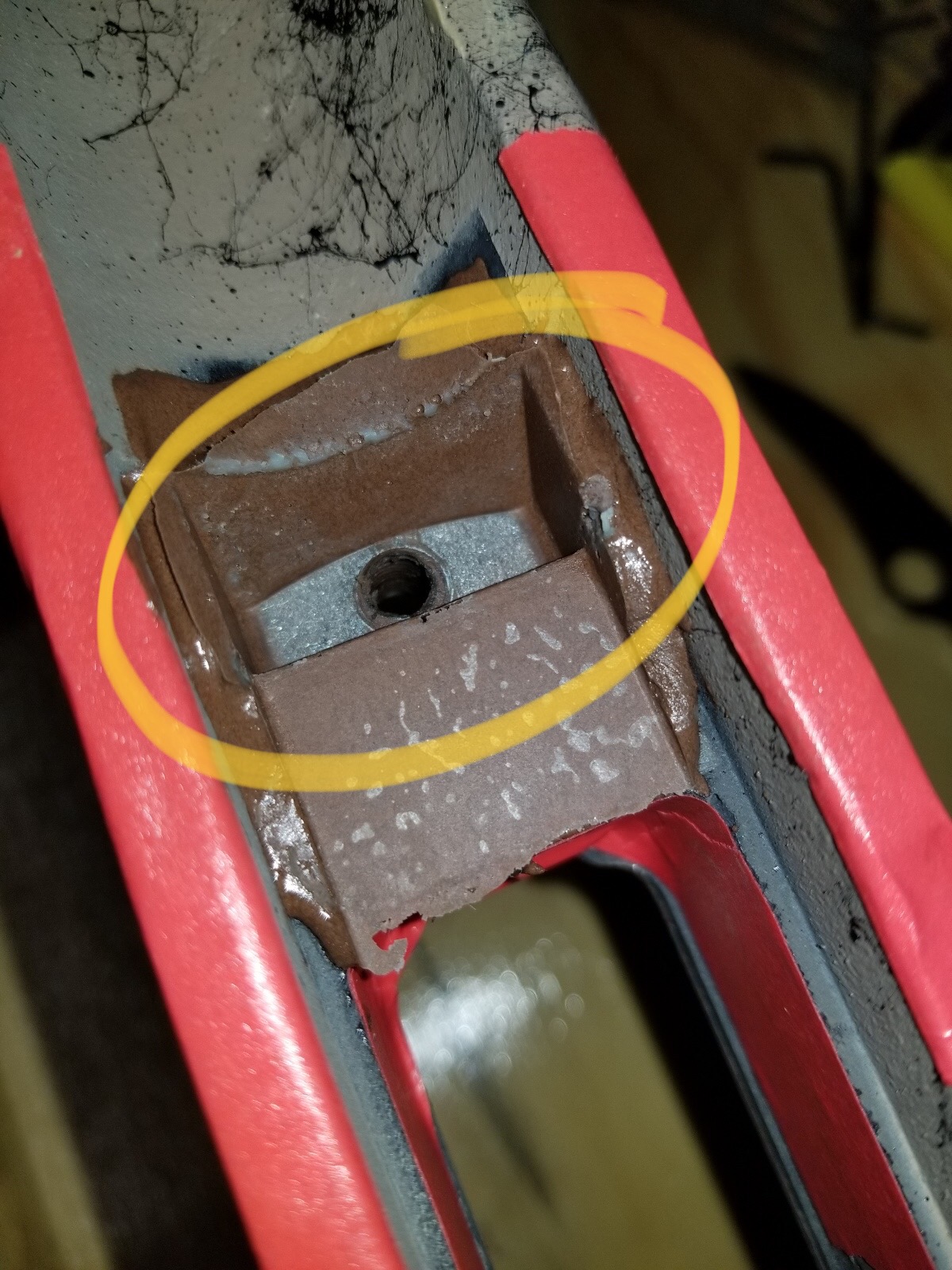

Tape job looks good. just be sure to remove trigger from action so that it doesn't get epoxied. I would also put a bit more tape round the bolt/safe switch inlet.
To preform the putty dam to your barrel (so that barrel/action sit at proper level position), put your action into the stock and tighten the action screws down to normal torque. It will contour the putty barrel dam a bit and keep barrel from "riding high" or nose up when set into the bedding material. Then tape down the barrel channel and forearm edges behind the tape so that you can remove any excess that happens to get forward of the barrel dam. Tape is your friend if you have areas that shouldn't be bedded and are hard to clean up (i.e rough or inaccessible)

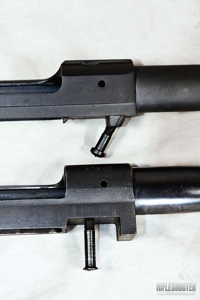

Does your action screw bolt into the the recoil lug?
Yes, Howa 1500 has a very thick, wedge shaped integrated recoil lug (one piece of metal including lug and receiver body) with integral action screw hole. It ensures that stress is applied to the "wedge"; while I'm not an engineer, the lug design keeps recoil movement to absolute minimum and its really chunky compared to some of the stock 700 lugs, meaning very little to no flex during recoil as its one solid assembly.

I see. It is integral to the action.

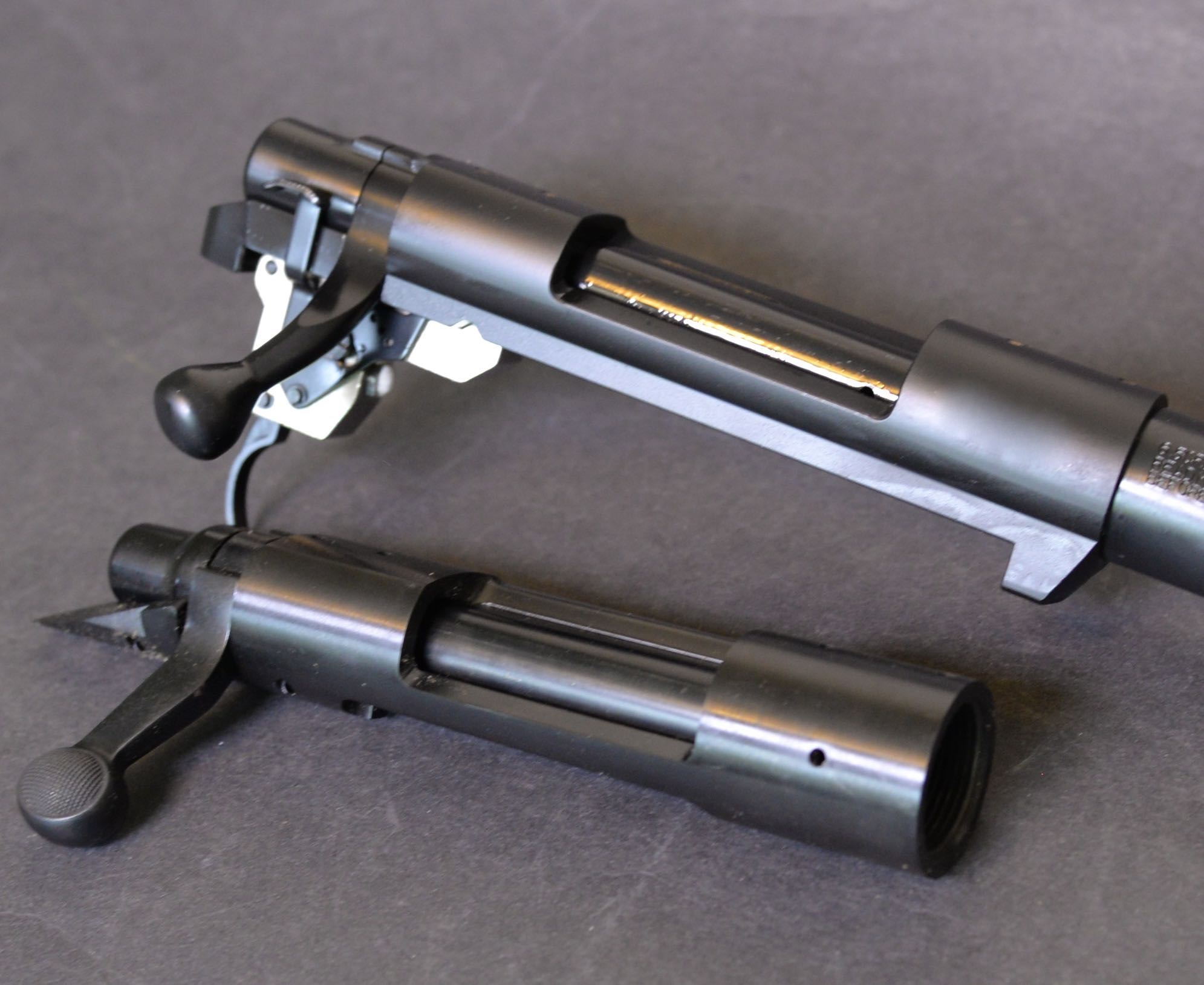

Here is a ruger and a winchester just for a bit more variety. The ruger is easy to just bed but to pillar bed on that angle it a bitch as the bottom metal also has to be installed to make sure the spacing and angles are exactly perfect for a bdl set up to function. The Howa really is the easiest/best configuration imo.
I'm going to put a little more bedding material around the space on the rear tang.
Just to clean it up and fill in the gap?
