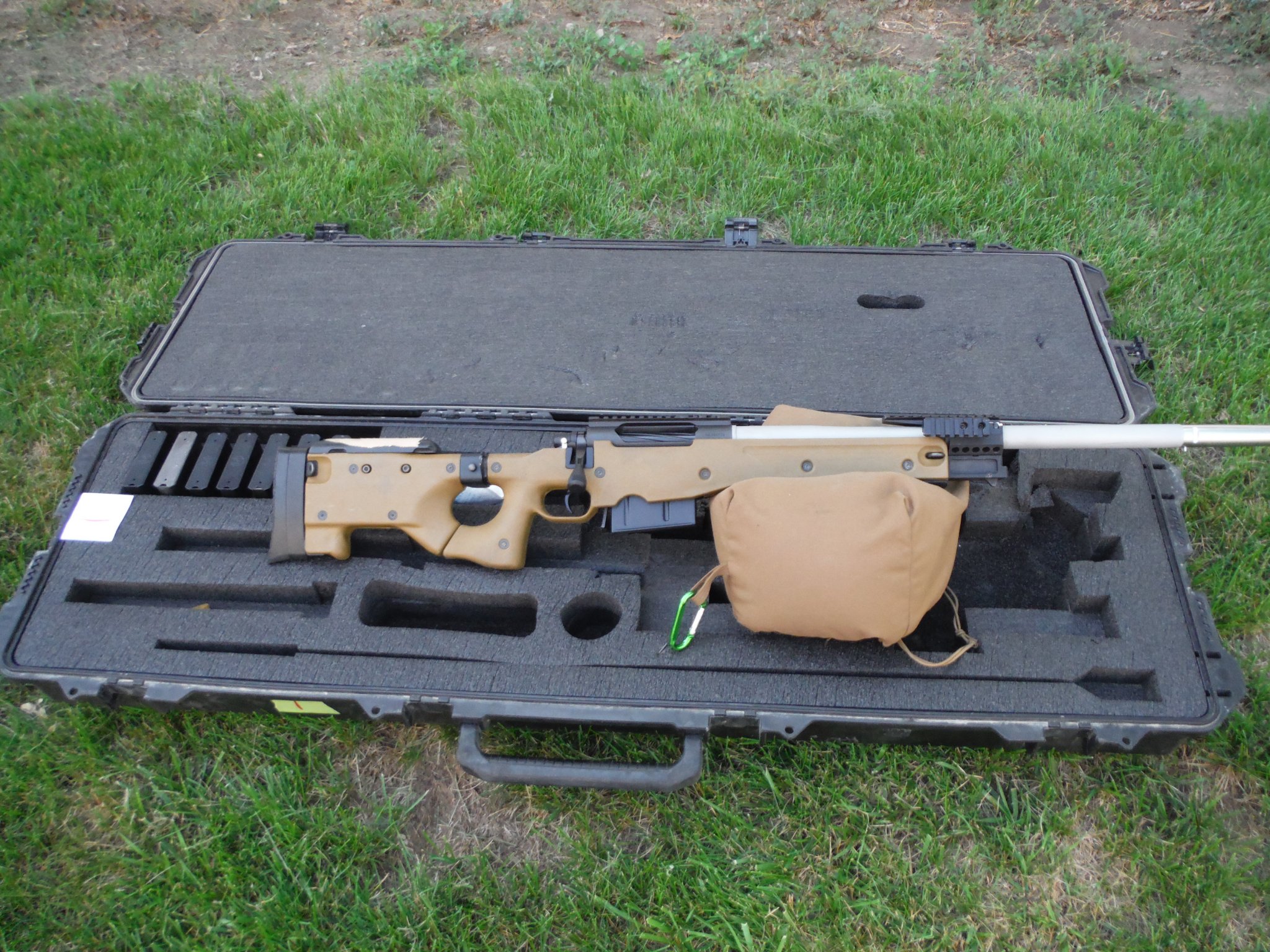

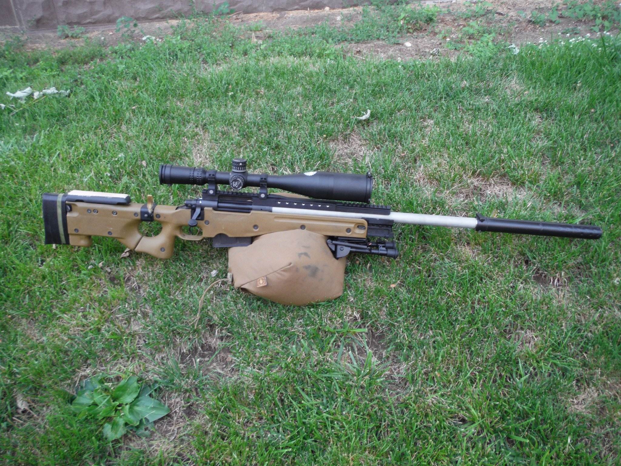

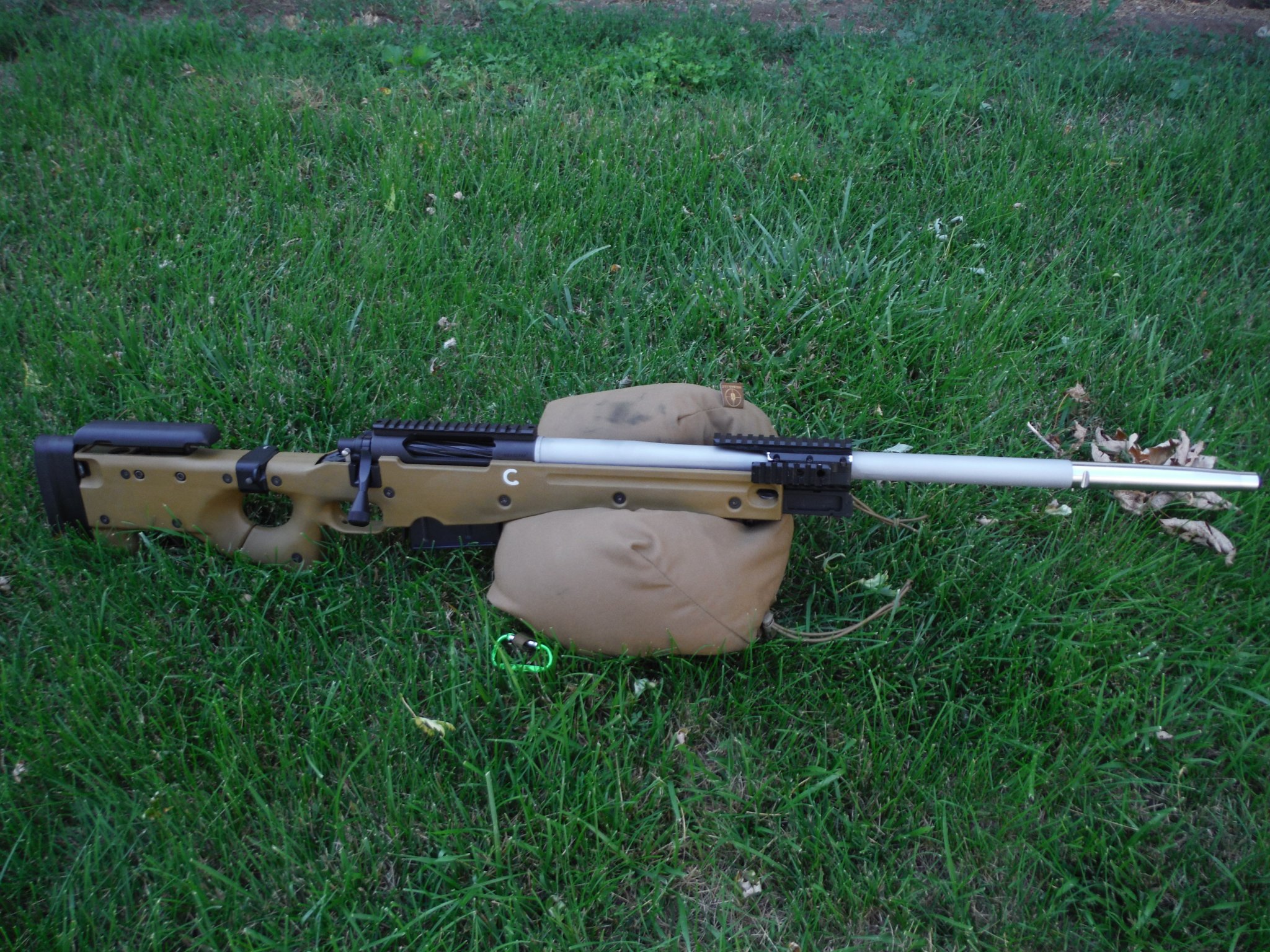

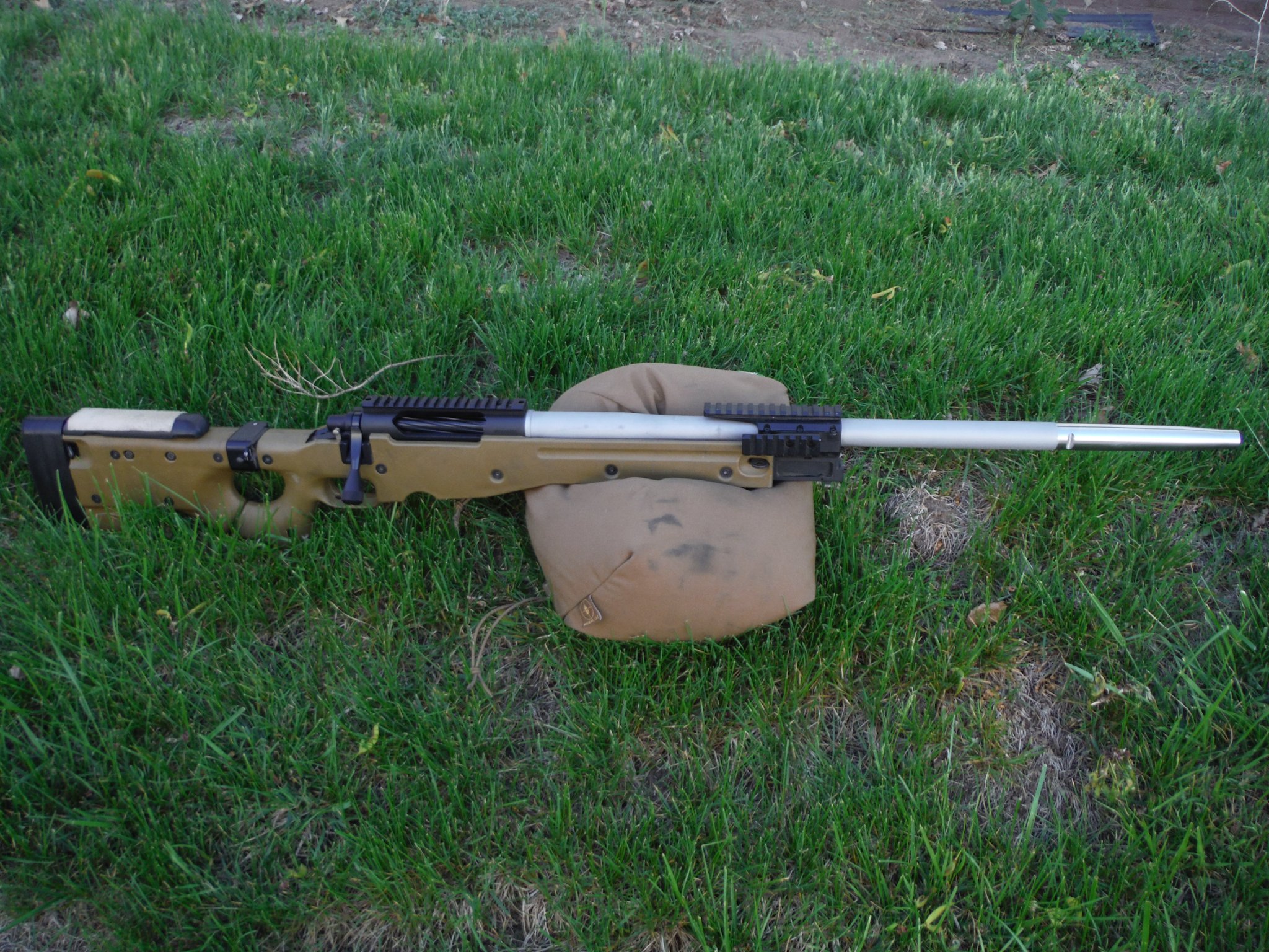

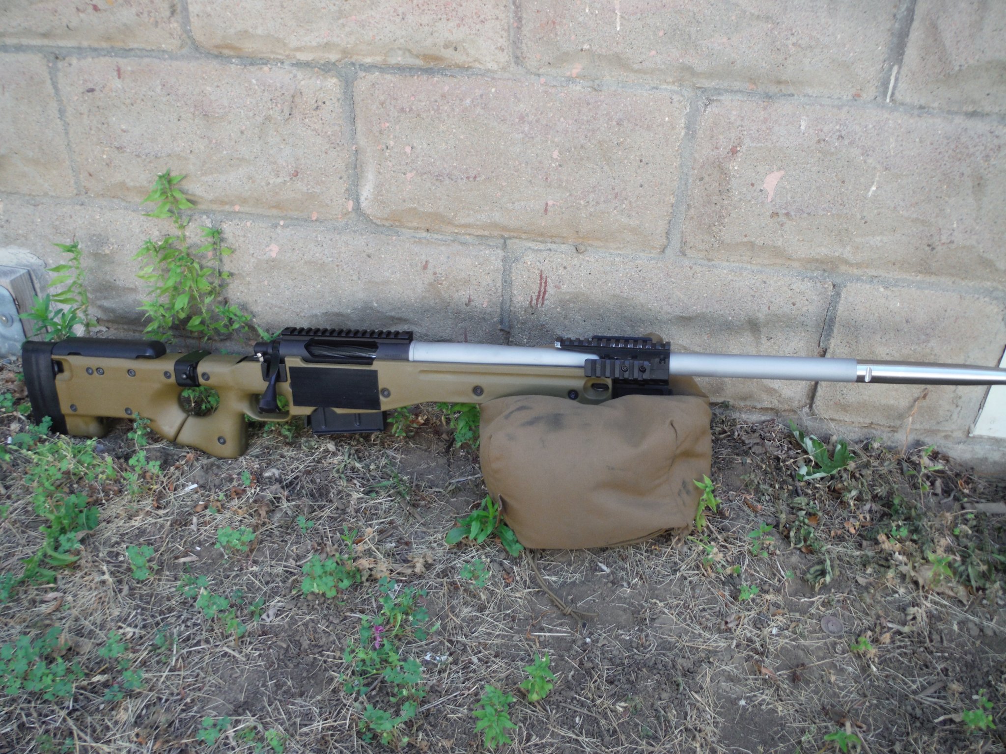

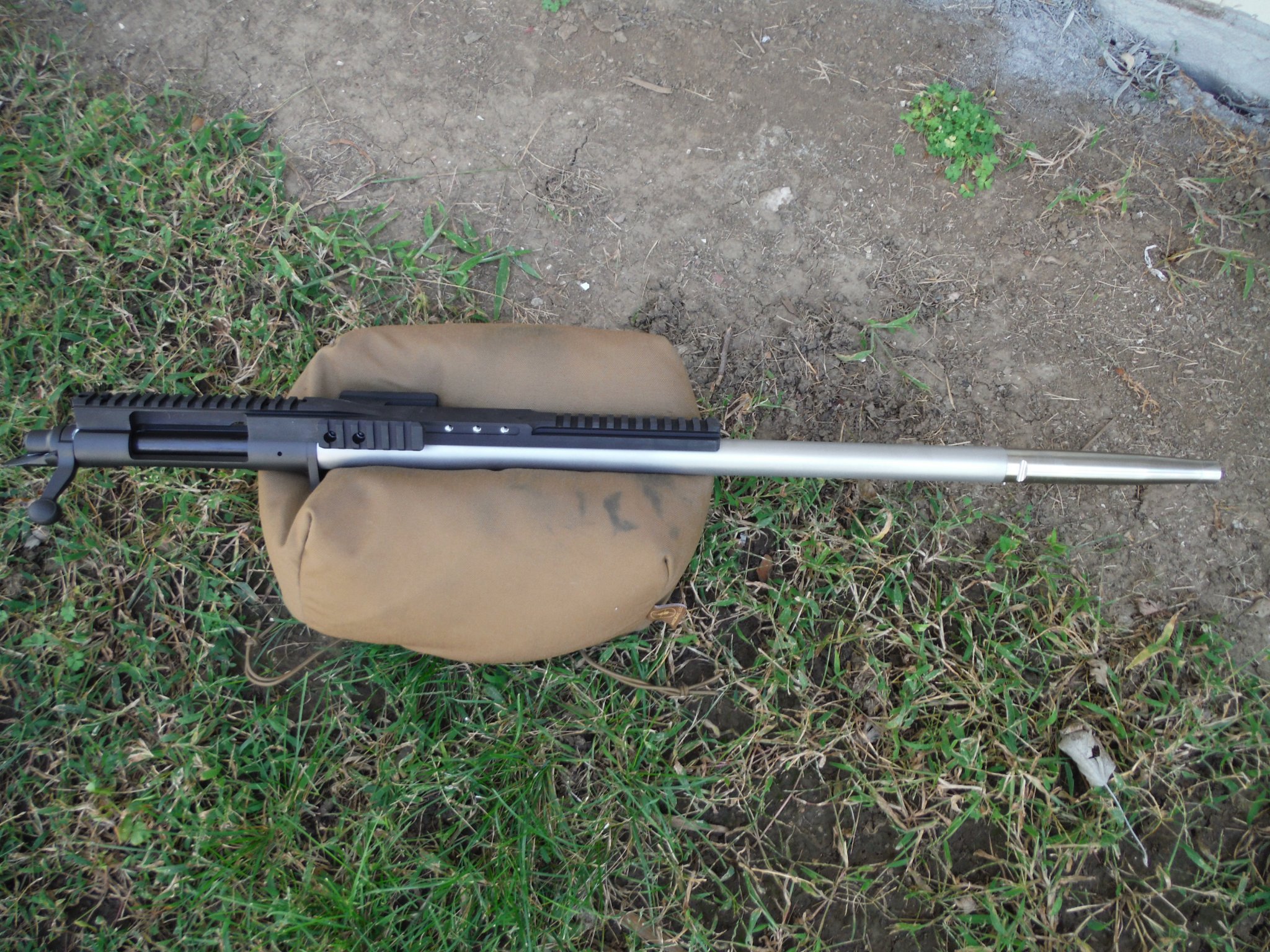

I've done several.

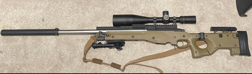

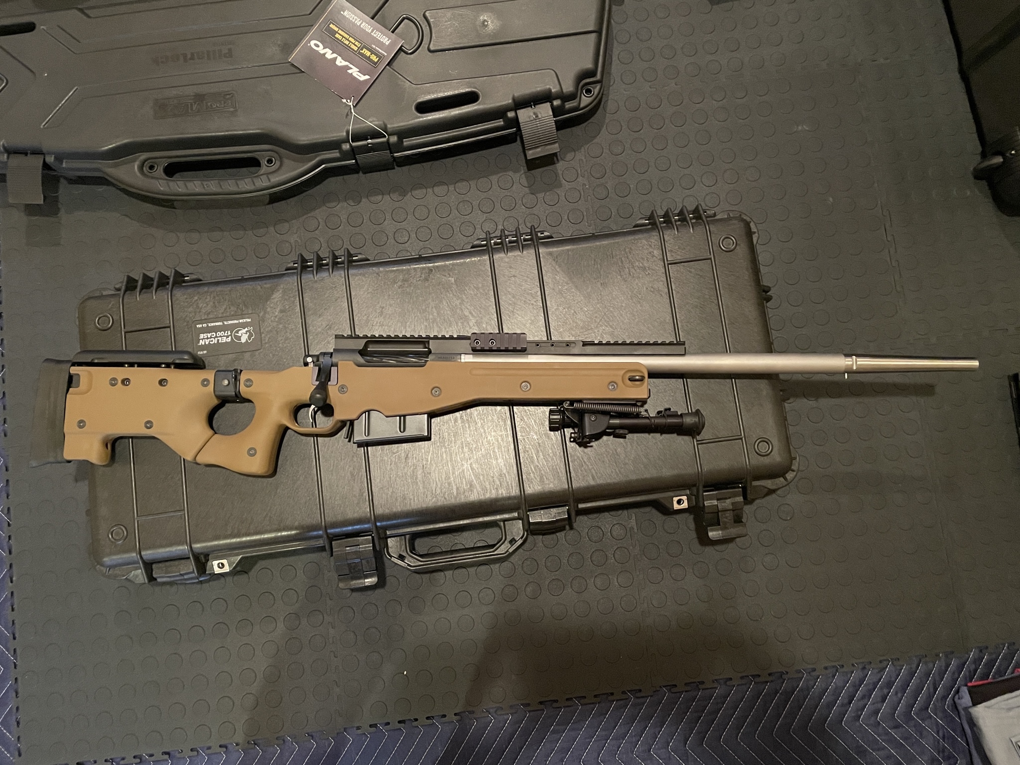

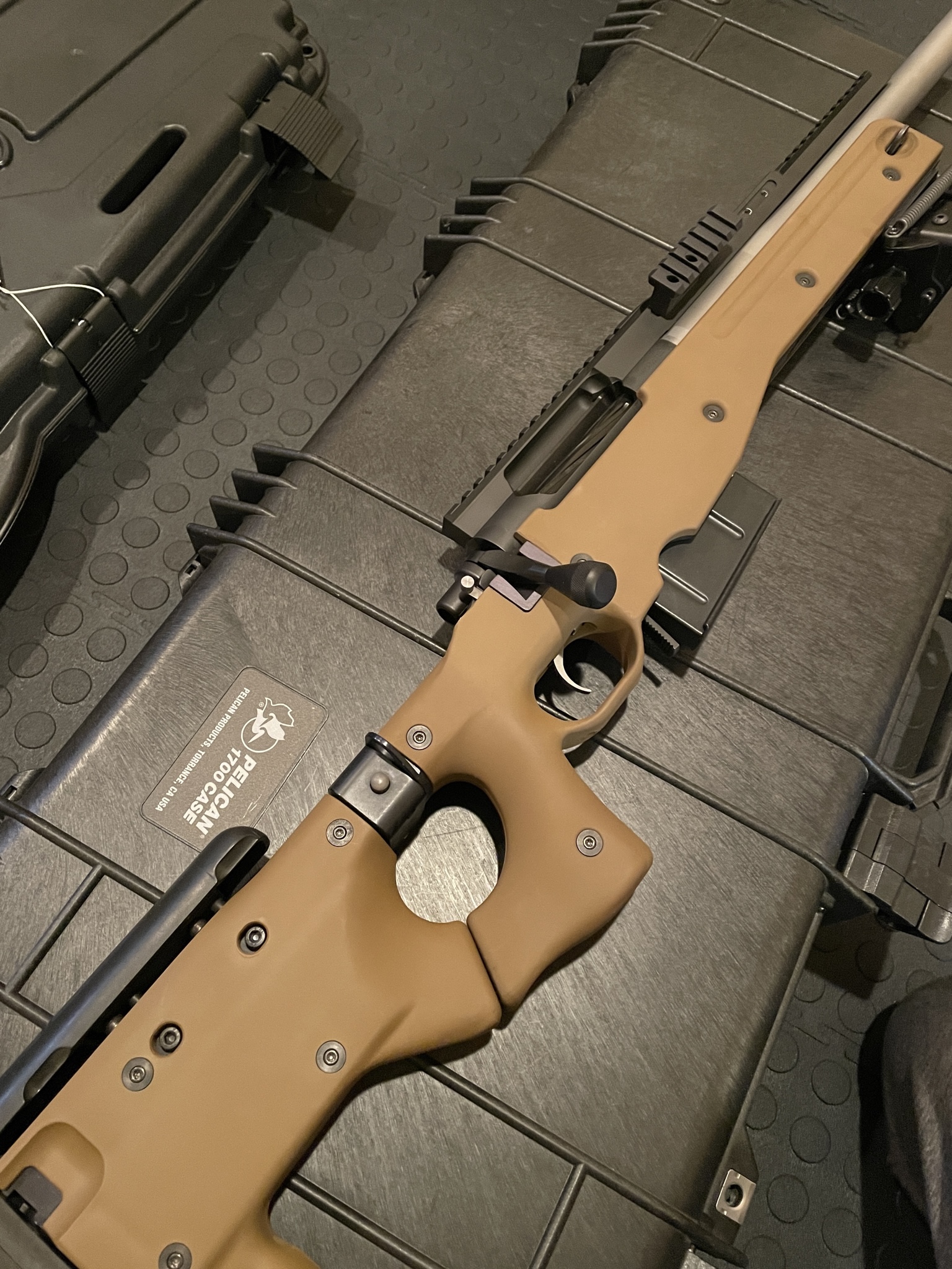

I just received my MK13 from Long Rifles, Inc. Very happy with how it turned out. Just need to get a scope and the elusive MK11 suppressor. Anyone happen to know of one available? I snoozed on it when they were relatively easy to find…
