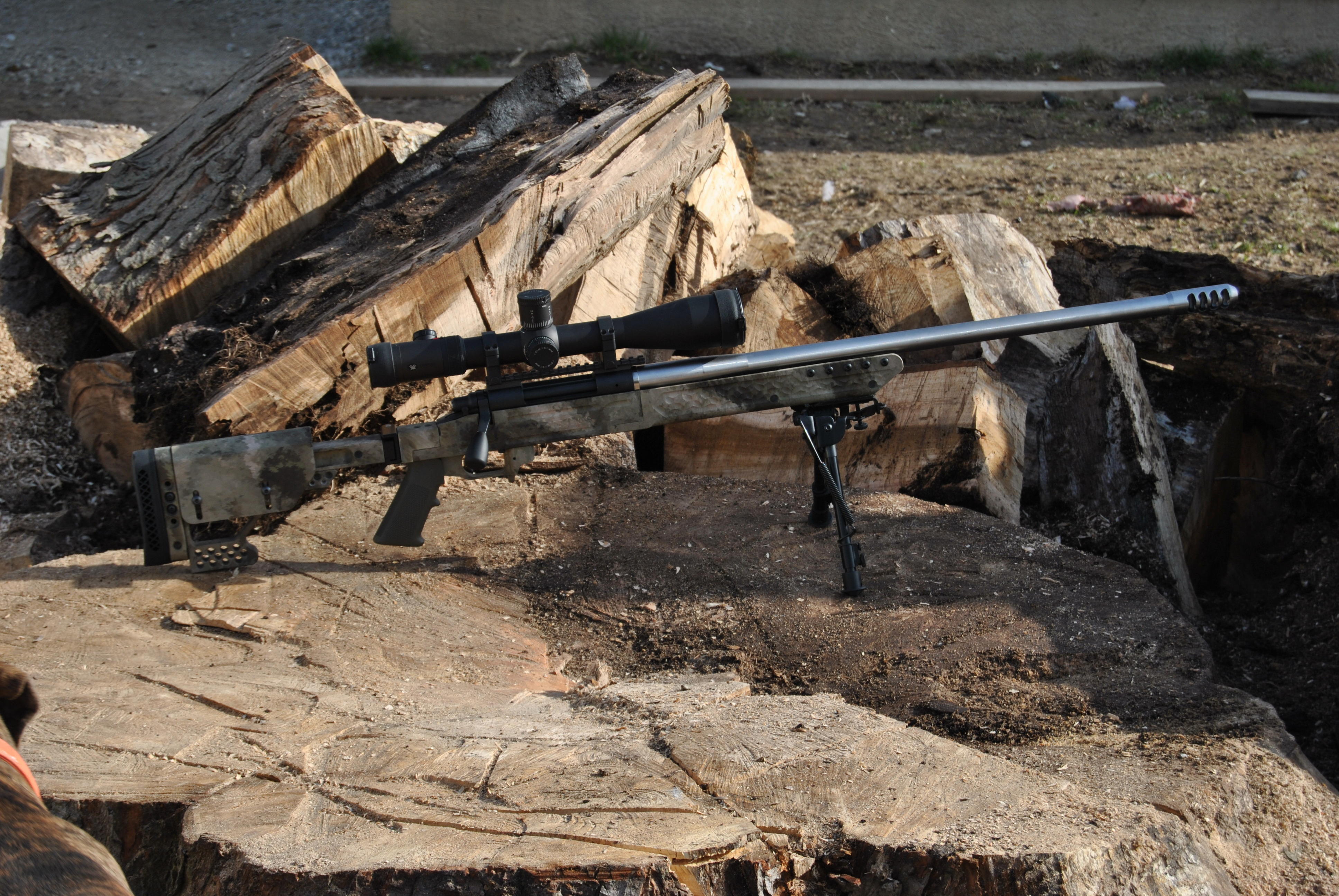

This is my real fist gun that I have put together from scratch. I am real happy how it has turned out so far. Now just need to get some bullets and break her in.
Started with a 700 rem action and 1:10 twist Rock barrel light palma from Russell at scout supply. Had the barrel cut down and threaded and hand a APA fat bastard break installed and chambered up. Went with and old style rem trigger. Mcrees chassis,PRI 20moa scope base,TPS rings Vortex Razor optics. Still need to get the barrel and action coated and add a atlas bipod and a few other odds and ends. Very happy how it has turned out.
