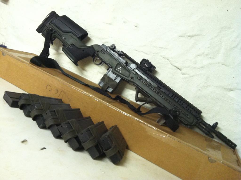

I have a slight M1A obsession and own a few of them from a Socom, a loaded edition, up to a Fulton Armory Peerless. Depending on your budget there are numerous things you can to in order to maximize accuracy out of that platform. One of the largest I recently discovered was using a Sage chasis. My first M1A was a standard loaded edition purchased about 15 yrs ago back when Springfield was still using GI surplus parts on their civilian models. These GI parts were built to much better tolerances than the majority of current production parts unless you pay for top parts. Here is a list of some of the steps to accurize the M1A platform:
One of the first steps you can do is unitize the gas system and replace the current gas plug with a Sadlak piston.
Installing a Sadlak Guide rod the help minimize the recoil spring from kinking and giving a fluid motion.
Use a Smith or Sadlak mount for optics as they are two of the best for locking up and providing a secure mount for a scope.
Replace the current military fiberglass/wood stock with a more rigid platform from McMillan, Sage, Troy, etc... and bed it if needed.
Since it is a DDM rifle for your department, it will most likely only be utilizing optics but if not, replace the rear sight to a hooded match sight along with a match front sight.
One of the better stocks I've found is the Sage Chasis. It completely changes the feeling and control of the weapon from the original stocks will also providing ample amount of rail space for other accessories and/or optic choices. It has it's own front collar so there is no gas system unitization requirement, it locks the barrel and band into the stock with it's own system. Installing this platform on my original loaded M1A it was producing sub moa groups at 100yds; with open sights!
Accurizing the M1A is expensive but by using just the Sage Chasis, a Smith or Sadlak scope mount, and optic you should be able to get the 1moa accuracy that you are striving for. They can be very picky with ammo depending but that is the least of worries. There is also some very good information on the m14forum.com that will provide very good information and recommendations for all variations of the M1A.

That stock might work. I love the authencity of an 'authentic' rifle (woof or EBR) but I need it to work. That stock looks very nice, but I know promag (afaik) is not known for their stocks lol....
It looks like the archangel doesn't accept a bipod attachment? am I seeing that right? or is there a rail at the bottom to attach an Atlas?
delete....
