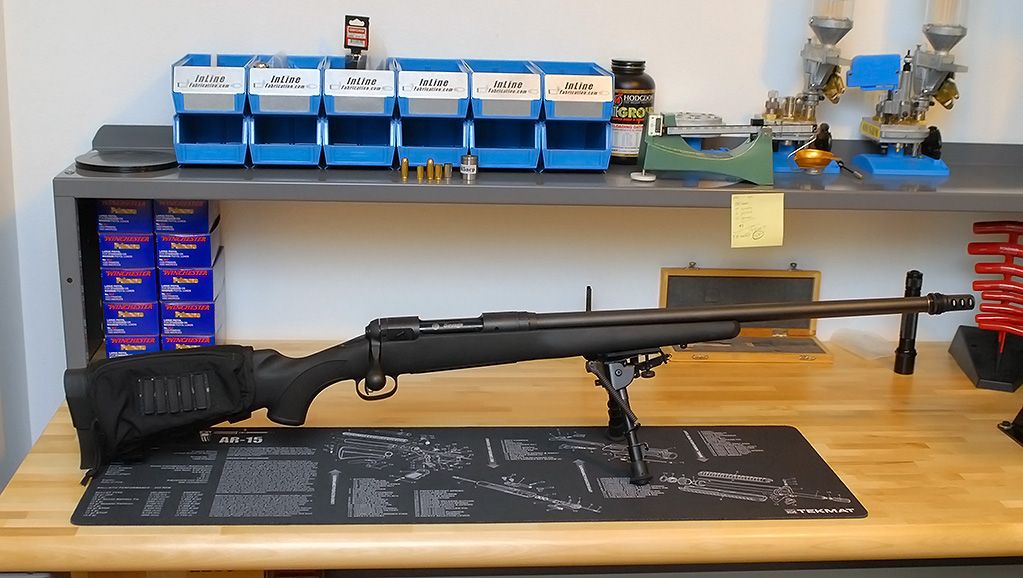

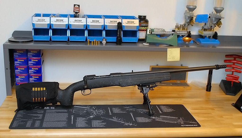

I have decided to do a small rifle build.
I wanted to try Savage for long time and so it started with new Savage 10 FP-SR in .308

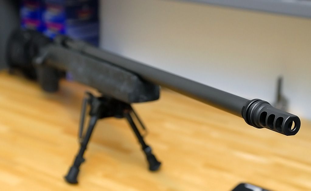

First thing that went on it is SilencerCo Muzzle Brake that came with my SpecWar 762 (Still waiting for it)
OEM stock is a throwaway for sure.
DSC_0206_1154.jpg~original
DSC_0209_1157.jpg~original

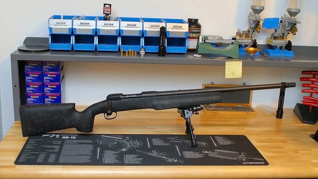

Next Bell & Carlson A2 Medalist stock showed up in Black w/grey spiderwebing
Great fit and finish. Had to shave a little bit inside the stock so Safety can be properly engaged.
DSC_0207_1155.jpg~original
DSC_0208_1156.jpg~original

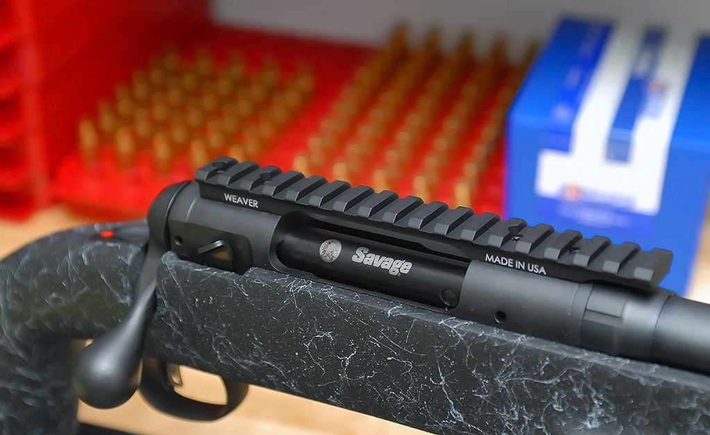

Yesterday Weaver 20MOA rail showed up.
DSC_0210_1158.jpg~original

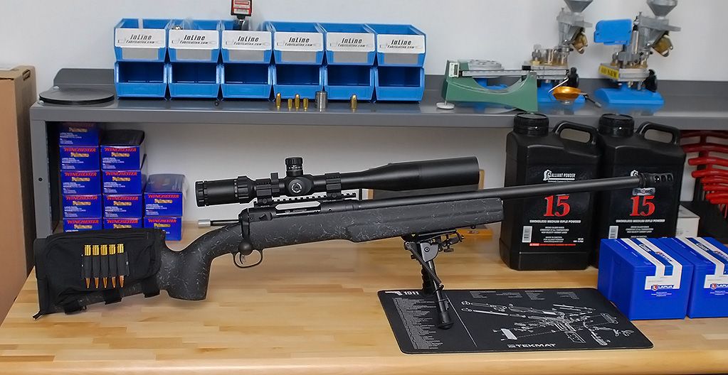

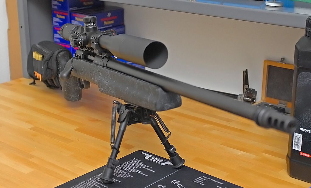

And today I have finished mounting the Scope on Burris XTR low rings and bubble level.
DSC_0212_1160.jpg~original
DSC_0214_1162.jpg~original

I dont know how it shoots yet =) Just finished it today.
I have a feeling it will shoot well. It has a very tight/short throat and bullets can be seated pretty close to lands and still be mag length.
