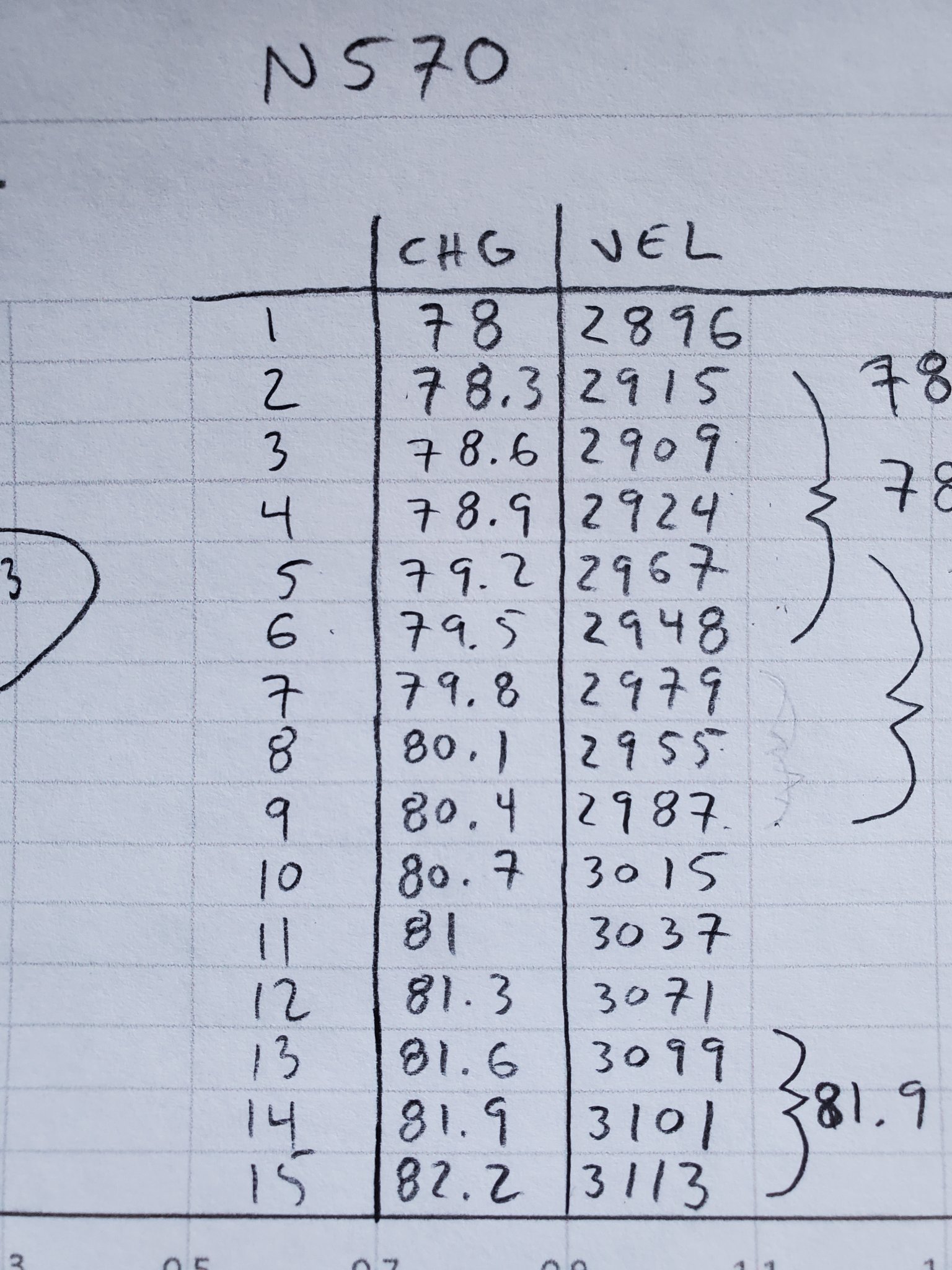

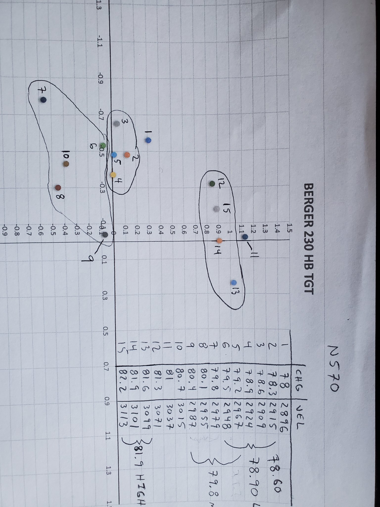

I know there's a 28 page thread on the 300 PRC but I'm done trying to wade through it...
Looking for data and velocity with 225's, 215's, and 230's using N570 and RL26 in a 300 prc.
I'll be using a 27" 9 twist barrel.
31" Tube 1:8
N570
35°F
2300'
70% hum
230 Bergers

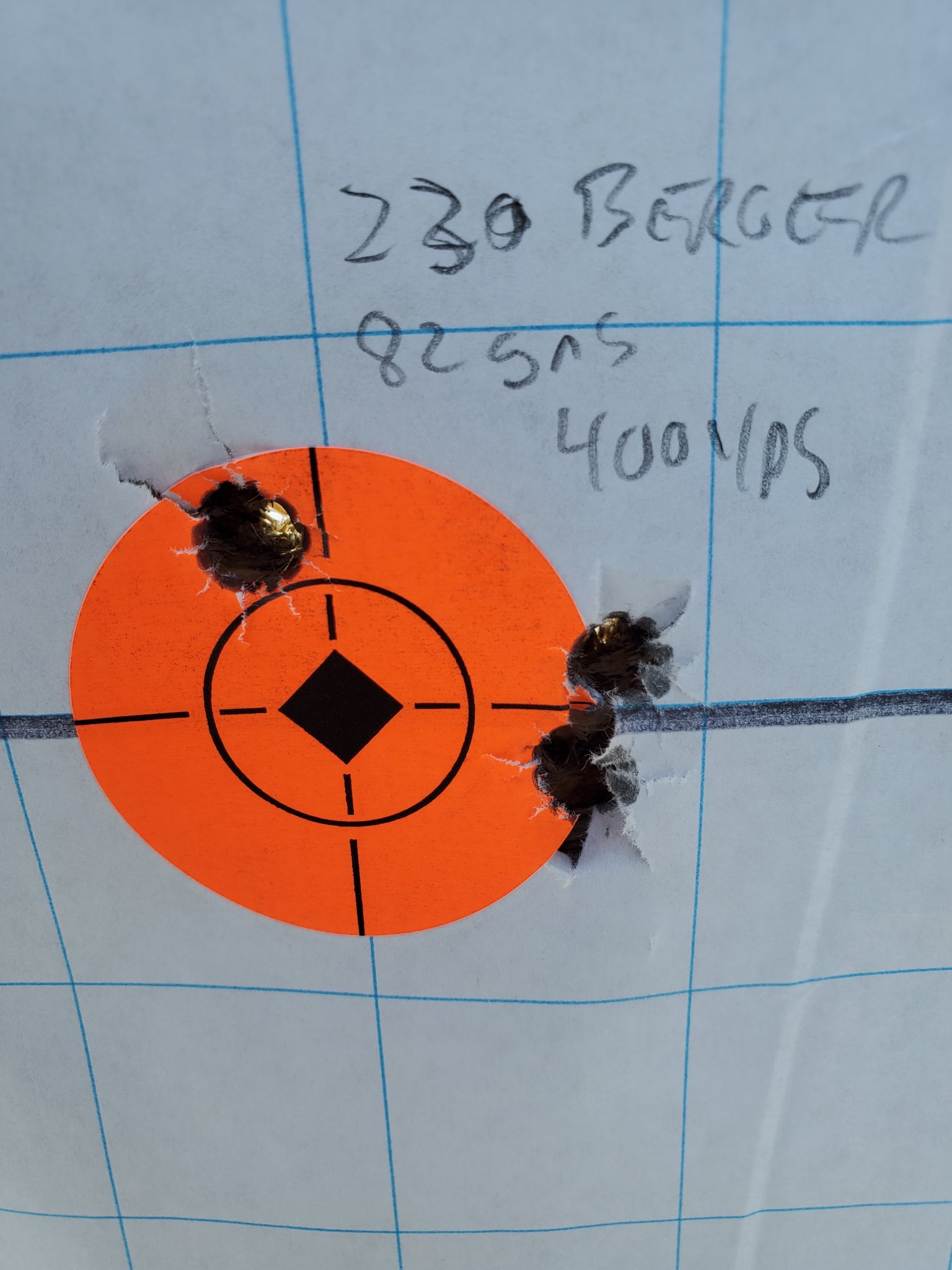

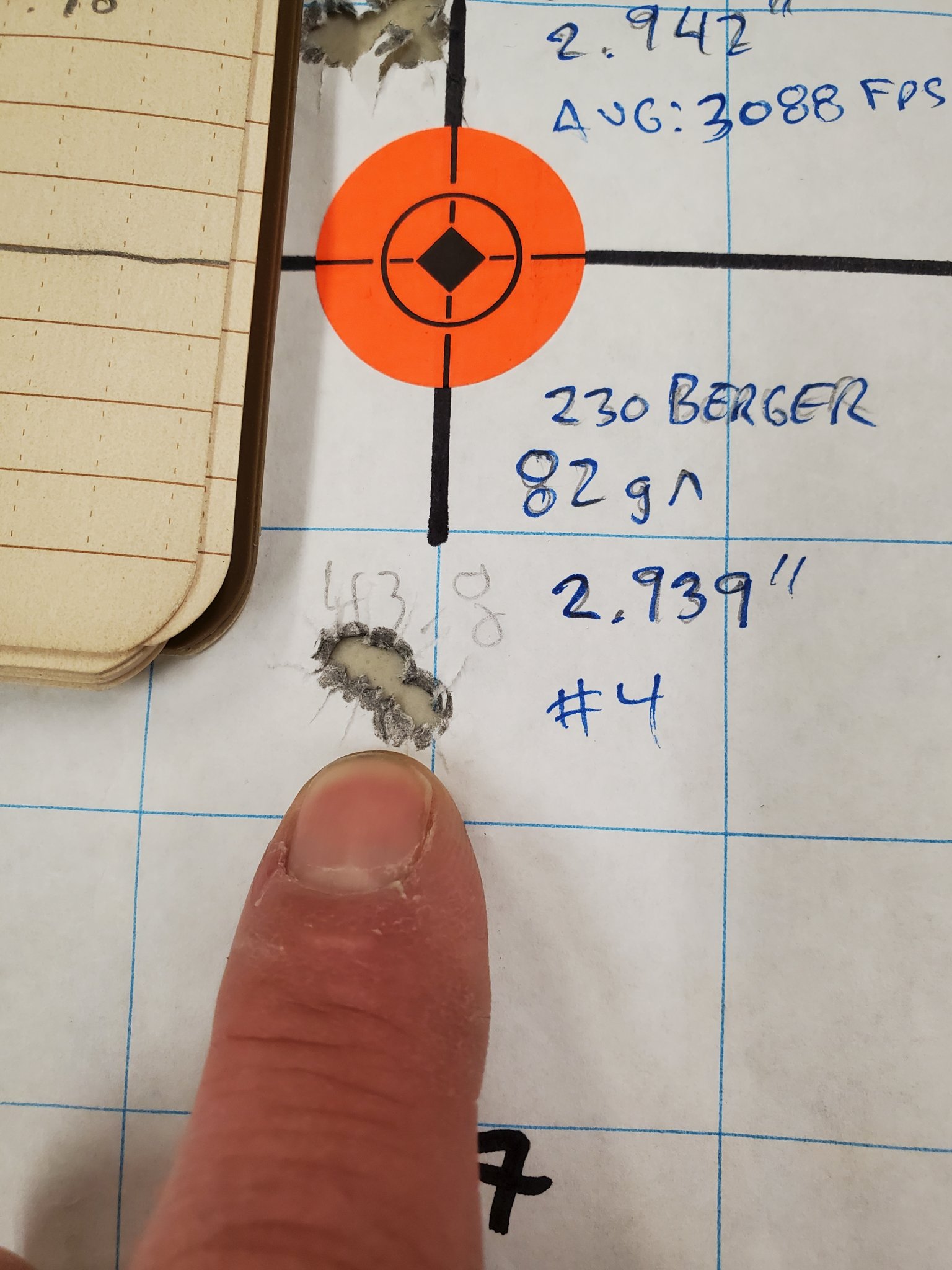

I'm running .019" from the lands. Barrel has only seen 100 rounds. Carries 1/2 moa or better out to 875yds so far. Trying to get out to 1000yds tomorrow if I can sneak it in.
I noticed in my load development that whenever I do a ladder that close to the lands it produces the same erratic results. Move the bullet .050-.075” off the lands and the curve is much smoother.
Thank you for your reply, I will try that! Been running the 3100fps load and it's holding less than 1/2 moa. I will do another ladder.
