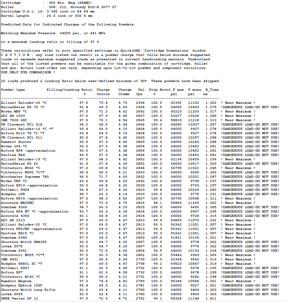

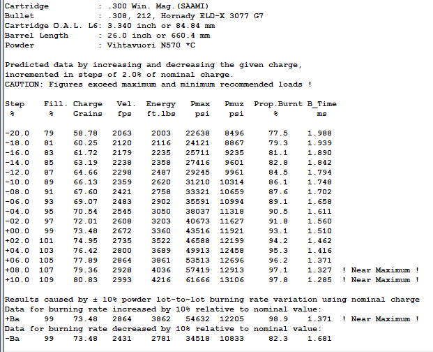

Found some n570. All I could get, I can't find h1000 to save my life. Anyways, I am gonna work up a load with some hornady 212s. Having a hard time finding anything with loading data. Does anyone have any info on starting and max loads for this combo?
You can derive some ballpark info here:
Bottom line: N570 is going to be a bit too slow for that cartridge. It's ideal in .300NM & .338LM

I am more curious now. If it will work up a good load. I am going this morning. Gonna caution on the low side when picking charges. My frustration is some post I read on a bunch of forums. Guys are saying the can fit 80+ grains and a 210 berger in a 300 wm case. Drop tube or not seems that that must be a very compressed load. I was messing around in the man cave with a case, powder and 212 eldx. I am not sure I can get anything near 80 guns in a case. More like 77 tops. But I will let you know want I find out.
