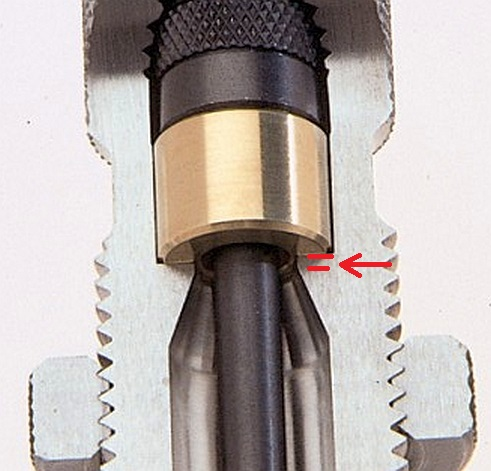

New to forum, thanks for having me. Can doughnuts in the neck be avoided or minimized with proper annealing, keeping the case length at proper length, or use non-bushing dies? I have a 22-250 rem (no special chamber dimensions) and I use Redding Type S dies. Let me know if any other info is needed.
Thanks
Joe
Pretty normal for bushing dies but you can use an expander mandrel die, FL sizing die with expander ball, necking turn, or ream the inside of the neck to get rid of the donut.
If you want to keep the Type S die, you can run an expander mandrel die (with proper size mandrel) from every few loadings or every loading.

It makes sense to me to FL size cause there is no “gap” between a bushing and the case shoulder to cause the doughnut. It also makes more sense to me to create the neck tension from expanding the inside diameter of the neck than “squeezing” the neck to get tension.

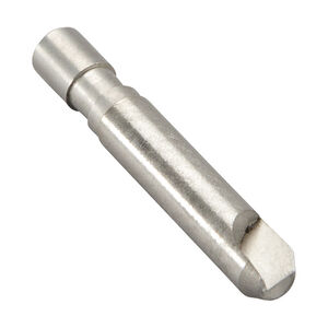

Thanks for all the help. I bought the K&M neck tension mandrel with .0025” tension, I am loading up hunting cartridges and that seems to be a nice compromise of tension. I am running Berger VLD’s just touching the lands, so I can’t seat the bullet out any further. I guess I’ll just try to minimize the formation and ream them out when they form. Any suggestions on doughnut removal. I am looking at K&M carbide cutter pilots. Anyone use these and if so can they be used every time I trim necks or should I move to a regular pilot? I also have a L.E. Wilson case trimmer, so I can get the reamer for it too
I would call or email K&M and ask them how to use the carbide cutter pilots.
According to K&M
"this tool will remove the excess material without affecting the inside neck diameter"
It may be similar to a method I sometimes use where I expand the case neck using a mandrel (that I have modified) to the exact size of the reamer and cut the doughnut with the RCBS tool. It works OK but not great.
