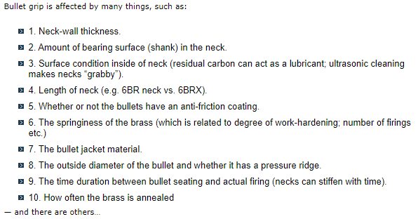

spife7980 Luchador Full Member Minuteman Feb 10, 2017 14,018 17,401 Central TX Dec 16, 2020 #2 Dec 16, 2020 #2 Generally yes, within certain parameters. But also no within certain parameters. You are being redirected... Powder charge is going to be the main driver of velocity. The others are small percentages. Last edited: Dec 16, 2020
