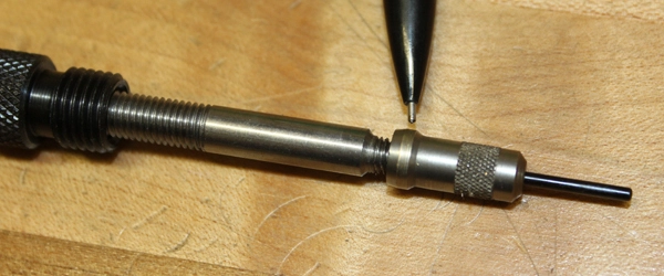

    None of the traditional expander mandrels (sinclair, 21st century style and k&m is even more different) go into a bushing sizing die. They have their own dedicated die body.
    Traditional expander die body with expander mandrels/arbors, zero bushings. These do not fit into a bushing sizing die. A bushing does not fit into this die body. These are what most people are referring to when they discuss expander mandrels.

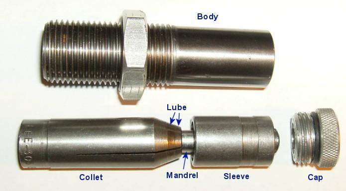

    Lee collet die, its "bushing" is a collet with fingers that get squeeze smaller around the central mandrel as it bottoms out. The traditional mandrels shown right above do not fit this die.
    7072975
    The typical mandrel that gets discussed here is not the same thing as the lee mandrel.

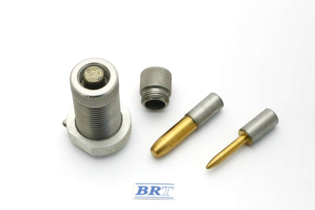

    Expander ball can be installed inside of a bushing die as you said but it is not a mandrel.
    7072979

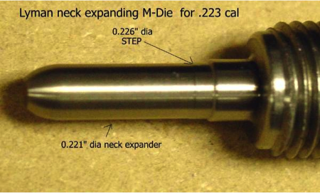

    You could remove this expander ball sizing down and then you would use the traditional expander mandrel in its own die in its own second step (or the lee collet but they are independent things). The mandrel does not go in into sizer die.
    The only thing I can think of thats even remotely similar to wat you are describing is the lyman M die but Ive never actually seen someone use one of them for precision reloading. More for bulk ammo creation where you want the top bit wider for progressive bullet feeding followed by a crimp.
    7072988

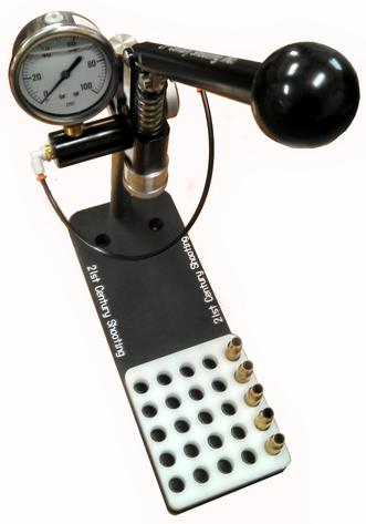

    Wondering at what actual pressure it takes to move the bullet. Is there a neck tension guage? I suppose with the right scale one could simply push down until it moves.
    Thats tough to measure with an actual number, bullet pull is the term for it. To do so you need a guage set up to whatever press you are using to pull them with. Much easier is to measure them going in instead of coming out and to do that you get a hydro arbor press from 21st or k&m which will allow you to measure the seating force.
    http://www.xxicsi.com/hydro-bullet-seater.html
    7073121
    Well damn, that's crazy. I can imagine someone's reloading bench looks like a laboratory with all these gadgets.
