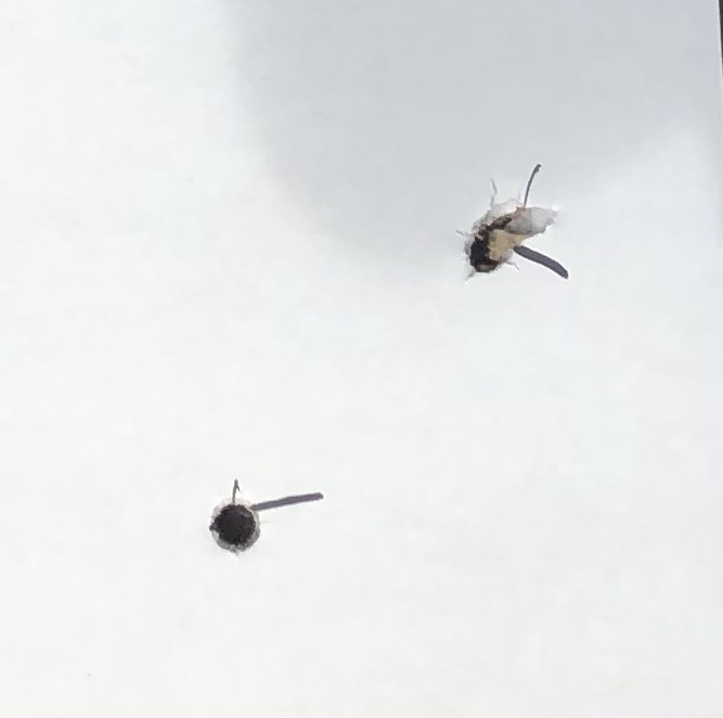

The bottom left shot is fine. The top right one is a keyhole. Probably for lack of velocity to stabilize the round. I had that happen to me with a new 1911 Officers model (the shortest barrel) using good 230grain ammo. The ammo/barre length combo would not stabilize all of the bullets. Went to 185 grain rounds and the problem was solved.
A Glock 23 has plenty of barrel length and you are using the lighter faster round so I'd look at the ammo first.

Thanks I. Advance for your time and input.
I have a Glock 23. Probably approaching 1000 rounds. Factory barrel.
The rounds are “yawing” intermittently at 25 yards.
Not sure what to make of it.
Do I need a new barrel??
Thanks
With a 23, it's not the barrel you need to worry about. Since Glock basically built a a 40SW around a 9mm, it will have other issues if you try to push the pressure limit on it. I've never seen one crack a barrel or slide, but trigger pins, frame rails, locking blocks all will fail in guns that shoot reloaded ammo where the owner tried to get "just a bit more" out of it. I have one 23 that shoots really well that I bought new and has quite a few rounds through it. I also once acquired another one cheap that was damaged from shooting factory overloads from Buffalo Bore, etc. Just stay away from the hot rod loads in it. If you are shooting factory target ammo, you might be shooting something it doesn't like. Try another round. 180 gr target or standard velocity rounds shot the best out of my two guns.
